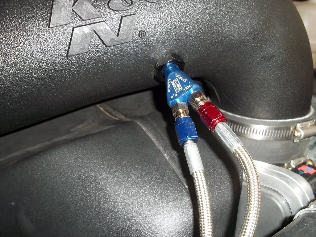

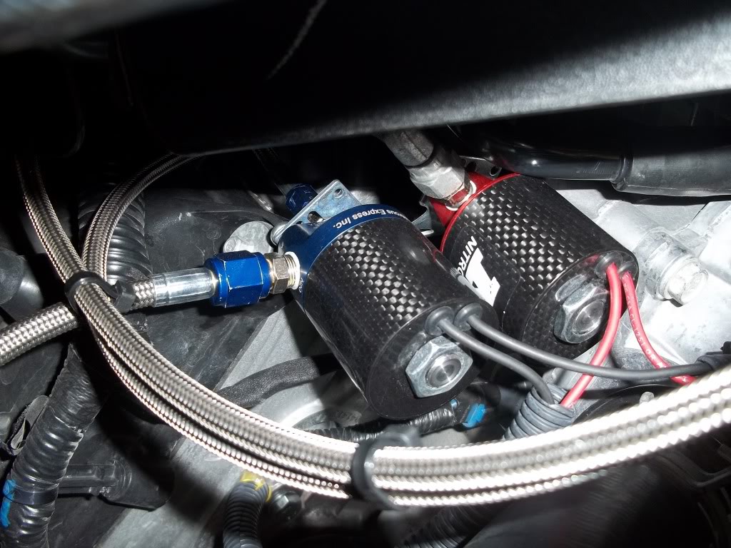

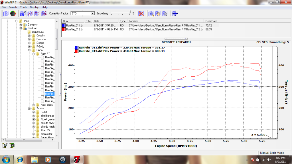

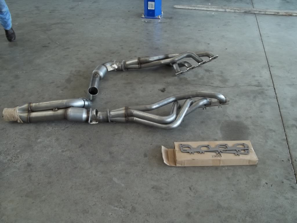

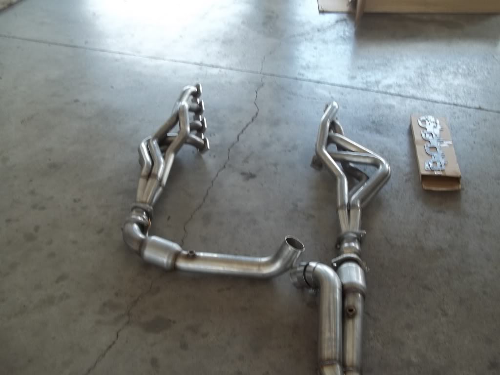

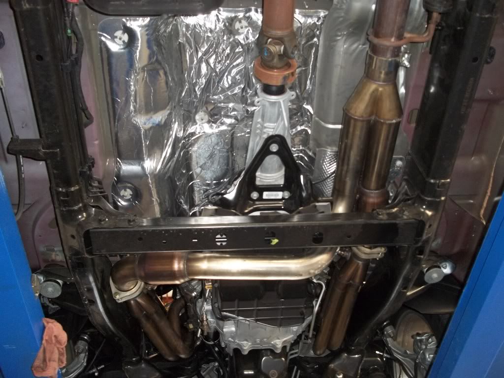

Default Update
well, the headers and mid pipe came in...still waiting on the borla exhaust to arrive though...
i also went ahead and added a nx nitrous kit pilled at 100 in the meantime, and the results are
329hp / 331tq...on motor with headers and catted mid pipe
410hp / 403tq...on spray
rev limiter comes rather quick on spray...lol
on motor the A/F was 10.5-10.8
on spray...11.0-11.2
