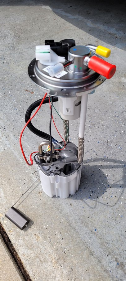

I've been doing a lot of my own tuning and have been wanting to get shift RPM up, but have been limited by the factory flex fuel pump even with voltage tweaks and large injectors. I can get to about 5k before the pressure falls and about 6200 to 6500 before it gets leaner than I am comfortable. So I took notes on someone else's 450 pump install and tackled the same setup over the past few weeknights. I haven't installed it yet, but hoping this gets me up to a 7 or 7200 rpm shift to further pick up e.t.

That looks great! Did you mod the module yourself?
