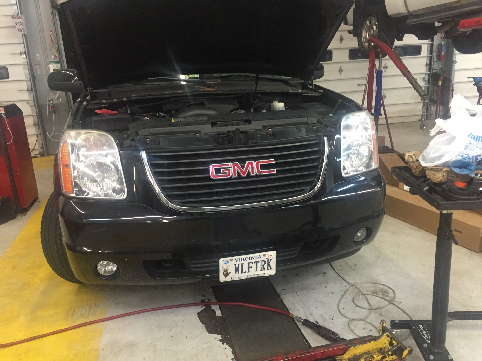

Its official she runs and drives and is sitting in front of my house, only have a couple minor issues that need to be addressed, in reflashing the bcm i theft locked my radio and xm receiver, and there is a small oil leak from either the oil cooler block off plate or the #5 main bearing cap side bolt, come to think of it i am not sure i actually ever replaced the cap side bolts, so i will be doing that and a new block off plate seal tomorrow... As far as the radio and xm, i was able to unlock the radio, but not sure what to do with the xm receiver, have been thinking about calling gm and getting a code to turn the tu/td on in my stock files otherwise, sad part is all indications are telling me my vin is still in the bcm! I used an 08 denali vin to reprogram the bcm with the correct operating system to get tu/td working and only a few of the files werent the same.... figure calling gm would be less expensive than a new digital radio receiver!! Almost forgot my park assist is throwing a service oark assist message in the DIC!! I have not installed the 6 soeed cluster i have as of yet, debating on whether i want to go ahead and order a denali cluster!! At the moment when i hit the tu/td button it uses the 1,2,3 to jndicate gear, 1st will have the little indicator under it, upshift and goes to the 2 and so on.... I need to sell off some of the spare parts i have before i can buy more!! At some point i will find a proper connector and eliminate the 16-18 butt connectors i have on the leg of the harness i had to add to the engine harness for the x300(fuel pump relay control, fuel level and evap vent valve ) and the bank 2 downsream) i also want a set of denali tailllights, but the front end and probably read end and ujoints are the next order of business for this truck..... At least as far as parts and spending money ...

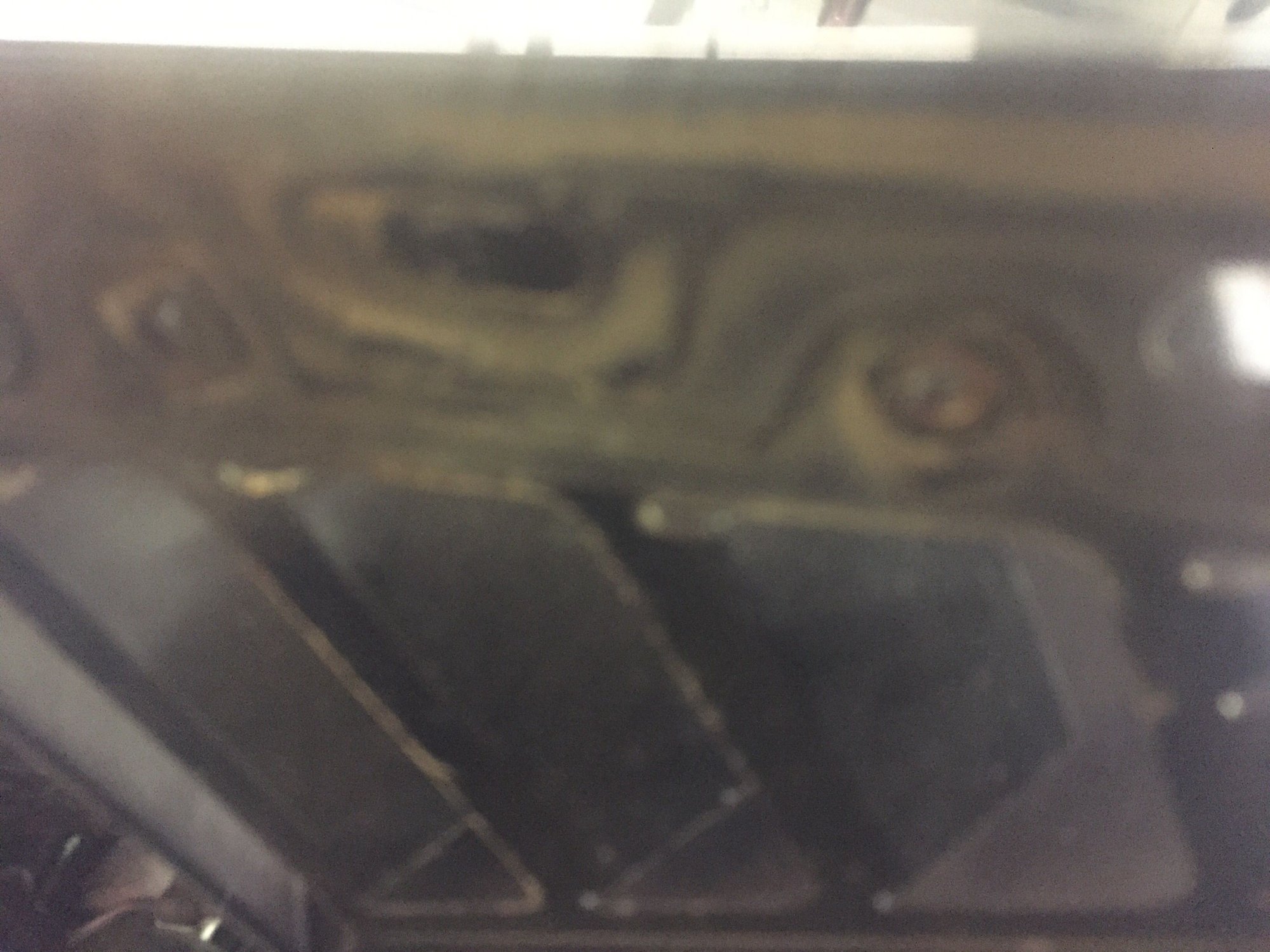

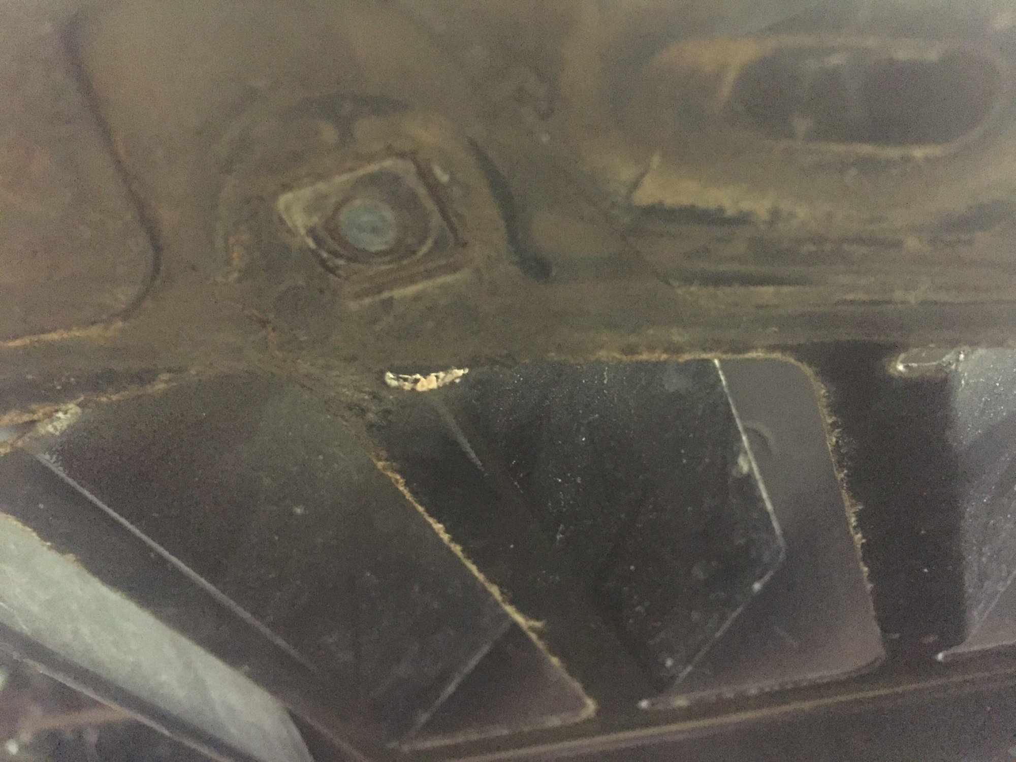

All 4 of the fascia to fender bolts broke coming off along with the speed nuts on the lower fascia brackets..
Pic sucks, but bolts are out, a little heat and a stud extra tor and the came right out through the inner wall of the fender....
And she is officially back together, aside from a couple odd and ends....
