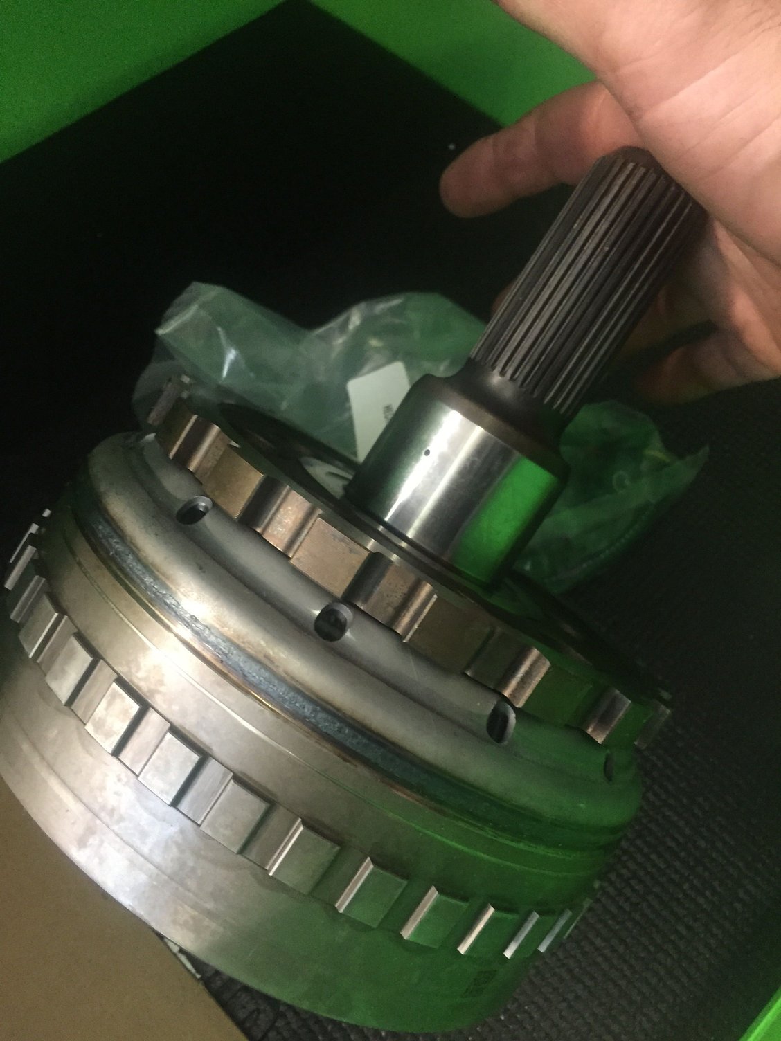

New output shaft assembly, which is according to the paper in the box an updated design, the old one the ring gears were seperatable, these are built into the housing.....
Solid ring gears

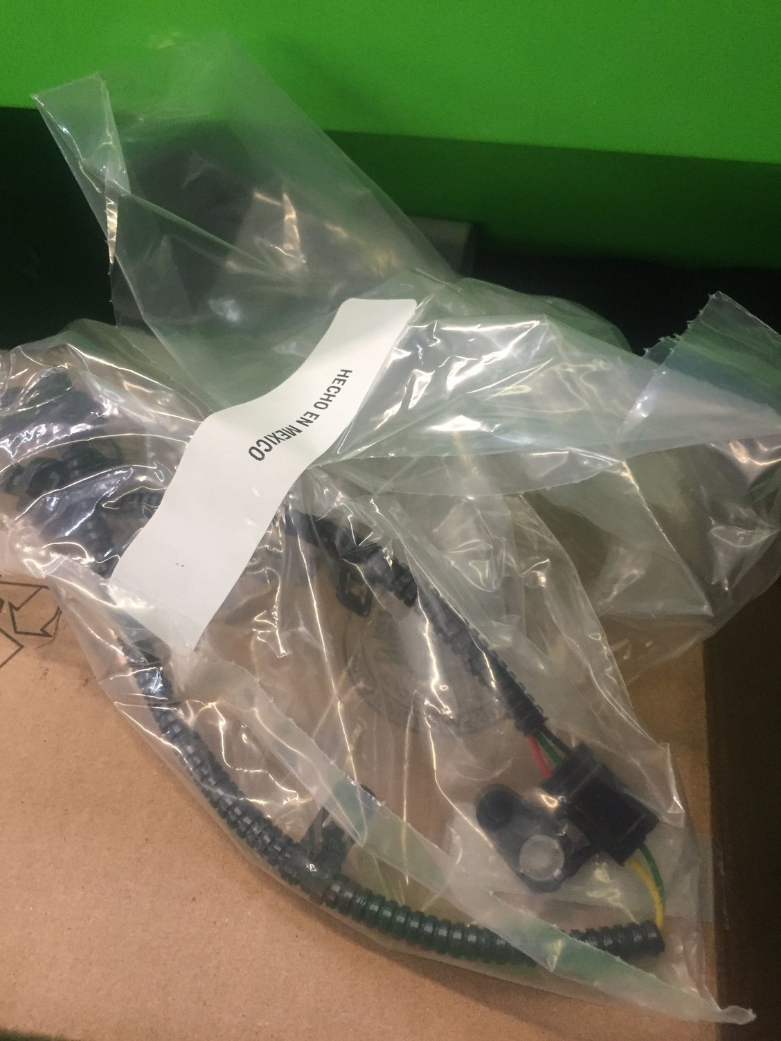

Output came with new input/output shaft sensor harness
