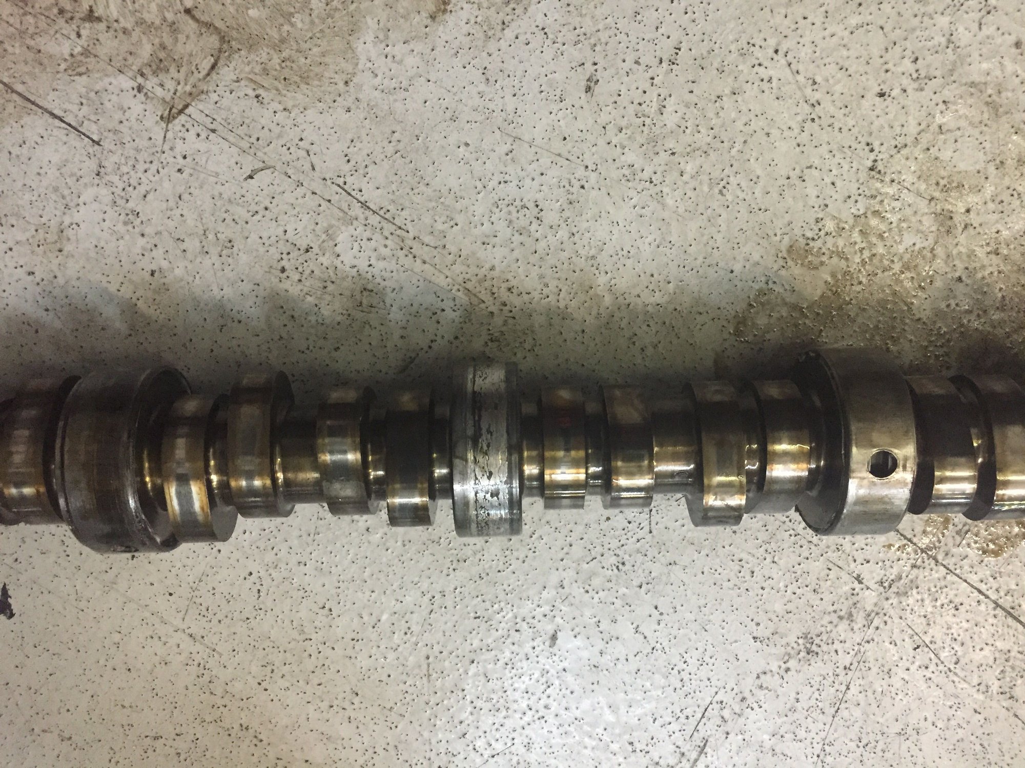

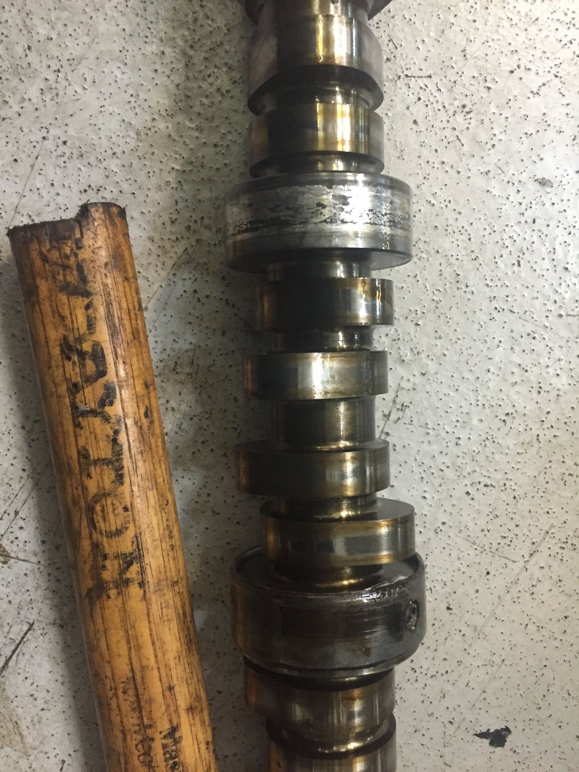

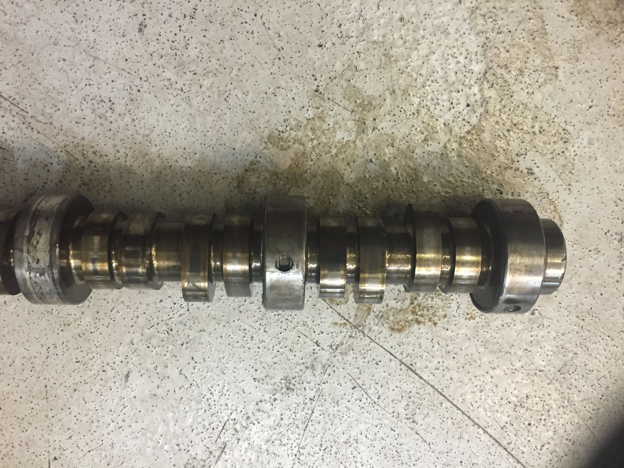

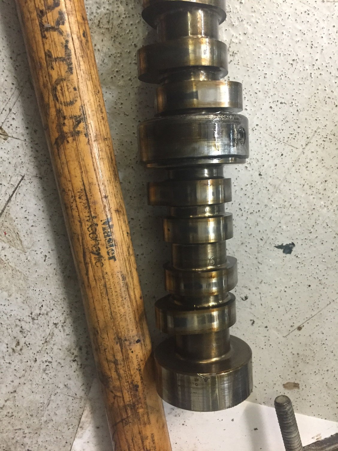

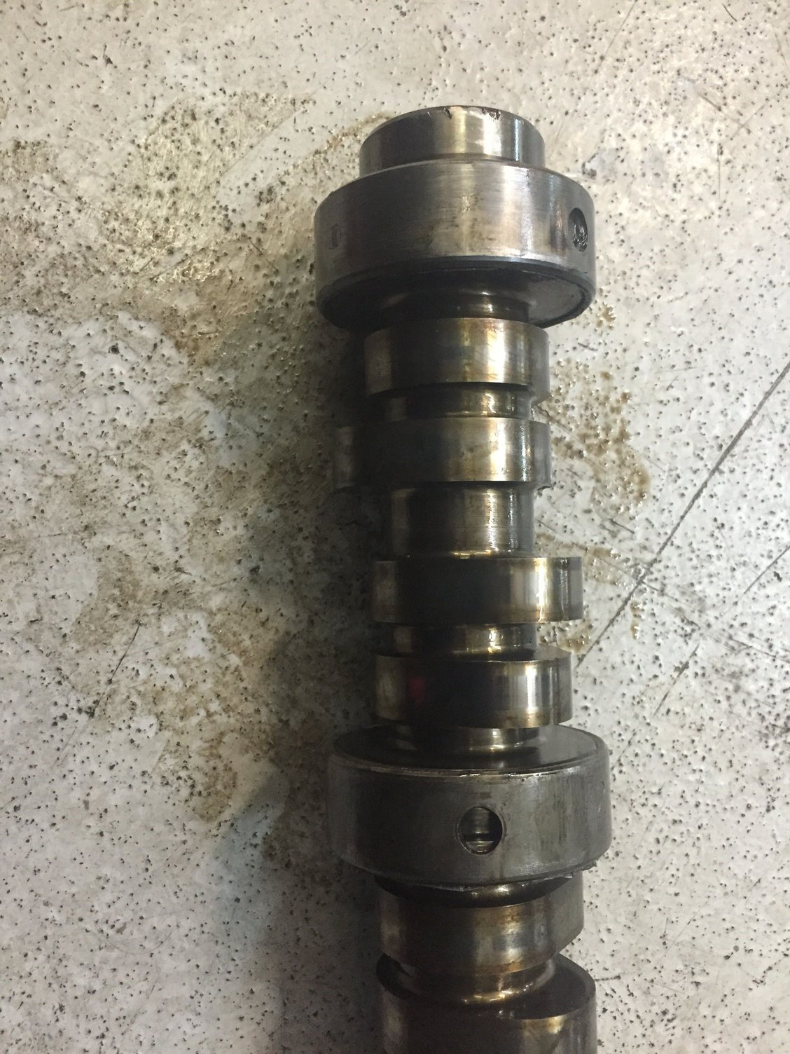

Well..... Got cam out brought 3 bearings with it.... 1 and 2 on respective journals.... 4th joirnal took #3 bearing out....
Sometime in next few days ill measure can journals and see if the bearings spun in the block or if they just seized to cam... I could see the cam turning in the 1st bearing... If the block isnt usable ill yank the heads and few other parts(non dod valley cover) and look for another block....

It doesn't look good...
Is that a spun bearing on #3 or is that the cam journal?

Cam journal # 3 bearing is on 4th journal

Measured cam journals in block today... 1 and 2 are within spec, (can turn #2 on cam by hand #1will turn with pliers) bearing was still in 3(came out on the 4th journal of the cam) and 4-5 are still in block, now to find time to check rod/main bearings.... If bottom end bearings are good, ill throw a fresh set of bearings in it, get heads gone through, throw an ls3 cam in it and run with it.... And everything i own will have a 6.0 or larger in it!!!

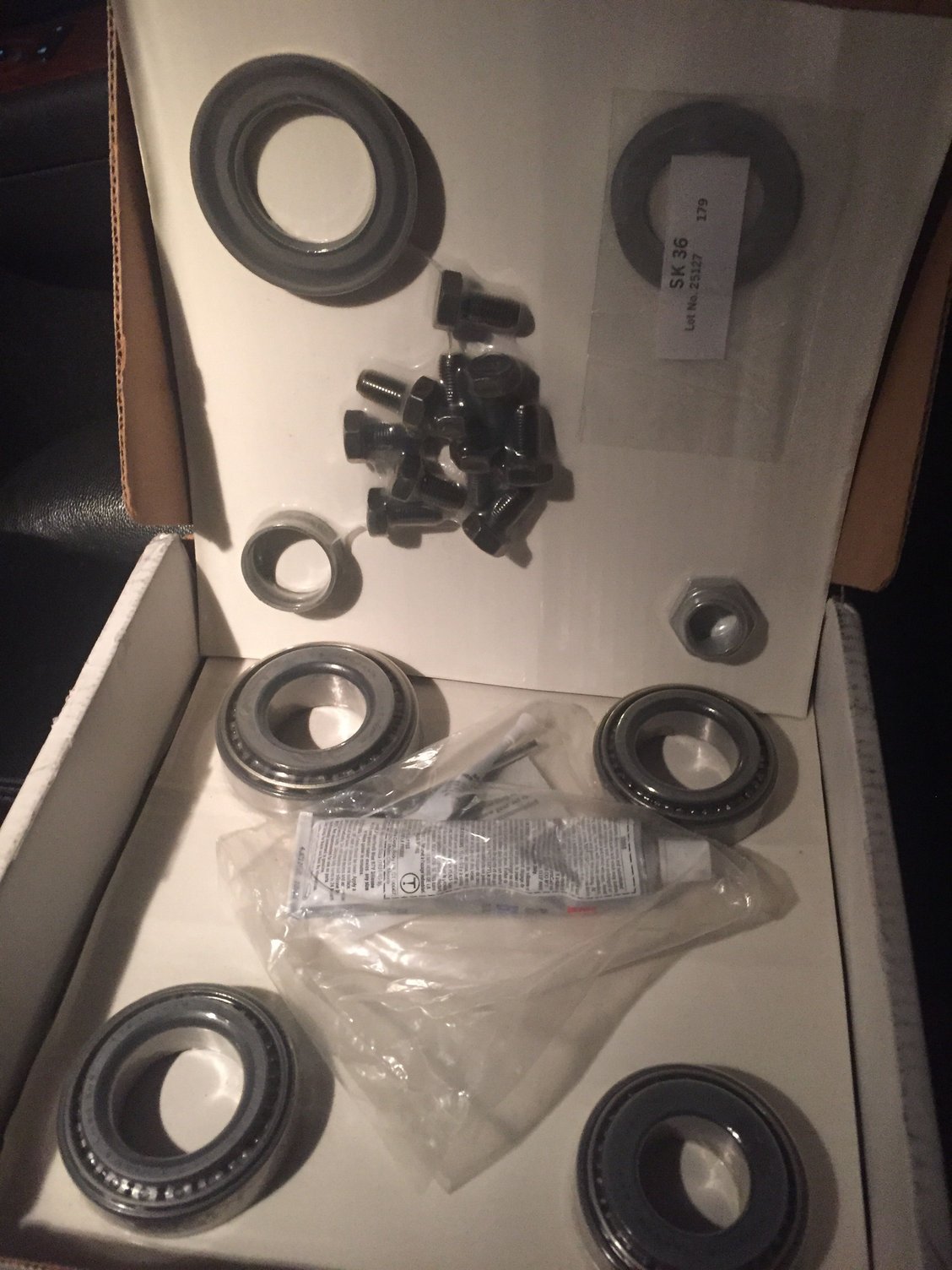

Got my bearing kit in today...
Guess i know what im doing later this week sometime...... Hoping no other parts are trashed
