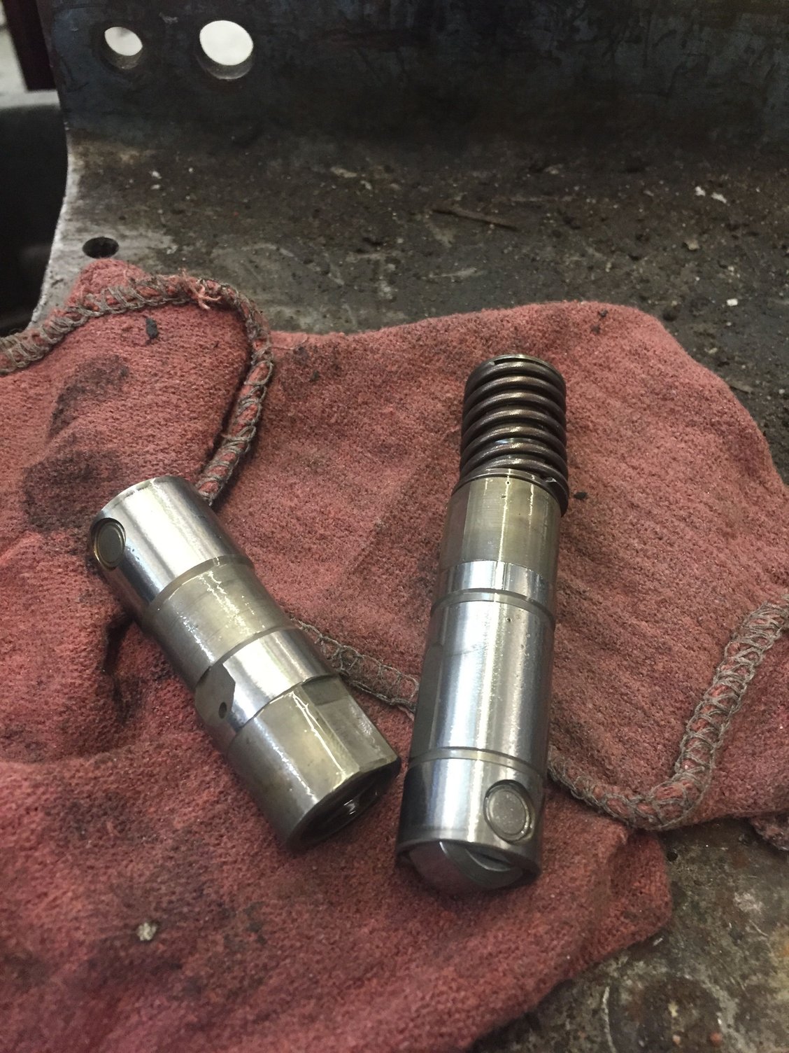

Originally Posted by Wolftrk99
Yes but according to si the lobes on dod abd non dod cylinders are different at least as far as lift goes.... Has to do im sure with difference in lifter length
perhaps on a non DOD cam???
The DOD cams are supposed to use the same lifters in all the the cylinders from what I understand. Same lifters and same push rods.

Dod lifters are different....1,4,6,7 have the goofy looking spring loaded lifters the other 4 cylinders have standard gm roller lifters

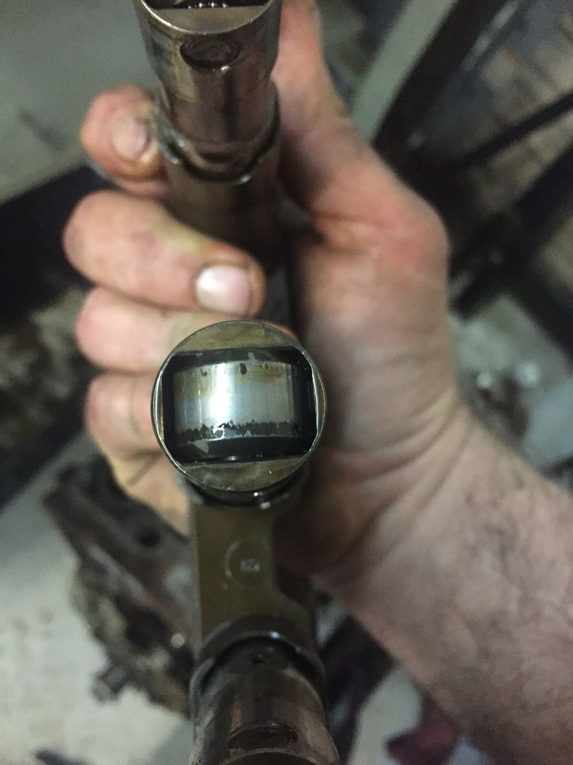

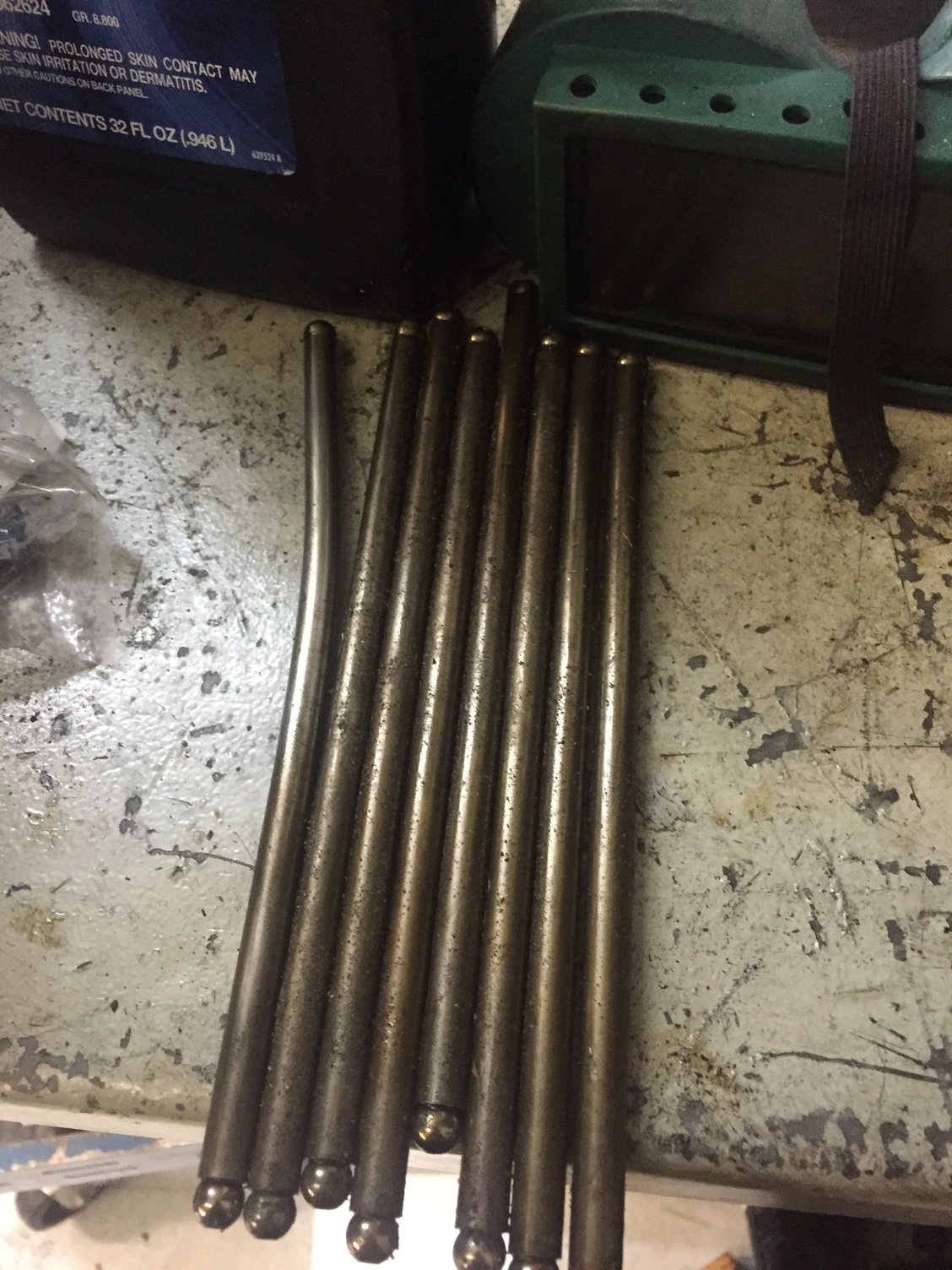

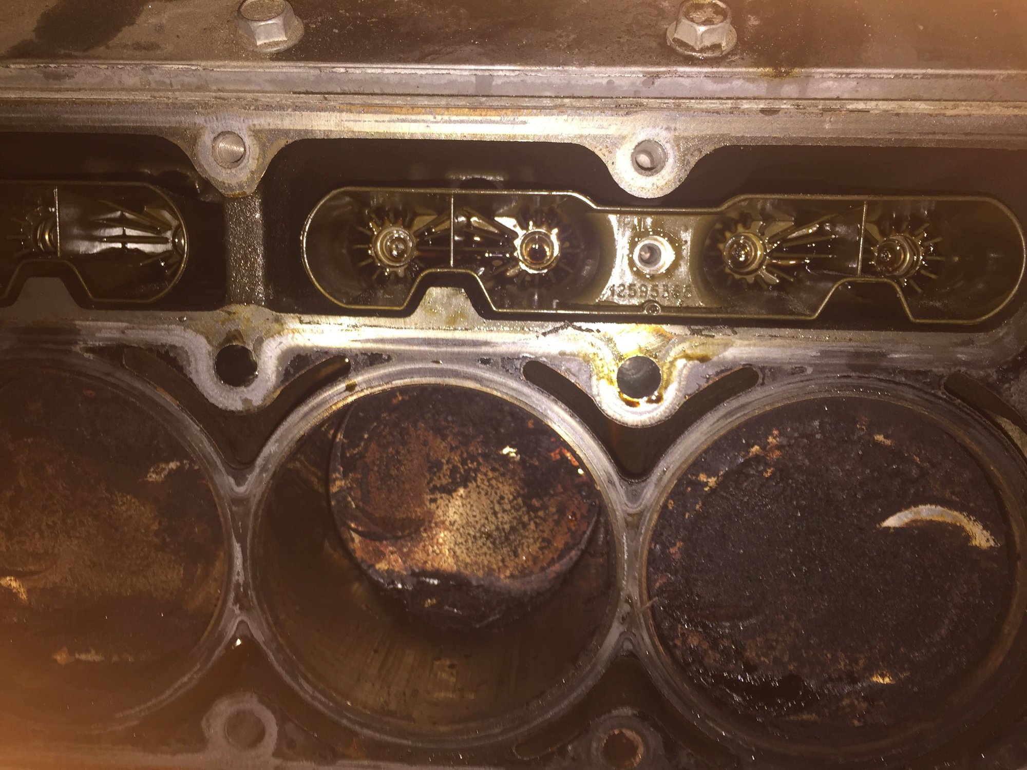

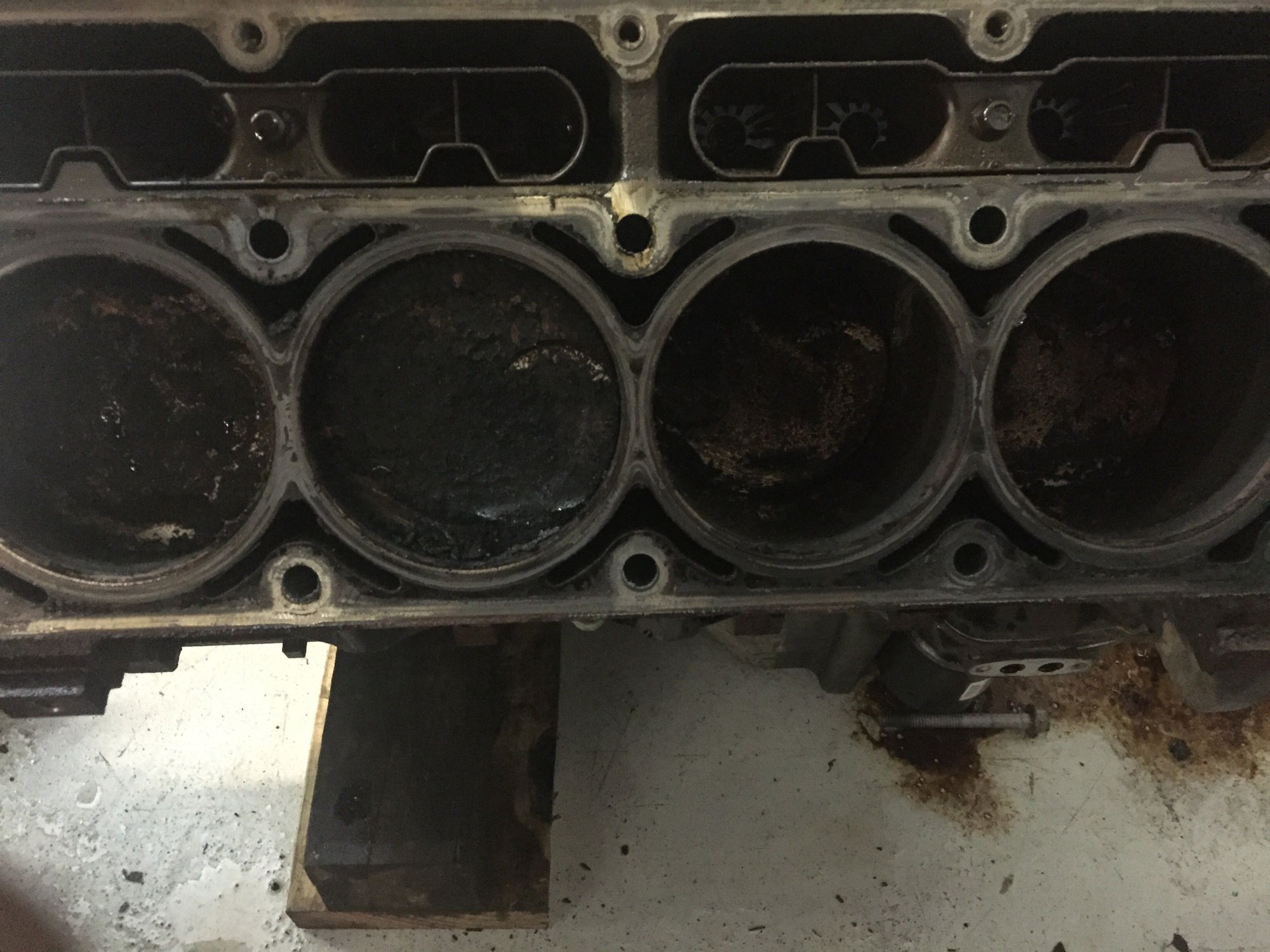

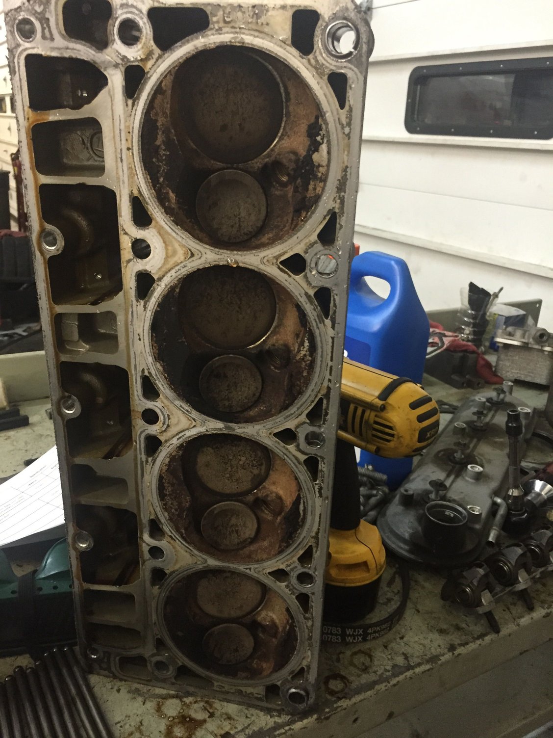

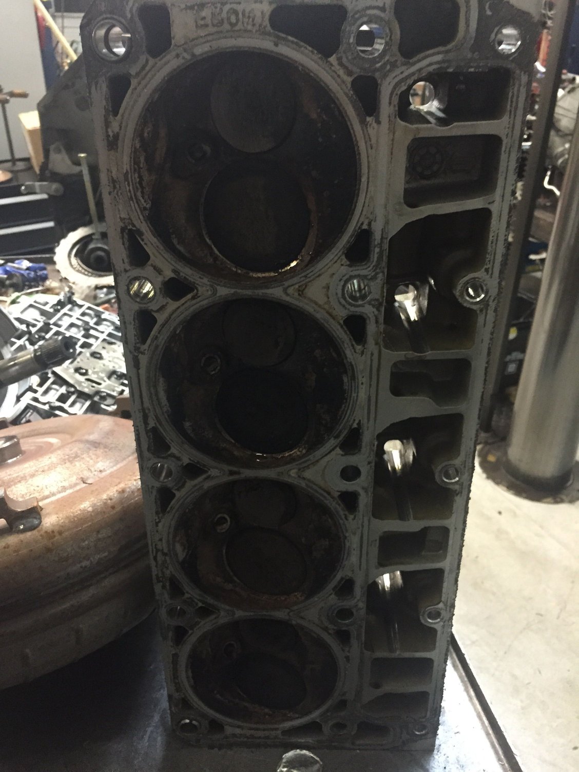

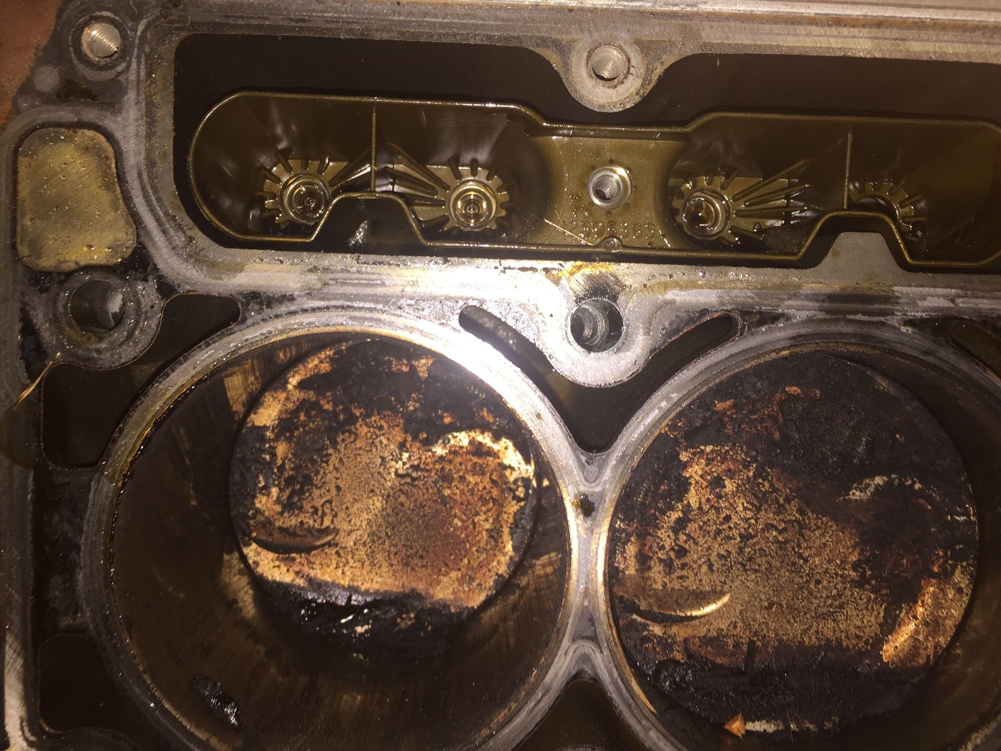

Default L96 teardown....
Tore into the l96 this evening before i left work just to see what kind of damage i had to deal with.....
Left bank pushrods in no particular order.... Didnt pay attention pulling em out but i think the bent one was #7 intake all the right side pushrods were straight
Looks like #3 may have touched a valve
One lifter on its way out on the right bank
Number two piston obviously hit a valve
May be a little bit of valve/piston kissing going on there in 6/8 but not much
Surprisingly the left head looks really clean and no obvious valve damage
Right head not as clean and no obvious valve damage
Other thing i found was cam didnt want to come out and only way it would turn was with a pair of pliers.....thinking it ate a cam bearing ill get it out later this week and check the cam bearings fairly sure its gonna need a set, just hope it didnt spin a cam bearing.....probably what sheared the locator pin off the front of the cam to begin with!!! If all goes well ill send heads out in next couple weeks and see if there are any bent valves..... May have them shaved a lil havent decided yet....
