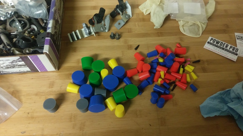

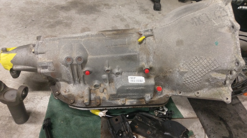

Bought some plugs to step up my painting game

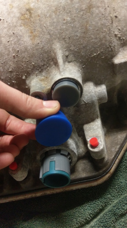

The big blue one should fit in the harness hole, I'll find out when I drop the pan and remove the harness

Now I just have to find to time to clean it up and paint it. Any tips? Will a wire wheel work or do I need brass wire wheels (if they even make those) so it doesn't gouge the aluminum?

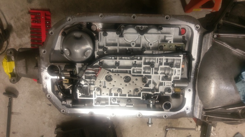

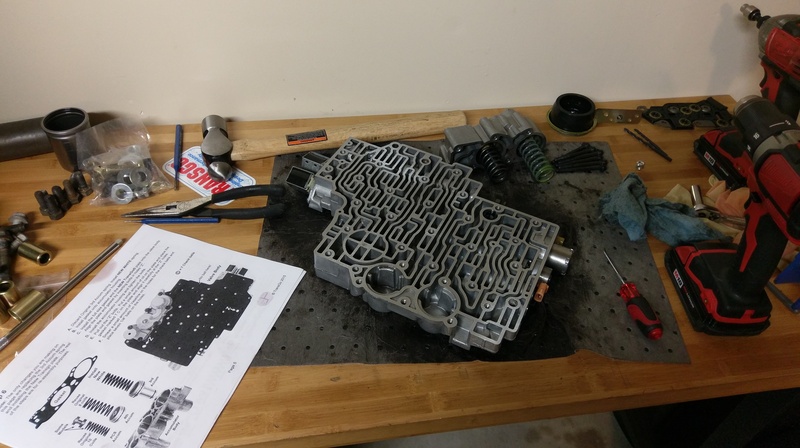

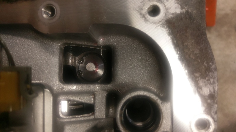

Finished the HD2 install this morning, went with recommendedations from Jake and drilled 1-2 to 0.125", no drill on 2-3, but removed checkball, and drilled 3-4 to 0.125". Reason I went that aggressive is because I will have a higher than stock stall. I like firm shifts, but hopefully it's not too harsh for a DD

Did everything the kit asked for except the inside parts since I'm not opening up the transmission
