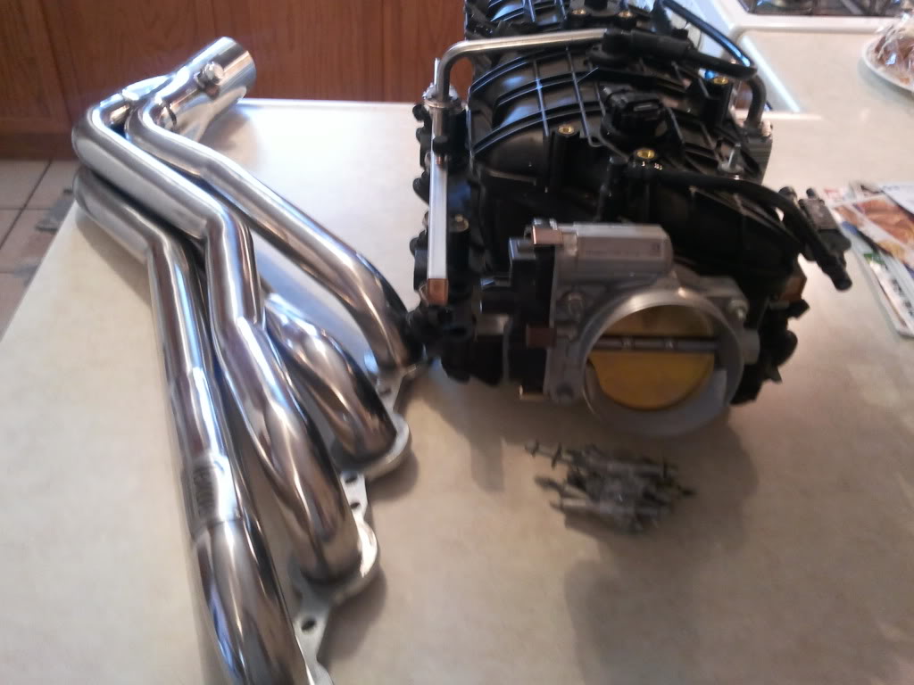

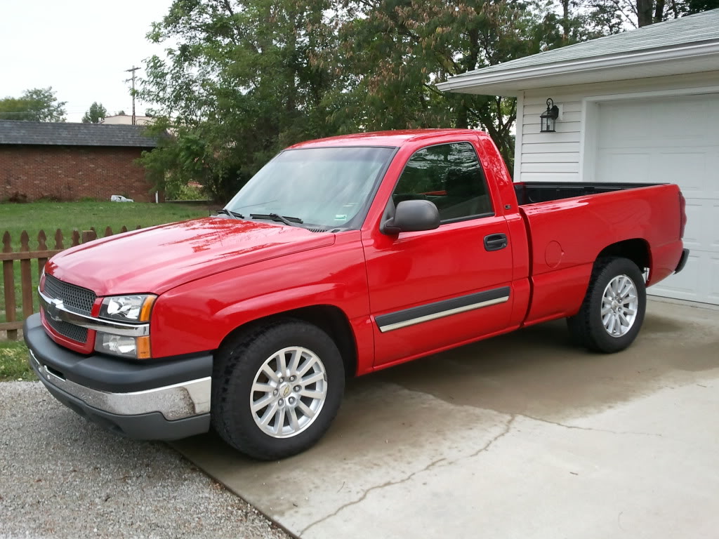

I've been lurking around here for a while and I am about to start building my truck (2003 RCSB stock 4.8) Thought I would share my learnings along the way.
I'm currently collecting parts and hope to complete this project before summer.
Ok Here it goes....
ENGINE
-Junkyard LQ9
-799 heads milled
-TBSS intake
-LS3 throttle body w/xlink
-8.1 marine injectors
-LS2 Timing Chain
-New GM oil pump
-(un-named) lifters
-Tick Performance Camshaft SNS Torque master stage 2
231/235 .617"/.621" 111+2
-Brian Tooley dual valve springs
-Hardened pushrods
-Comp trunion kit
TRANSMISSION
-4L80E
-Circle D 3500 stall
-Transgo shift kit
-Custom cross member
-Had to shorten driveshaft 1 1/8th inch (its PERFECT)
REAREND
-TrueTrac
-3:90 gears
EXHAUST
-Texas speed stainless long tubes 1 3/4" primaries
-Magnaflow 12599 muffler with Dual 3 inch exhaust exiting behind passenger tire
EXTERIOR
-LTZ 5308 wheels
-2/4 drop Mcgaughy's
-smoothed and painted front bumper and SS grille
-gm red door handles and tailgate handle
-VortecMAX emblems
-painted mirror caps
-tinted original headlights and tails
-cowl hood
-roll pan
Pic's and updates to come!!!
