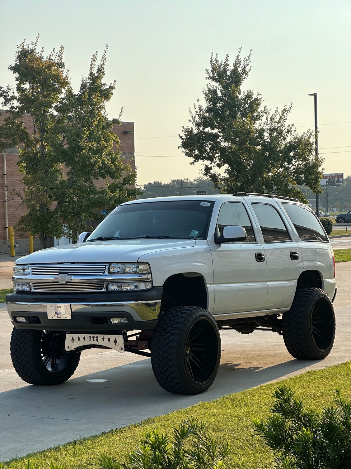

I have a Tahoe that I was looking to put a cam and new torque converter in. I usually run 37s and have a 3.73 rear end. Not looking for much just a nice sound with a little gain in horse power. Just looking to get some input on what y’all think would be the best and most practical setup to put into my Tahoe. Thanks!
edit: not trying to make serious power upgrades or spend a ton of money.
