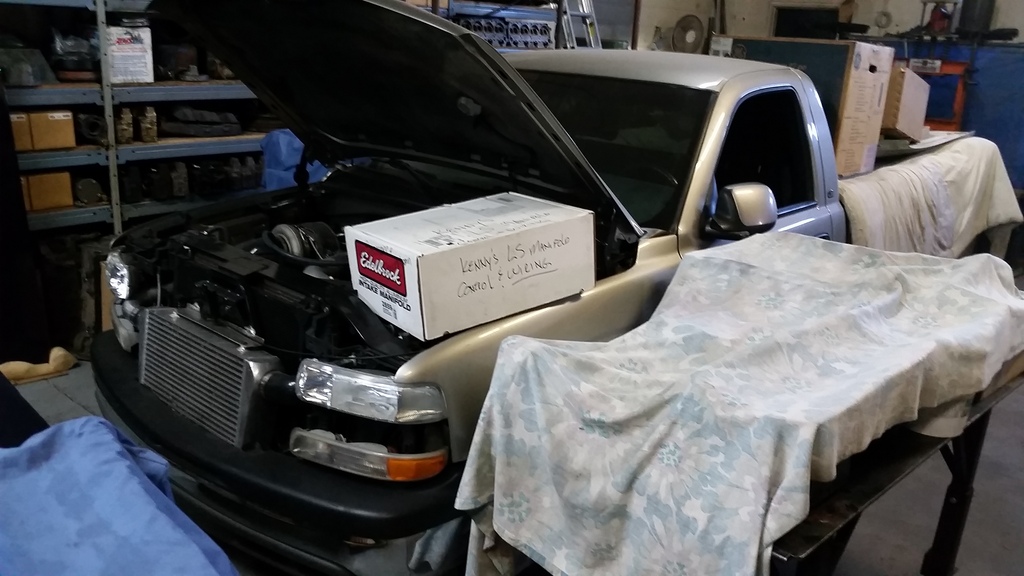

Well, it has become a shop ornament, I started my own business, a sign, decal, and design shop. That has taken priority. It is something I have done on the side for years, and it was time to dedicate full time efforts to the business. It has been great! BUT the truck has been collecting dust. The race car has only been out on the street once, and no trips to the race track this year.
However, I have an update for everyone! I am getting pretty close to having everything to put the 408 together! I need main bearings, and cam bearings, and little odds and ends. Today I took the rotating assembly over to get balanced, then it will be time to do a little clearancing on the block and final assembly! It still will take some time to get it all together, and for now I will run it with the turbo I have until the budget allows the proper unit to be slapped on.
I bought a carb intake, and an MSD ignition controller so that I can break it in and run it on motor on our engine dyno, then it will go into the truck and get a tune sorted out!
-Kenny
