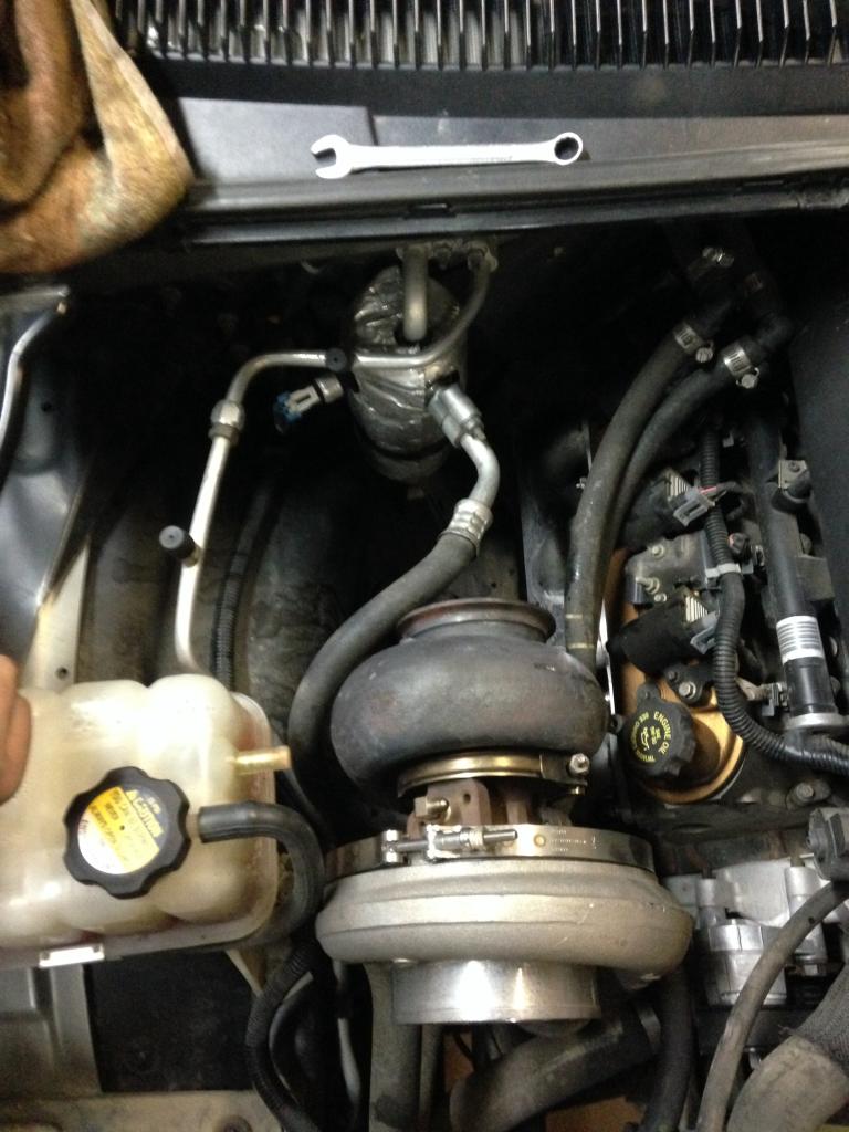

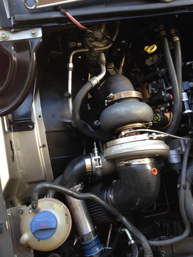

Originally Posted by bluchev
what did you end up doing with the ac line by the downpipe? any pics?
I followed the foot steps of the "White Noise" thread on here and I bent the line coming out of the firewall with a crescent wrench and hoped it didn't break. It didn't! So, this will rotate the accumulator when you do it. my A/C lines are completely stock.
Before
After
-Kenny

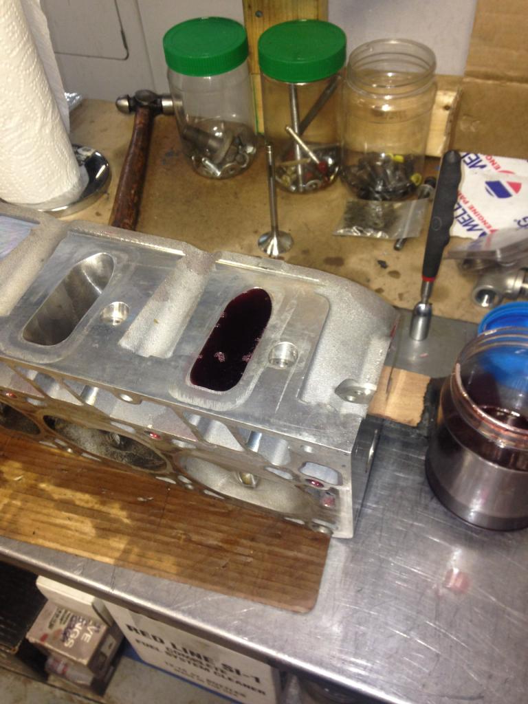

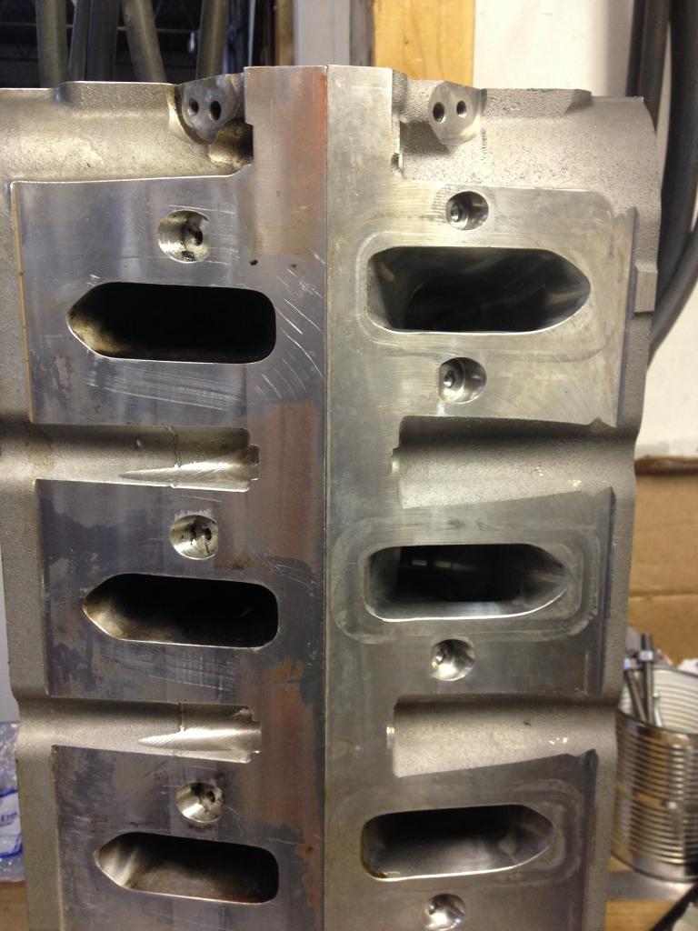

I've slowed the project down as of late, since I quit my career as a 3D CAD Designer, and I am trying my hand at new vehicle sales! Huge change for me, and I am going to take a bit getting in the swing of things here, but before I did that, I picked up a set of lightly used PRC 2.5 64cc chamber heads. They don't post the intake volume on the Texas-Speed website, so I was bored the other day and sat them beside one of our customers 235cc Trick Flows. The ports measured out wider on the PRC's. Trick flows were 1.06" and the PRC's were 1.125" which I found interesting. So I CC'd the PRC and it has an intake port volume of 245cc.
Trick Flow 235cc on the left, PRC on the right
PRC intake port
CC'ing the PRC
The chamber of the Trick Flow is nicer of course, and maybe they flow more on a bench, but for the price, its hard to go wrong with the PRC from the looks of it!
-Kenny
