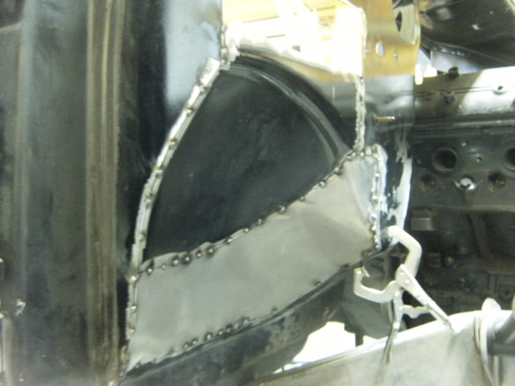

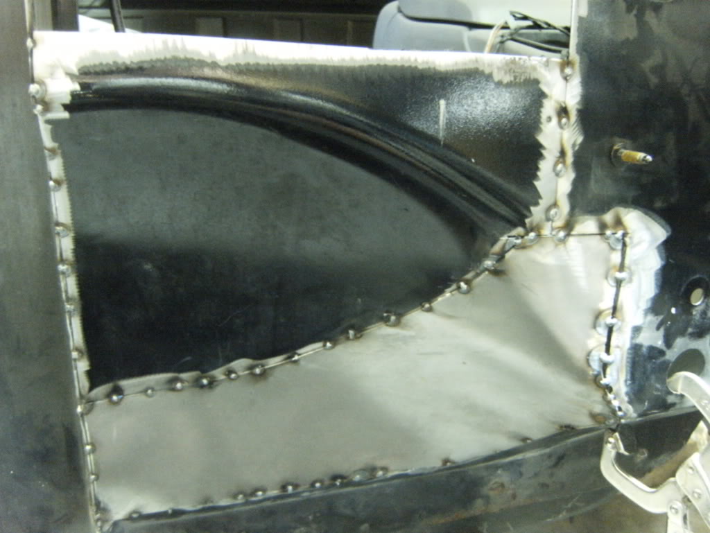

well after a little over a month I took Sunday off to relax and work on my truck, didn't get TOO much done, but back on track.
Tubbed the otherside of the firewall, raised the factory tub of course

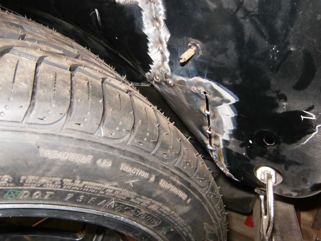

Clearance
Full lock at 2" ride height, not that it matters since I wouldn't be able to turn that much with fenders, but just goes to show I made them wide enough to allow adequate turning

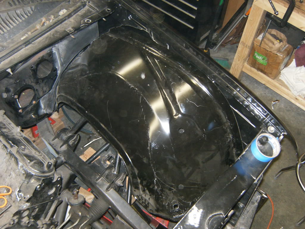

Started on the fenders, bought two brand new OEM fenders, and proceeded to drill the spot welds out and start cutting.

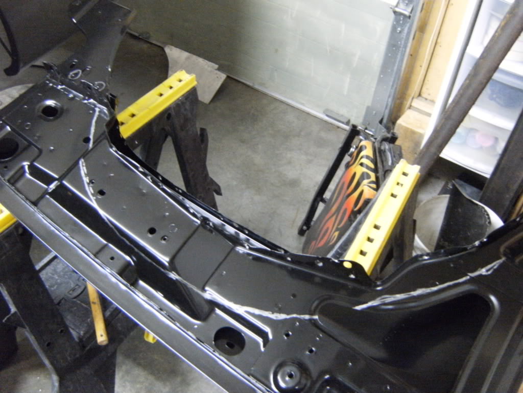

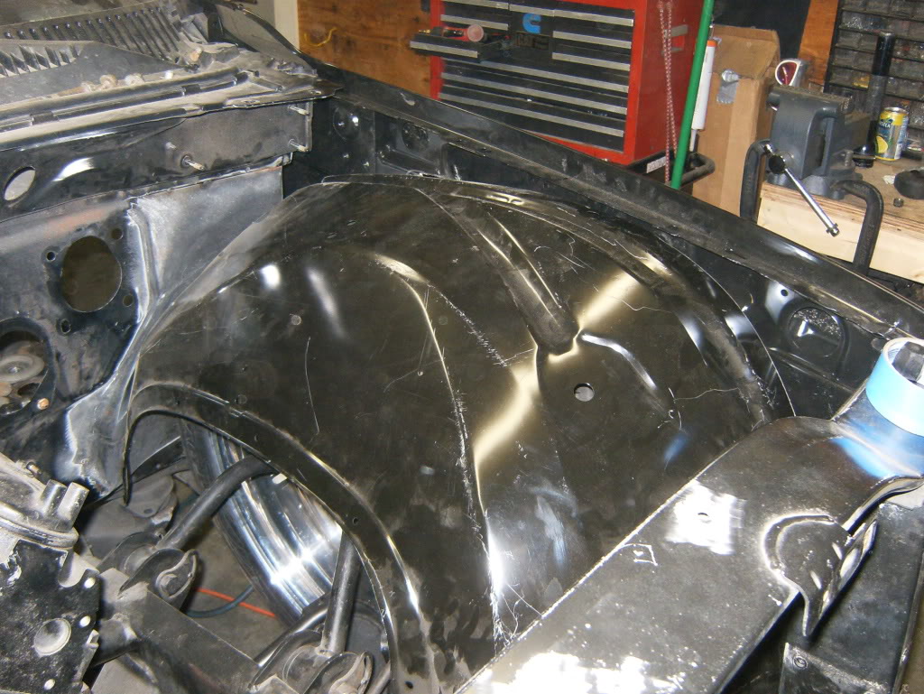

Cut and now to the special part, ordered two pre-99 inner fenders, going to try to make them work. They taper to quickly so they sit pretty high here, but I'm going to try to modify them. I actually have them installed opposite also, drivers on passenger. Worked better that way.
