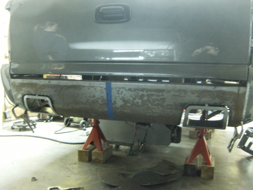

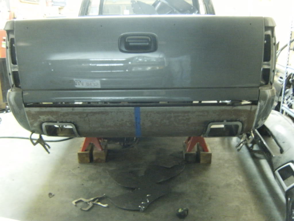

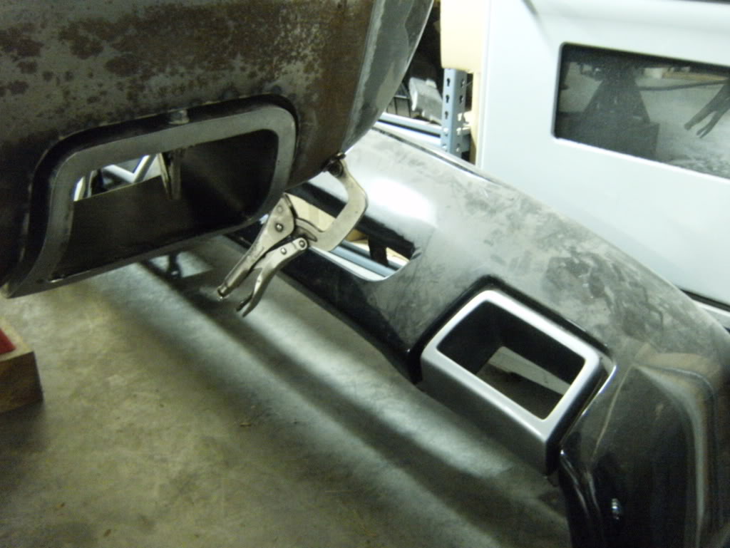

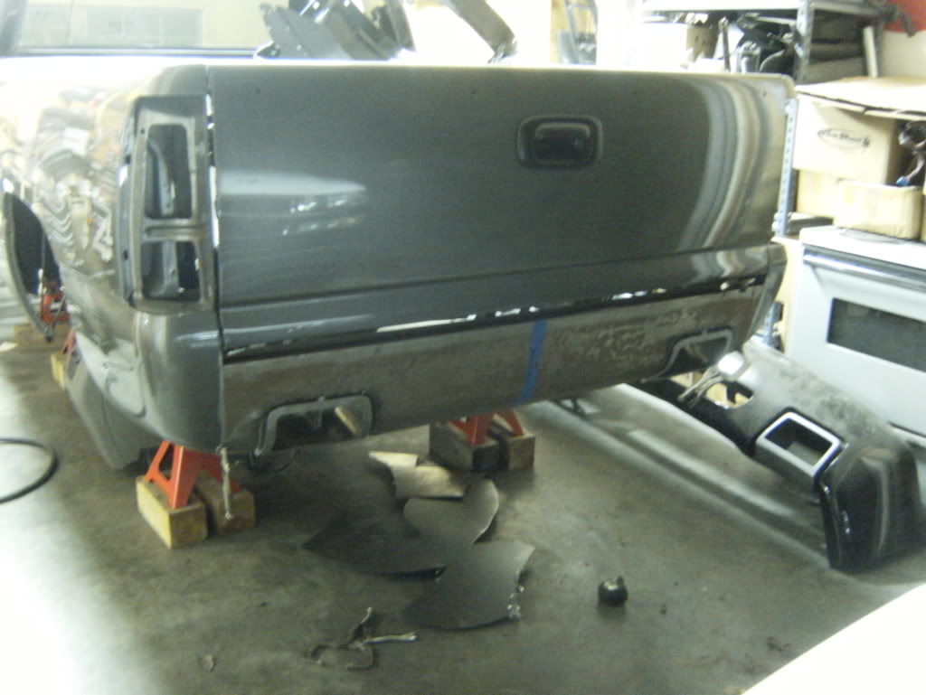

So after some pondering, I think I'm going to nix the OBS inner fenders... not completely sure yet. So I decided I'd go back and finish my exhaust tips. Come to find out I forgot to take into account the taper of the roll pan when I jigged up the tips and made them square to the pan not level with the ground. However it's not terrible, and too drastic so I should be able to live with it. However I need to re cut the openings in the roll pan, for now here are a few pics of them mocked up.

Here you can see the rear tip compared to the front bumper duct

looking good.... Exhaust tips look bad ***.
