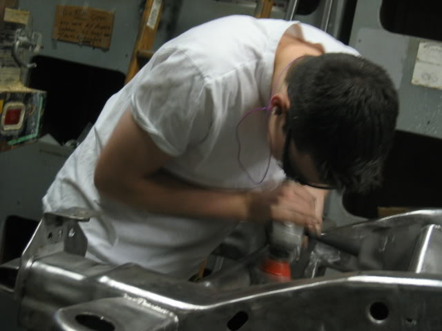

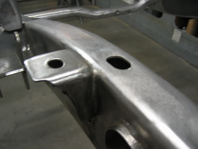

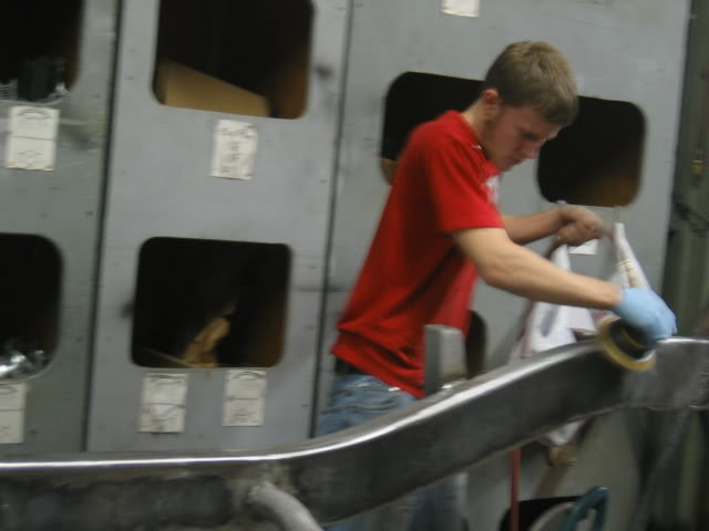

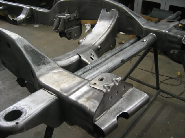

Slaved away with the DA today, my buddy came down to help with the grinder and a wire wheel getting the little rust that was left, getting it prepped for paint. Should have my rearend back soon so I can weld the shock mounts and paint this thing up.

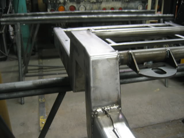

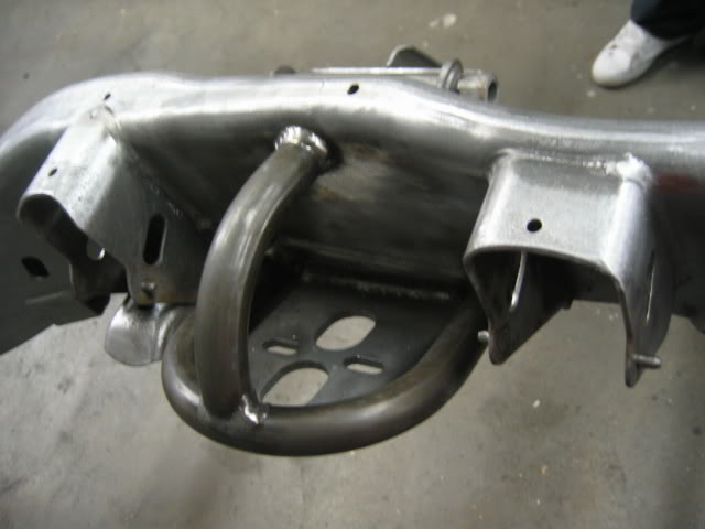

Flipped the frame and ended up finding the melting point of the backing plate.. guess it got a little hot so I got to finish tomorrow I guess.

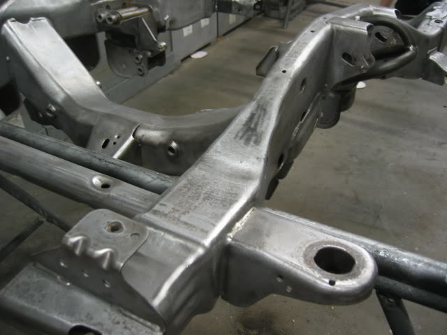

Top looks good though :thumbsup:

I did 80grit then 180grit along the whole thing, nice and smooth ready for paint
