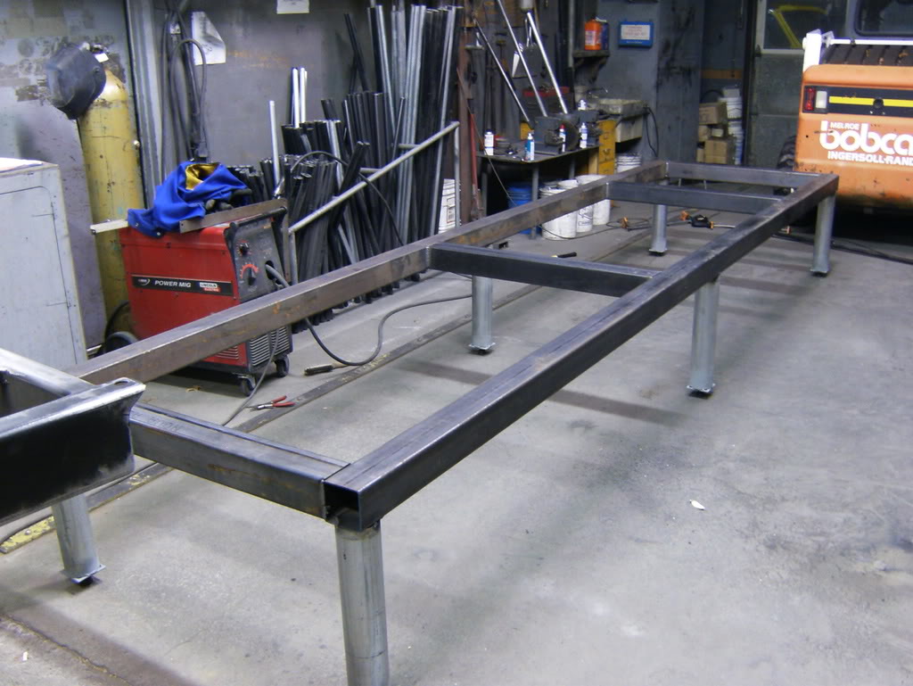

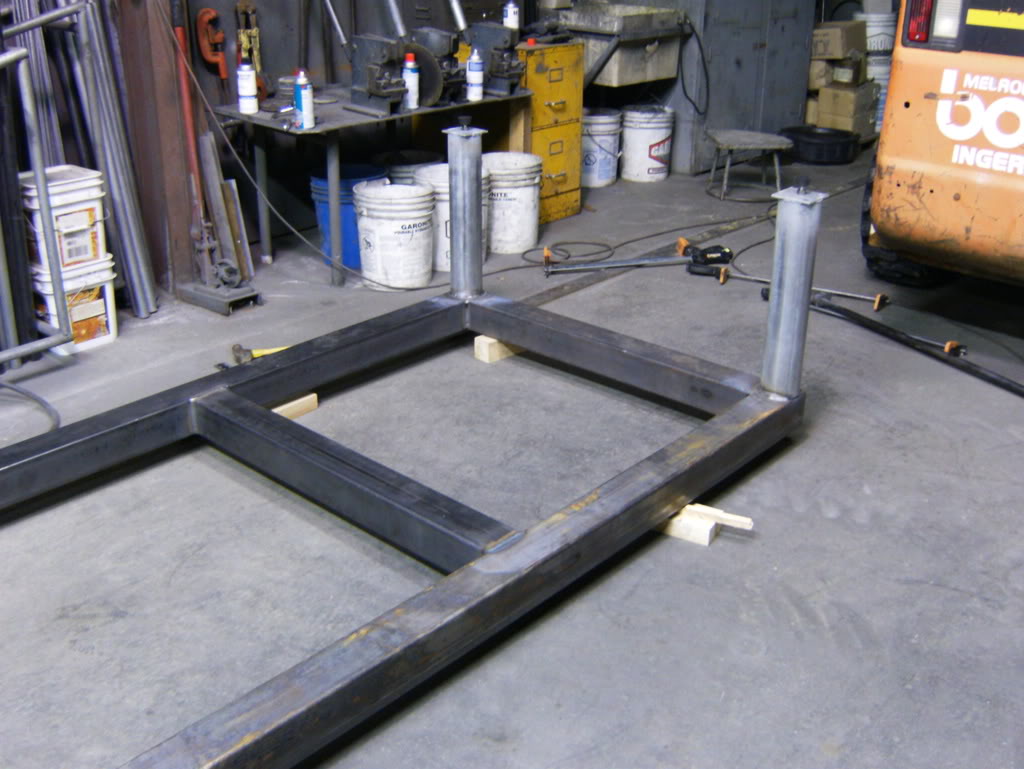

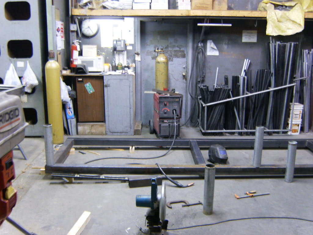

Back working on this thing after saving some coin for the NEW tubular frame, so buy my frame that is feature on the first 23 pages of this thread, PM me with an offer, serious inquires only please.
Well I picked up some 4x4x.120 wall tubing for my frame table. Cut it down and built a table 4'x16'x2' high. Level and square, ready for welding.

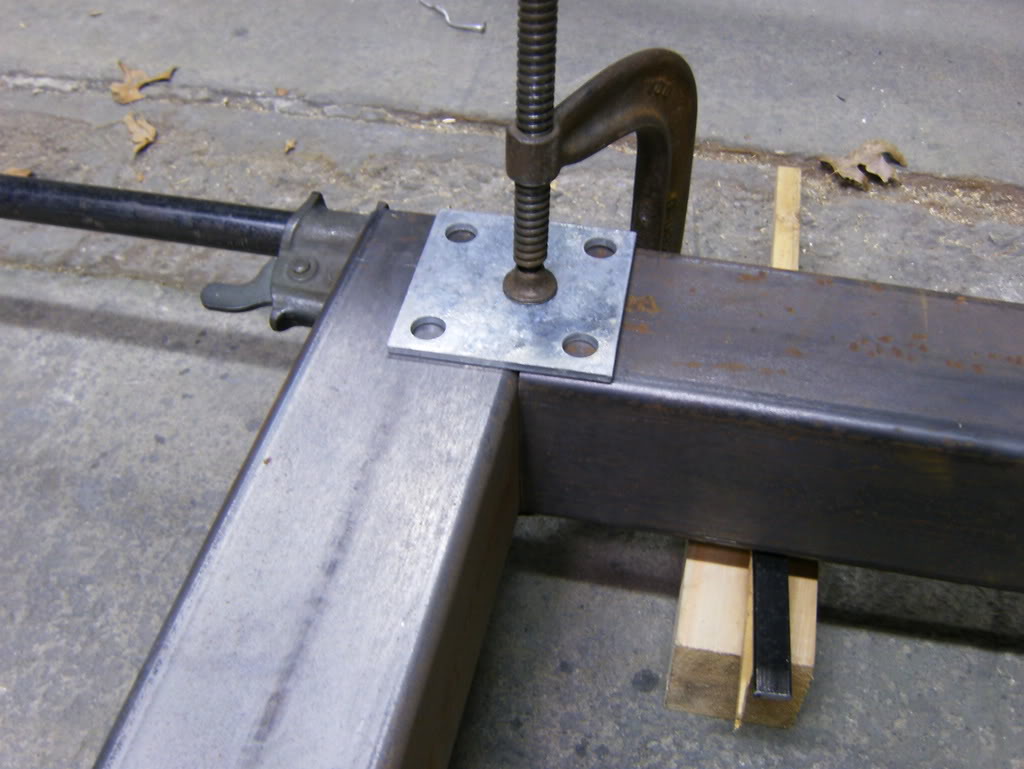

Used some plates to keep it flat while welding

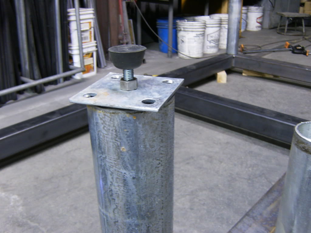

Cut some pipe I had laying around for legs

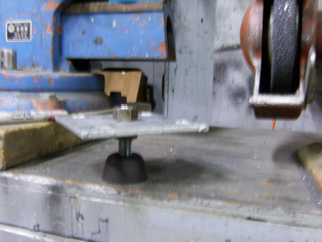

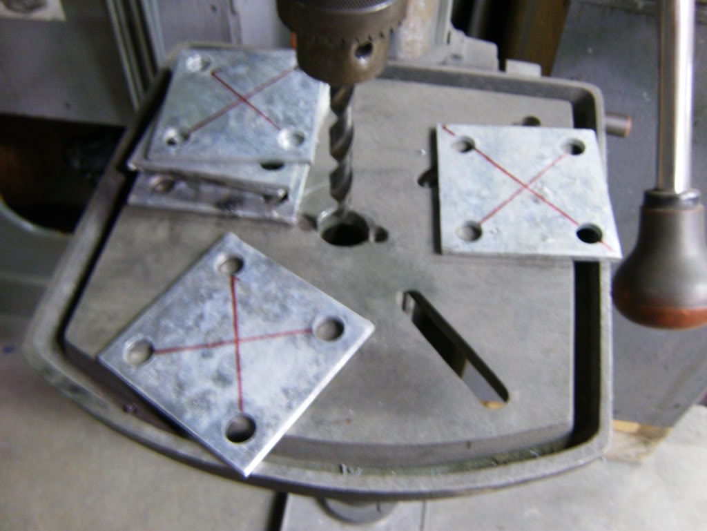

Some plates to drill for the rubber leveling legs

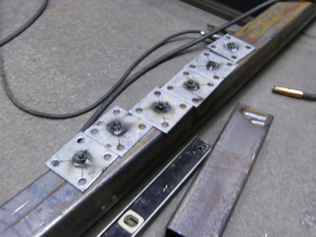

Inner nuts tacked up

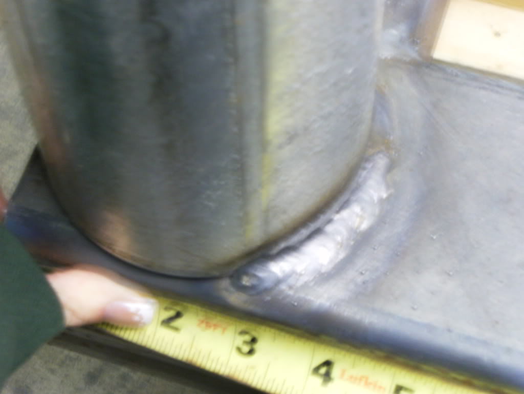

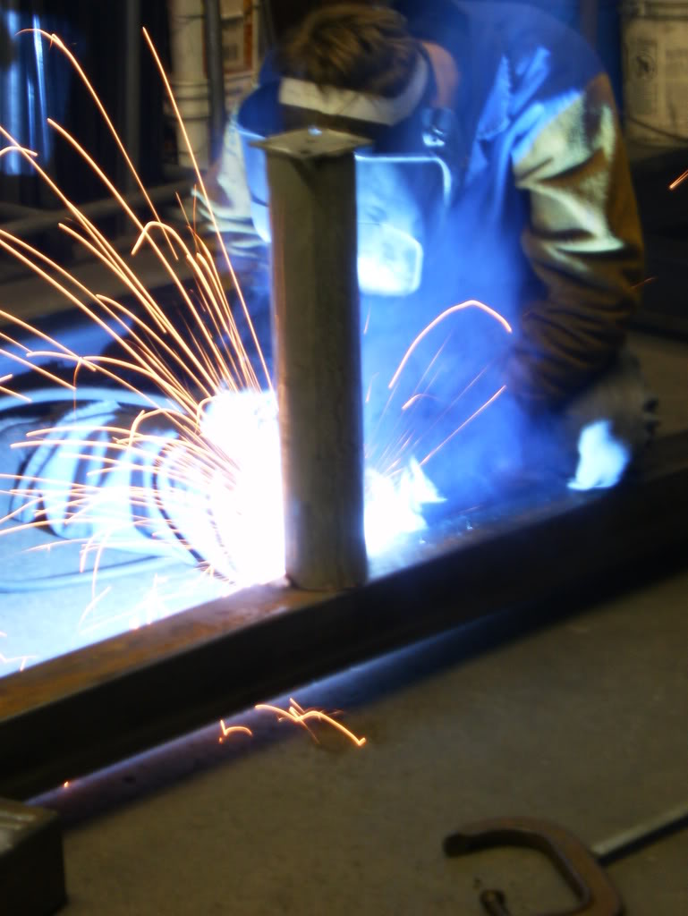

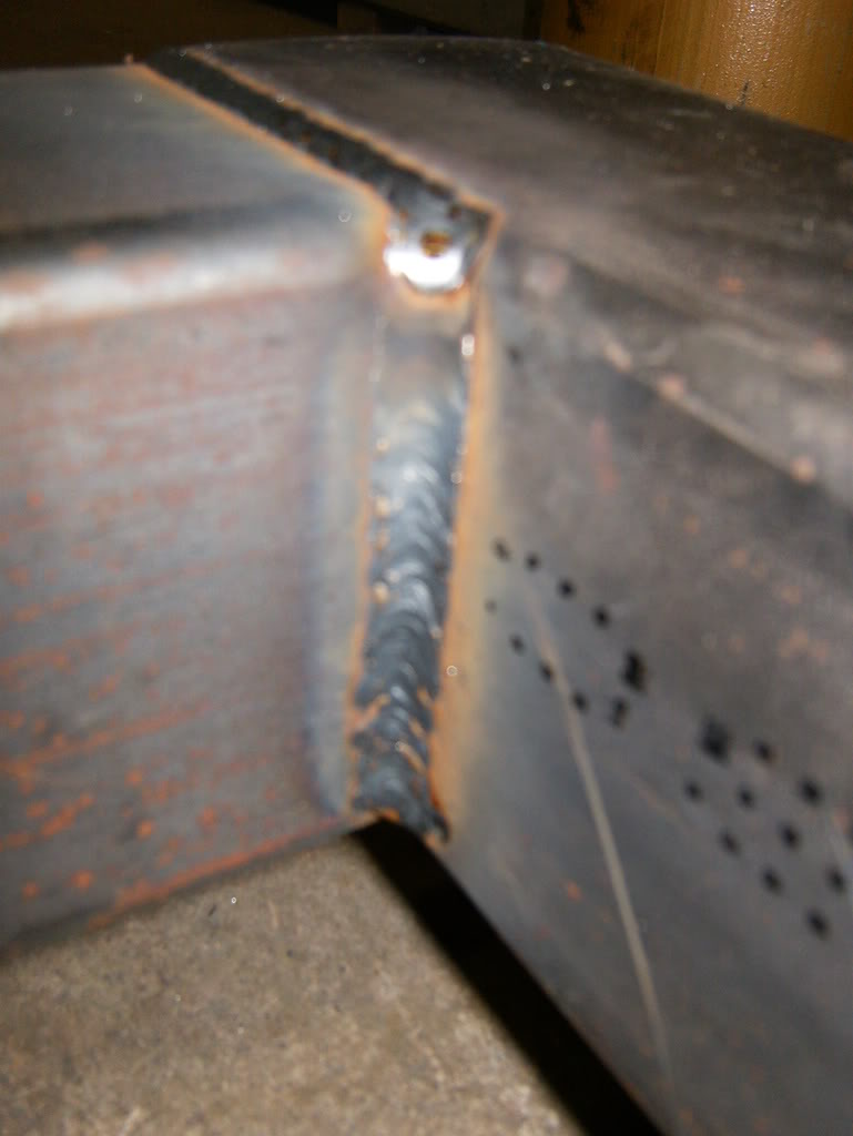

Legs getting welded up
All welded up

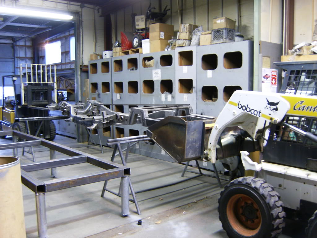

Hey look a Bobcat, oh and it's flat
Working by myself... I have to improvise.
For Sale, anyone?

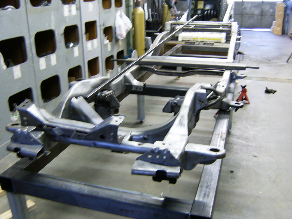

Measuring and squaring, and marking to blue print my mandrel front rails and getting ready to jig this frame
Hold it in place, keeping points for new frame

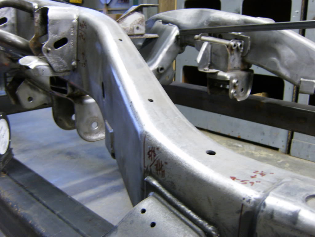

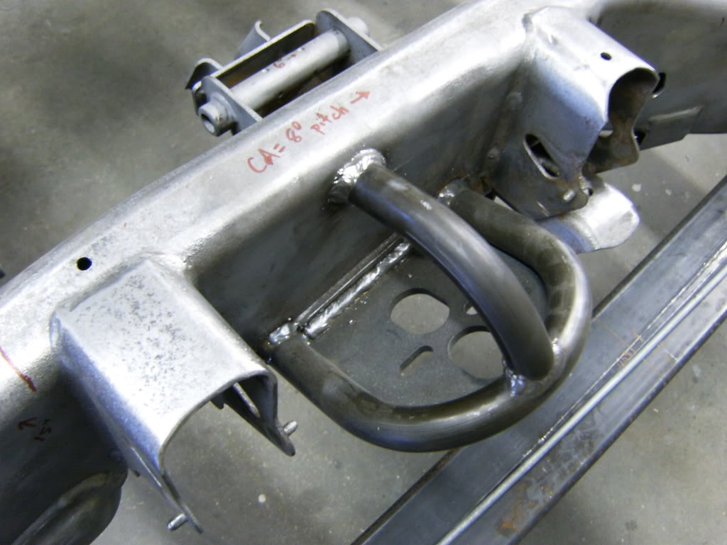

8* pitch backwards on the upper arms, if anyone was interested.

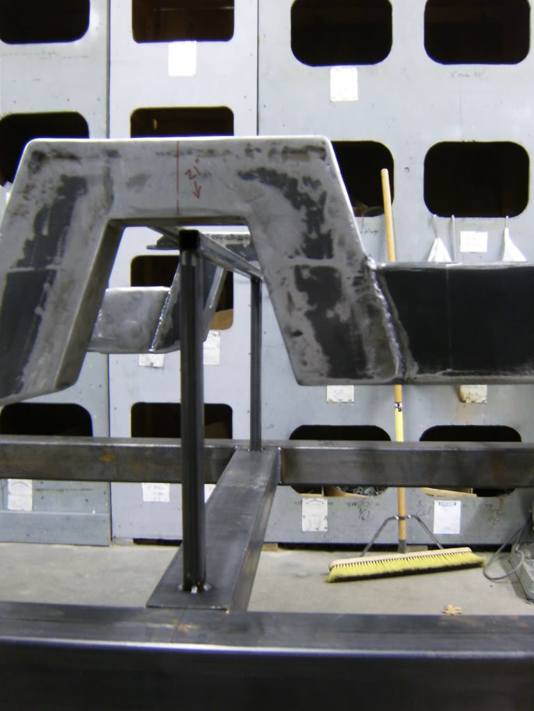

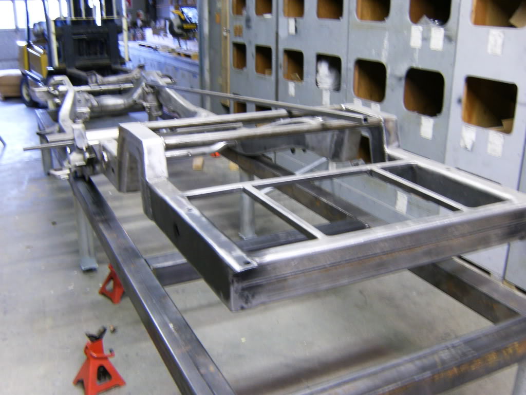

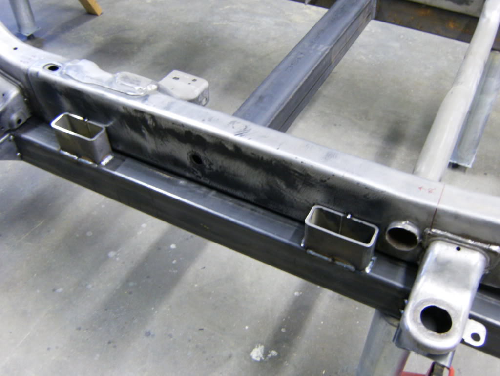

This 1x1 represents the bottom of the new frames height, behind the cab. it will curve up and continue that plane instead of notching.
