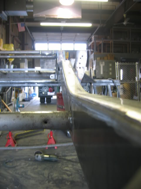

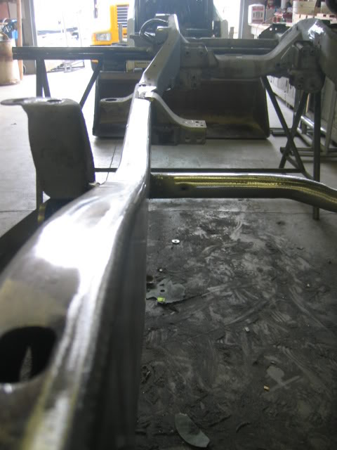

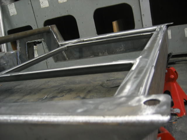

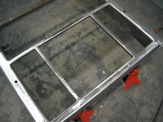

So my frame is basically 99% done, all that's left is DAing the frame smooth and shock mounts... but until I pick up some temporary shocks to match my huge money shocks I'm done with the frame.
Wednesday I bring my frame over to my body guy to put on his machine to make sure nothing tweaked from the welding and grinding.

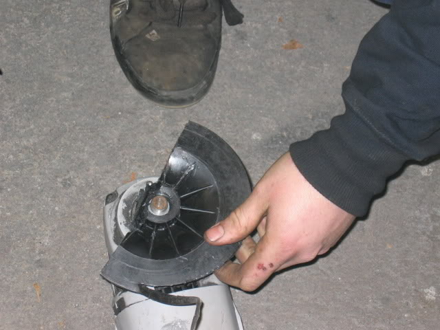

But now the bad... my last grind the new grinder backing plate snagged an edge sheared the backing plate whipped the disc and sheared the nut holding it on.... so I had to cut it in order to get the thing off :bawl: back to the store for another

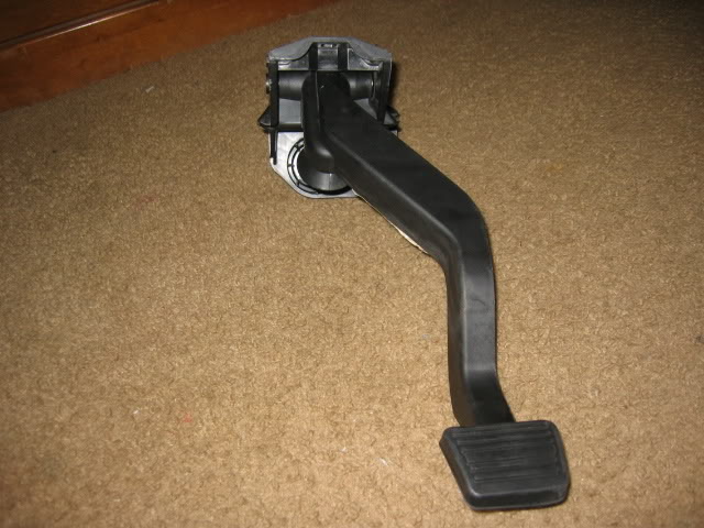

Got home today to see a box on the front porch... I can never remember what I have ordered so I ripped it open and here is the first part to my swap... factory clutch pedal

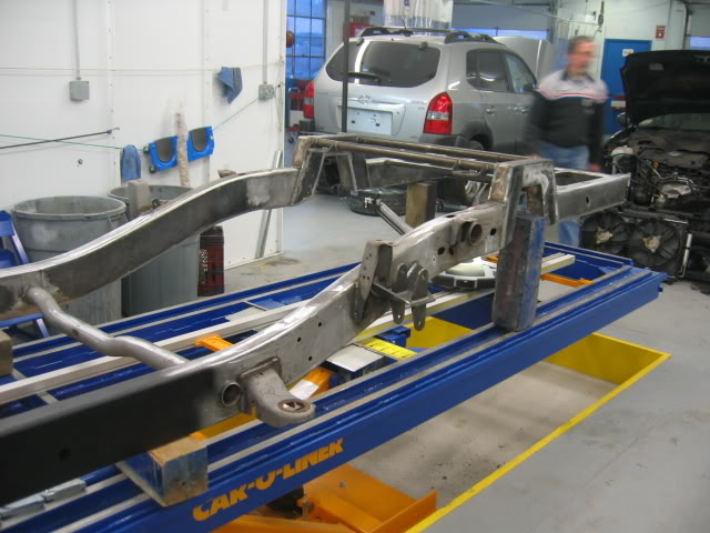

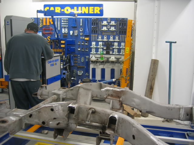

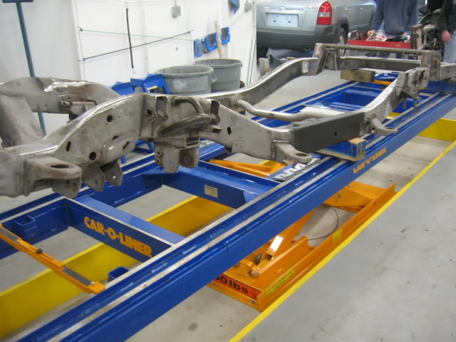

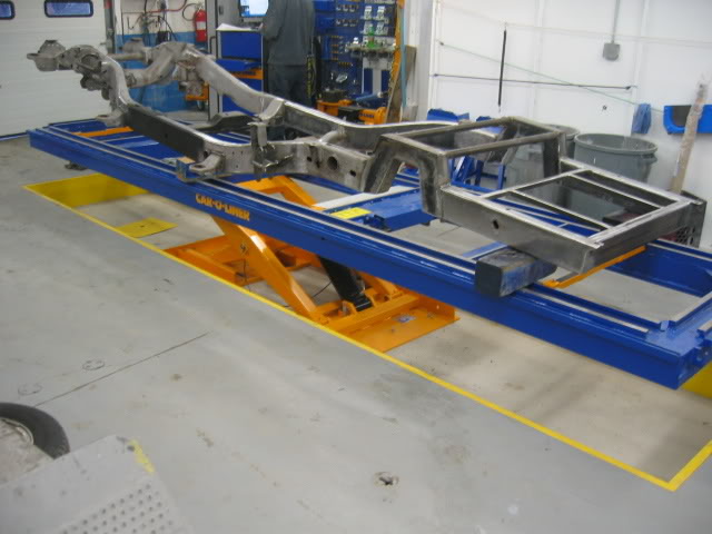

brought the frame to my body guy to slap on his brand new frame machine to make sure that thing is still in spec after all the heat and cutting that went into that thing.

Once I get the frame back I'll start to DA it and metal finish it, ready for paint along with getting the shock mounts on and rolling.
