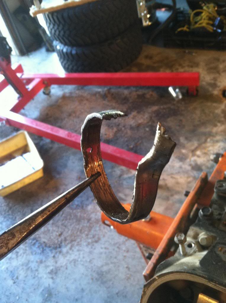

Welp, Found my oil pressure issue
149k 5.3l. Cam swap had 4k miles on it and 3800 of them were trouble free.
