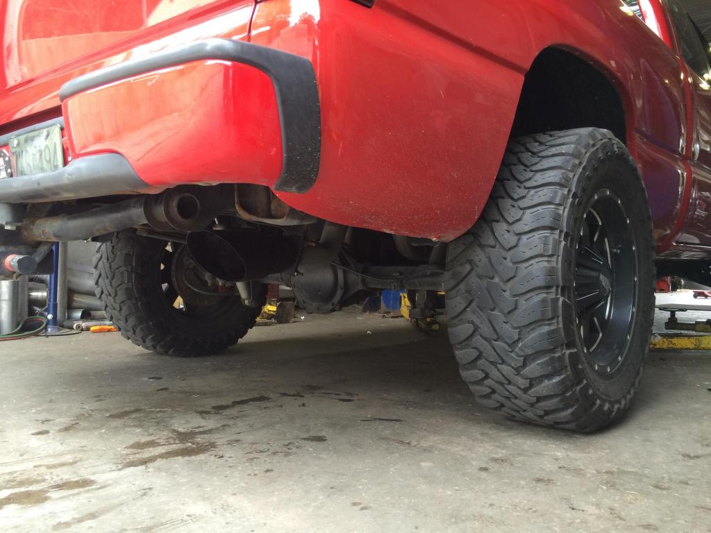

-CalSpeed LTs, ORY, single 3" cutout, 18" Bullet, then a 24" Magnaflow, tailpipe to rear bumper. Exhaust is very quiet which is what I wanted since I tow a lot.

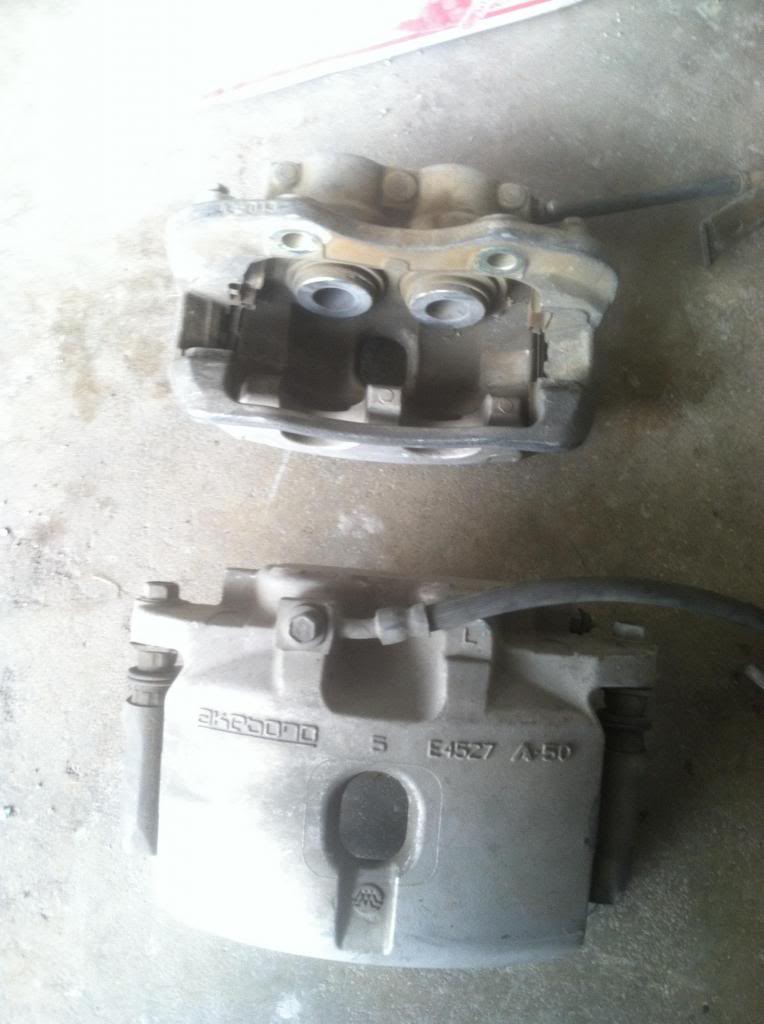

Tahoe dual piston rear calipers I got off a member. I cleaned them up and sprayed them red.

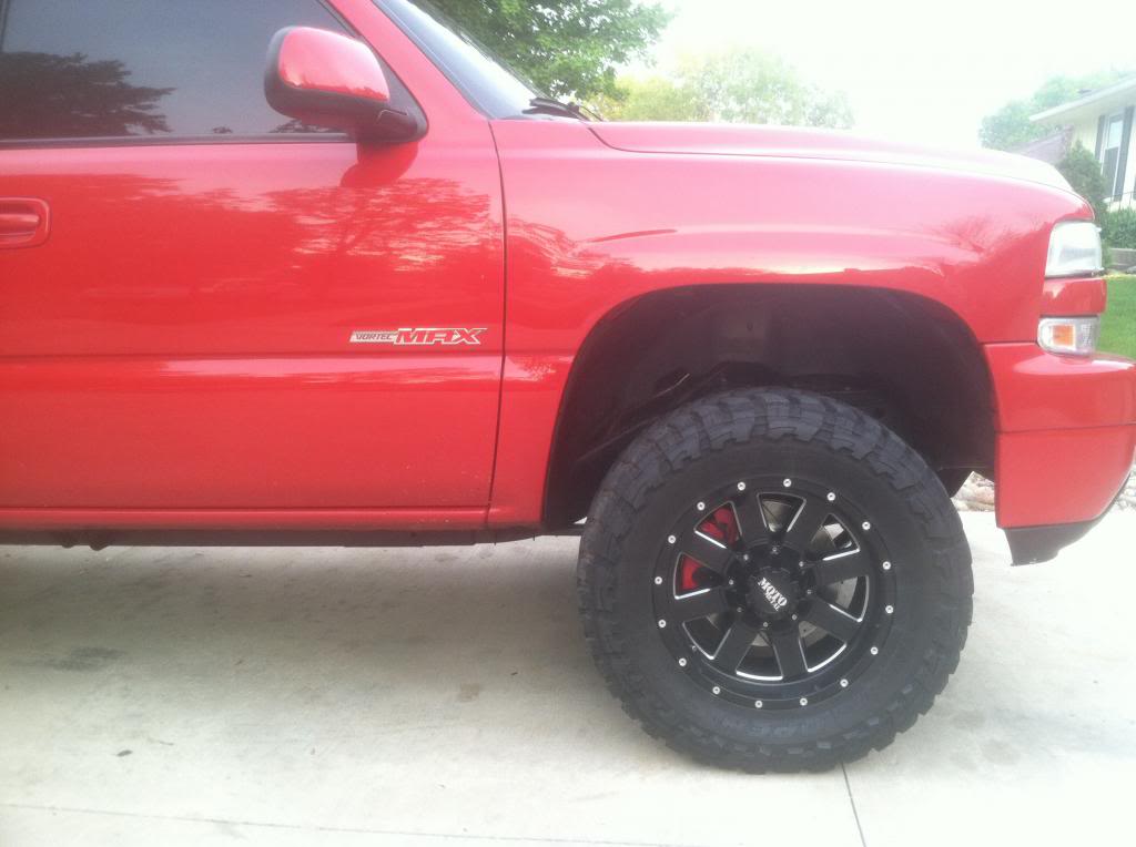

Parts: Powerslot drilled/slotted rotors, Russell SS brake lines, VortecMax badges

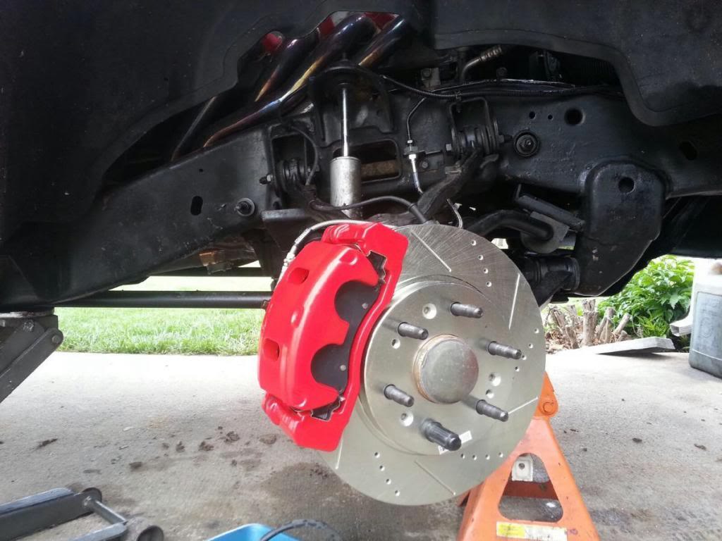

Front brakes- 05+ Powerstop calipers powdercoated red, SS brake lines, 13" rotors
Braking is MUCH better than stock. EBC sent me wrong pads, so I just used cheap Brake Best pads from O'Reilly's. Braking is still great, SS lines really firmed up pedal.

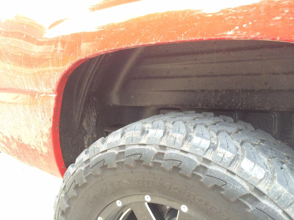

Fender liners. I think RuggedLiner makes them? They were like $82. Well worth the money.

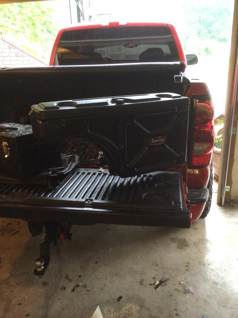

SwingCase toolbox. Can fit a lot of **** in it.

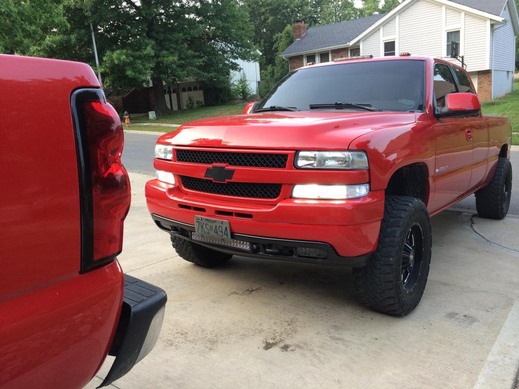

20" LED light bar. Got it off amazon for $45. 01/02 Duramax/8.1l valance with the opening in the middle, painted black.

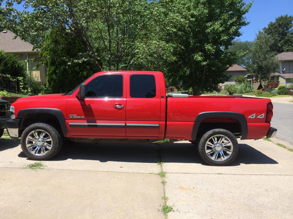

Pic when I got it cleaned up

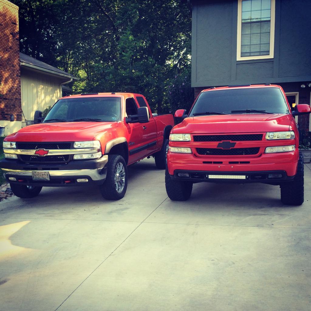

Pic of both of my trucks
