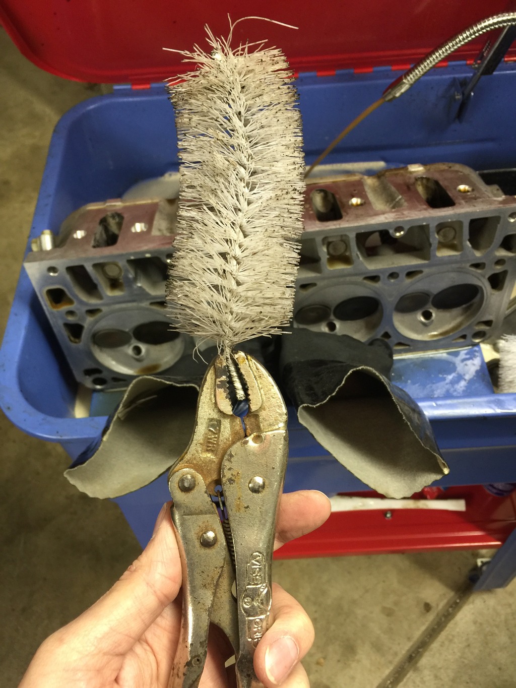

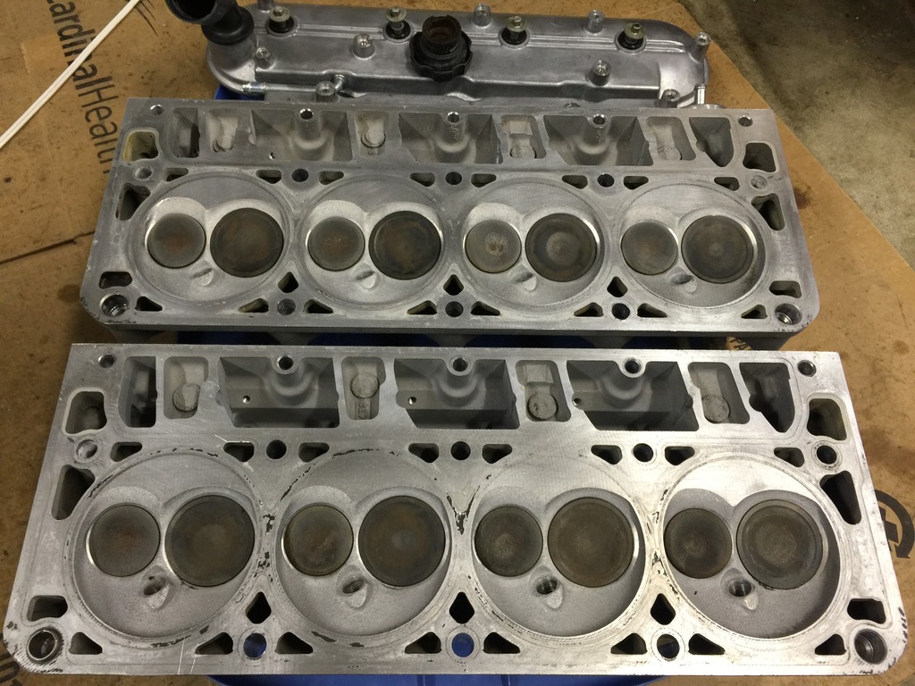

After cleaning up the heads some more, I'm thinking that a remote oil filter would get clogged in about 30 seconds. A trap type setup would be much better. I'll have to think about this.
I went to the dollar store and got a toilet bowl cleaner. I cut it in half thinking I could bend half out of the way and clean the intake runners. It broke immediately.
So I used some vice grips.

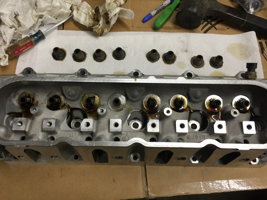

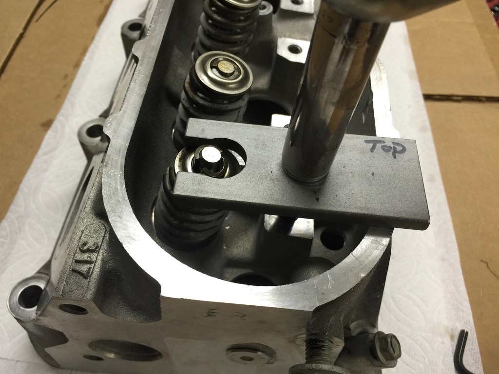

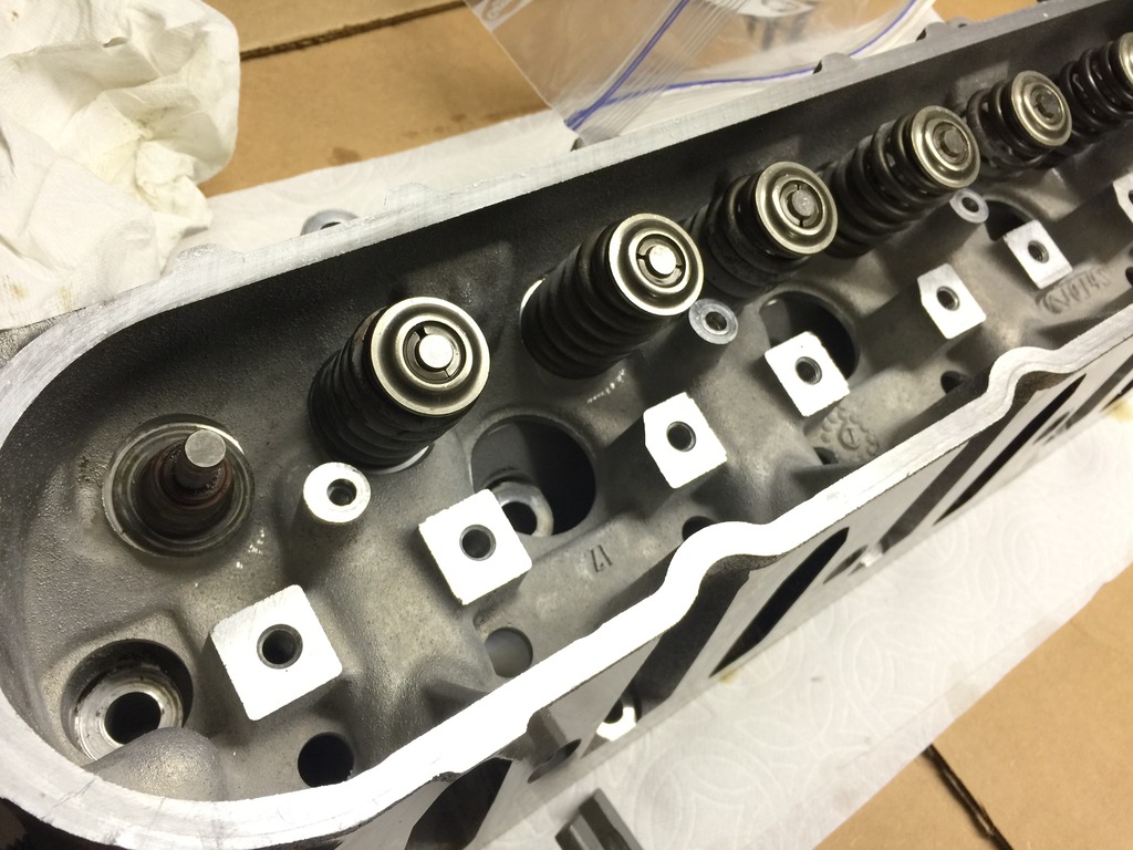

This is as clean as I could get the intake runners. So I decided to remove the valves.
I bought this high tech tool a while back.

Even after soaking for days there's still oil under there. Not complaining, just surprised.

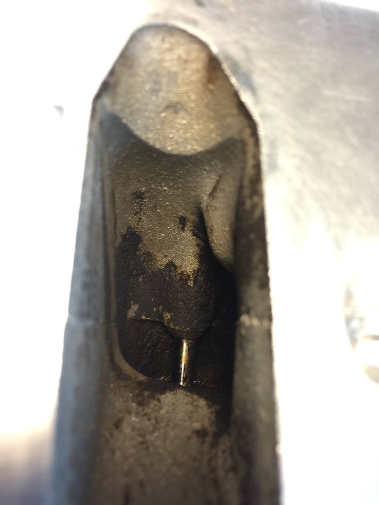

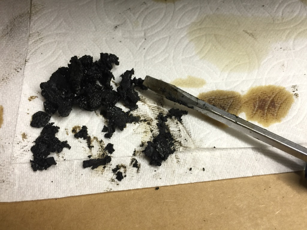

I scraped this out of one intake runner.

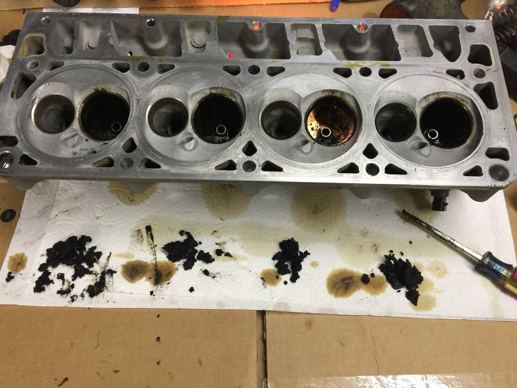

So I scraped out all the runners.

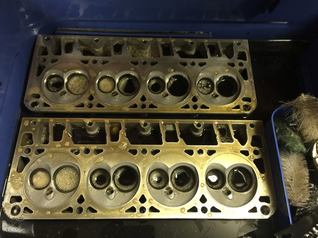

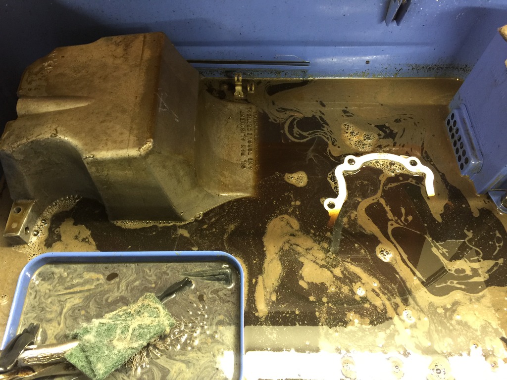

So back into the tank they go.

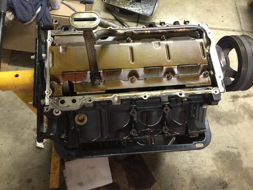

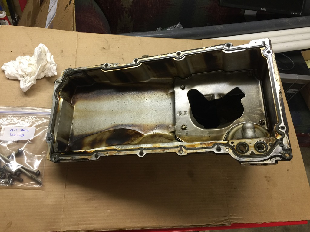

Took the oil pan off.
Turned it over.

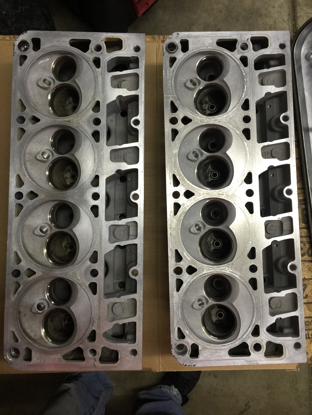

Back to the heads...

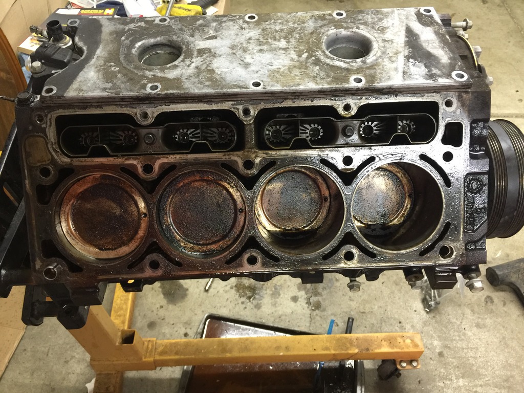

There as clean as they're going to get. I had considered porting them, or at least cleaning them up a bit but then decided I didn't want to spend 30 hours on the heads. Well, at least they're clean.

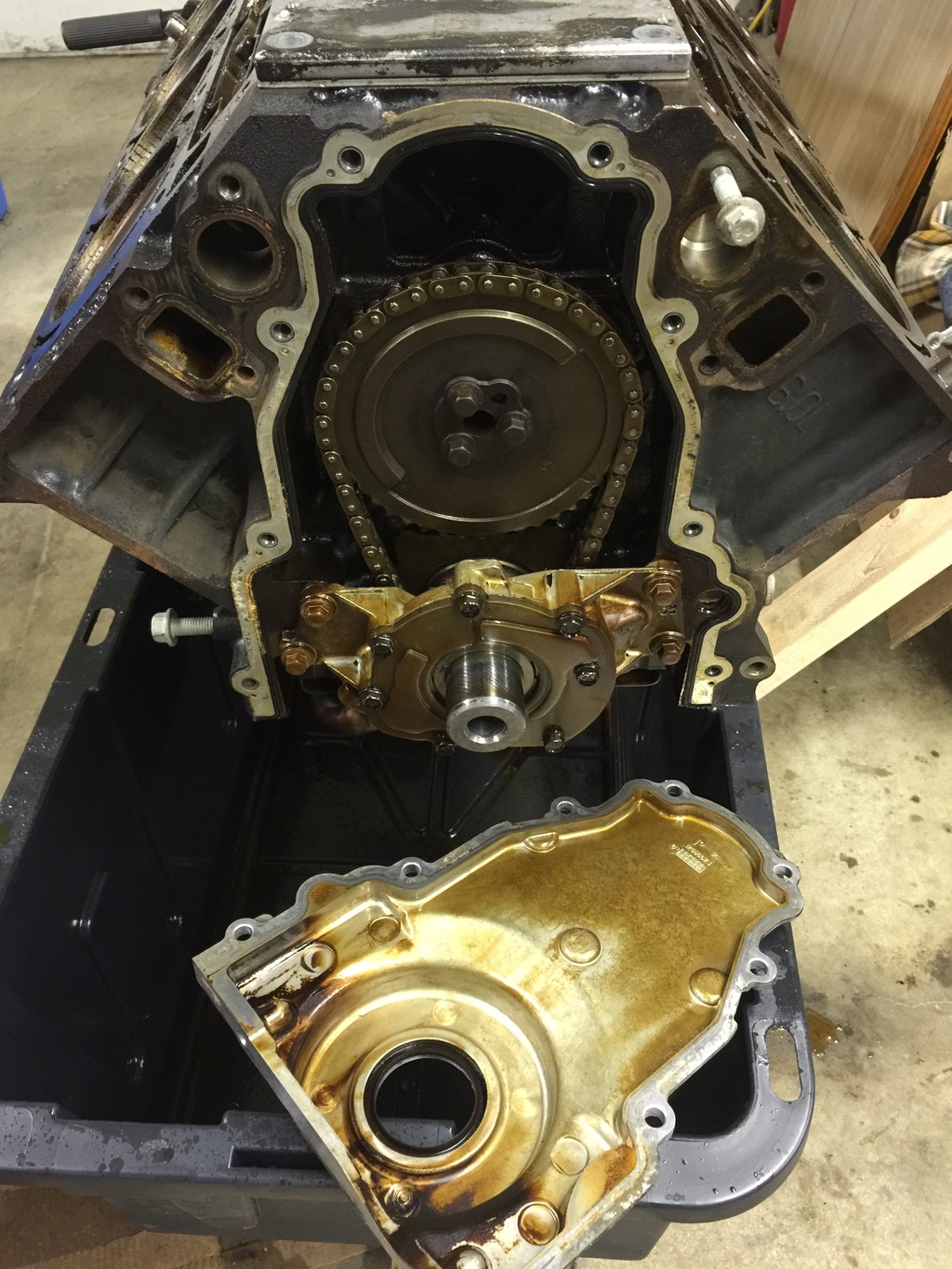

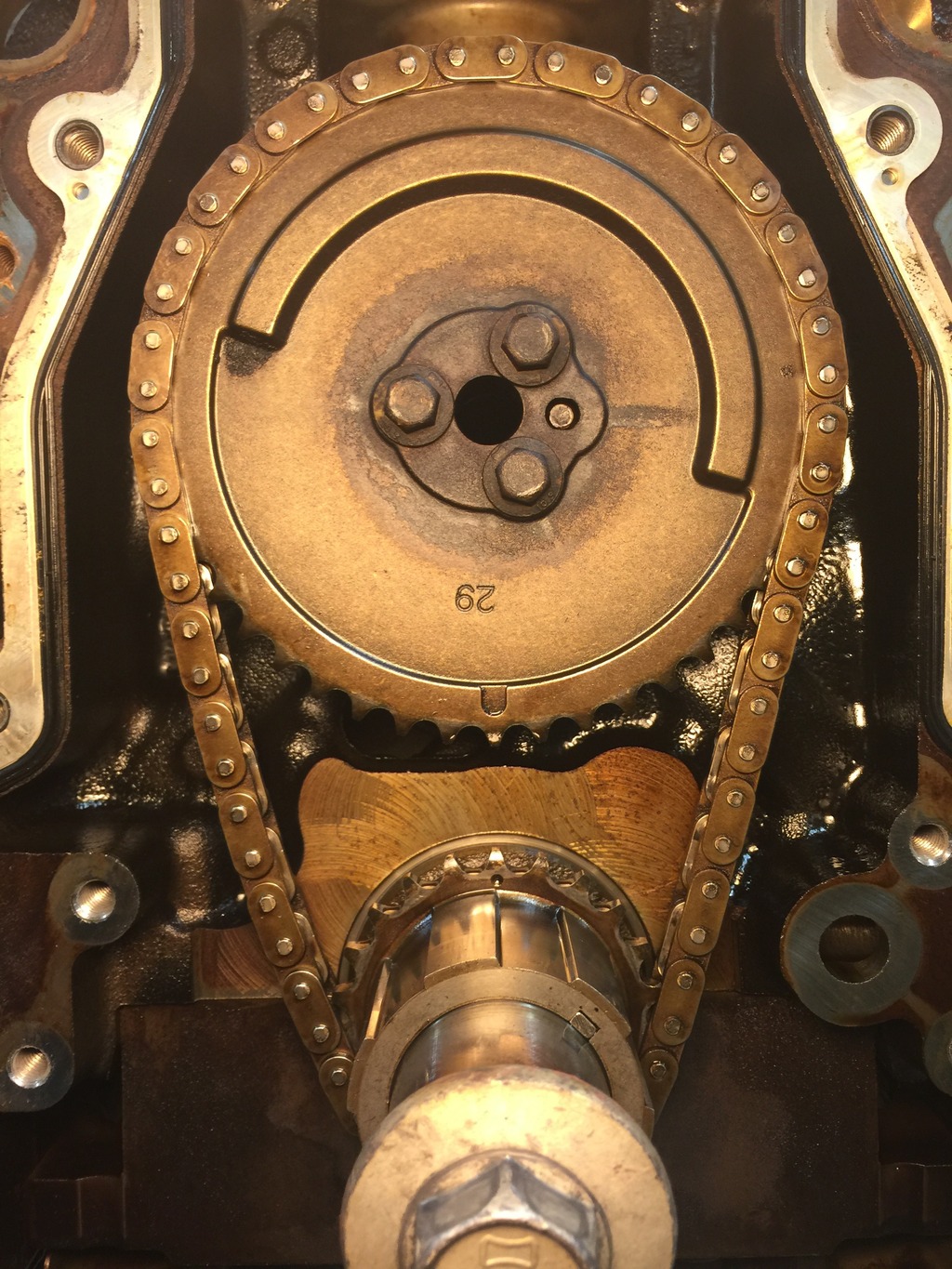

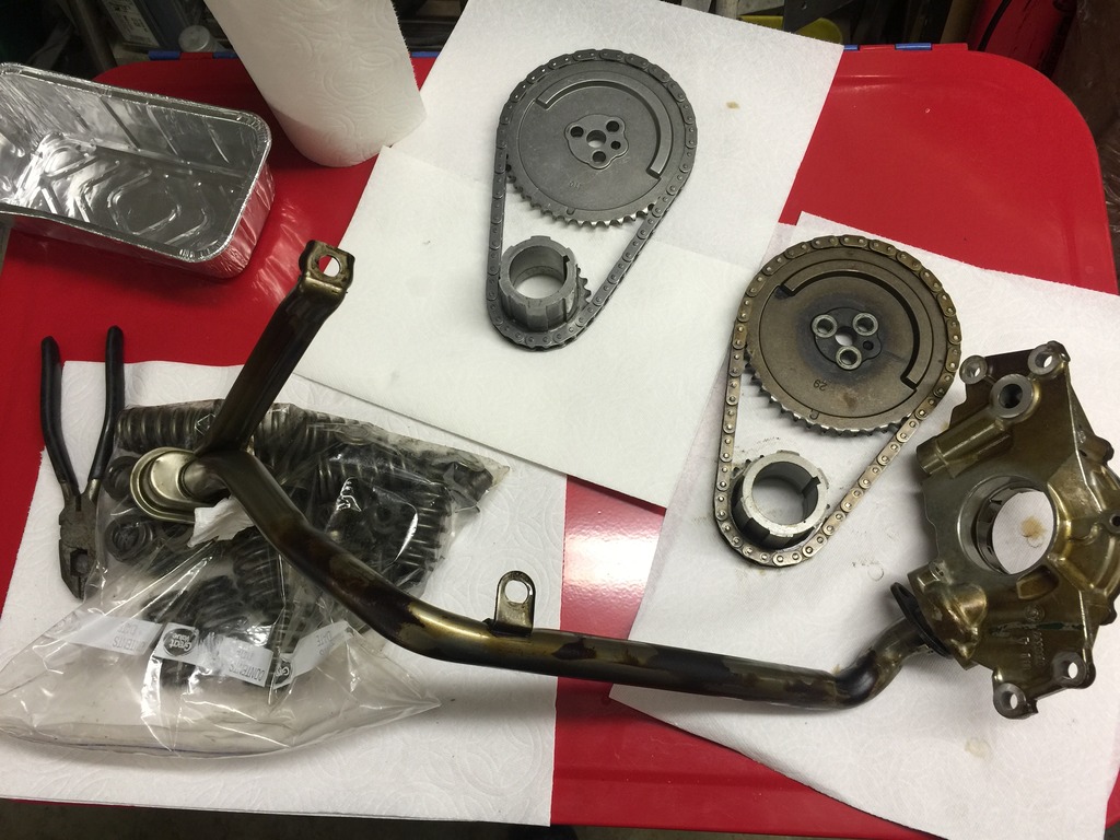

Removed the oil pump and pick up tube and proceeded to spend a few hours removing the crank sprocket. It took a while to get the correct combo of linkages on my puller set.
I was surprised by how much slack was in the timing chain. I bought a replacement timing chain years ago. I'm not sure if the one I removed is all that bad.

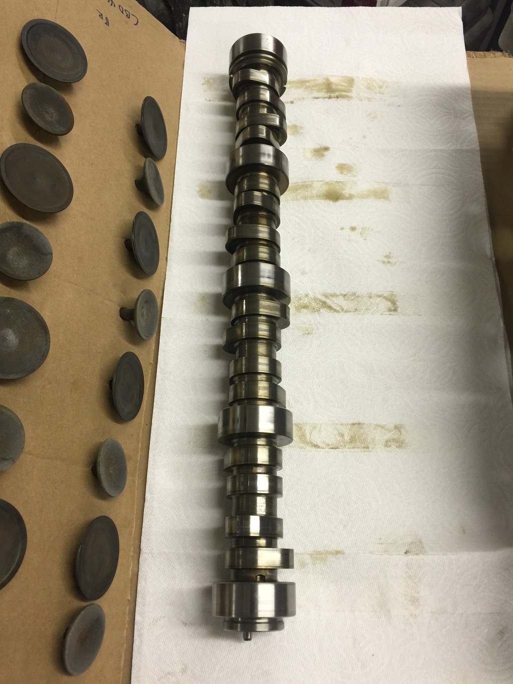

Next I removed the camshaft retainer plate and then the camshaft.

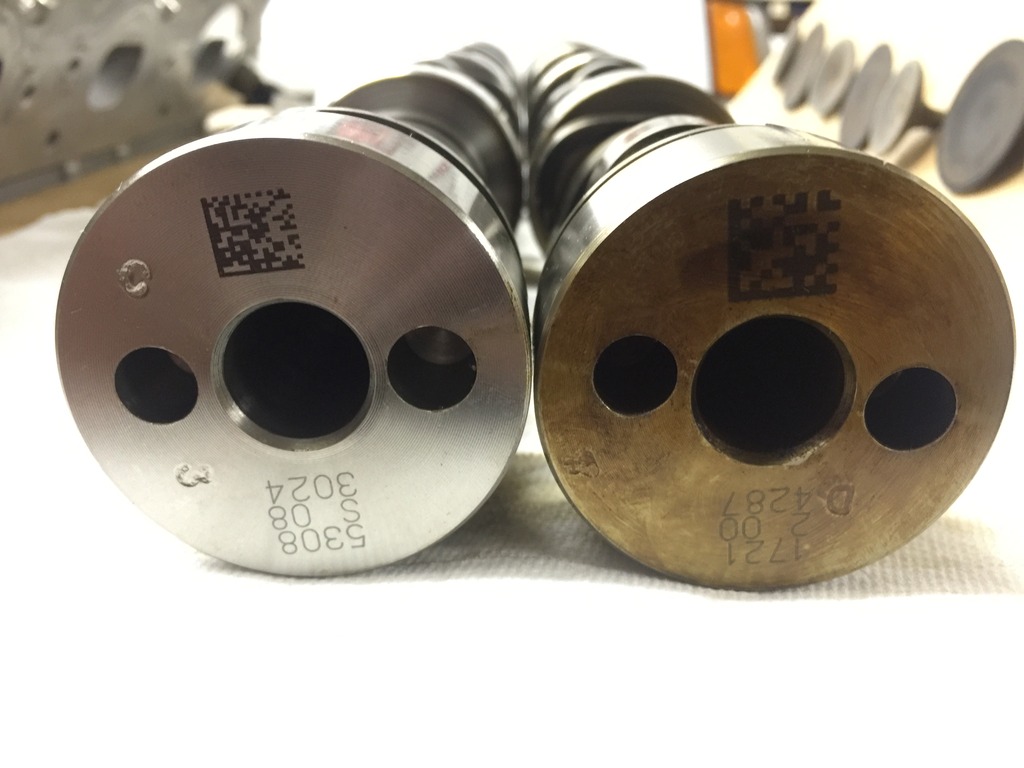

I lined up both camshafts but the picture somehow was screwed up. Here's a shot of their production numbers though.
Tomorrow I'm hoping to get the heads out back together and get the block cleaned up. I should be able to get the camshaft installed too. Hell, I might get the entire thing buttoned up. We'll see.

Yeah most of the stock chain **** I've ever messed with is pretty loose. No body ever seems to have issues with it though.
It seems crazy, but I guess it's normal.

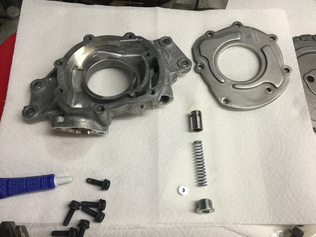

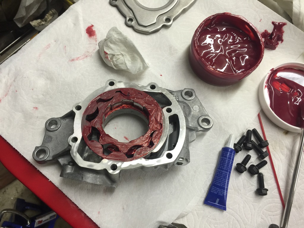

I ported my oil pump a while back so I made sure I cleaned it real well before installing it.
I added two washers, put the spring in, used some blue locktite and tightened it down. I'm sure there's a reason why I chose these washers, I don't remember what it was though. I guess we'll find out what I oil pressure is.
I put assembly lube in all the moving parts then put it back together.

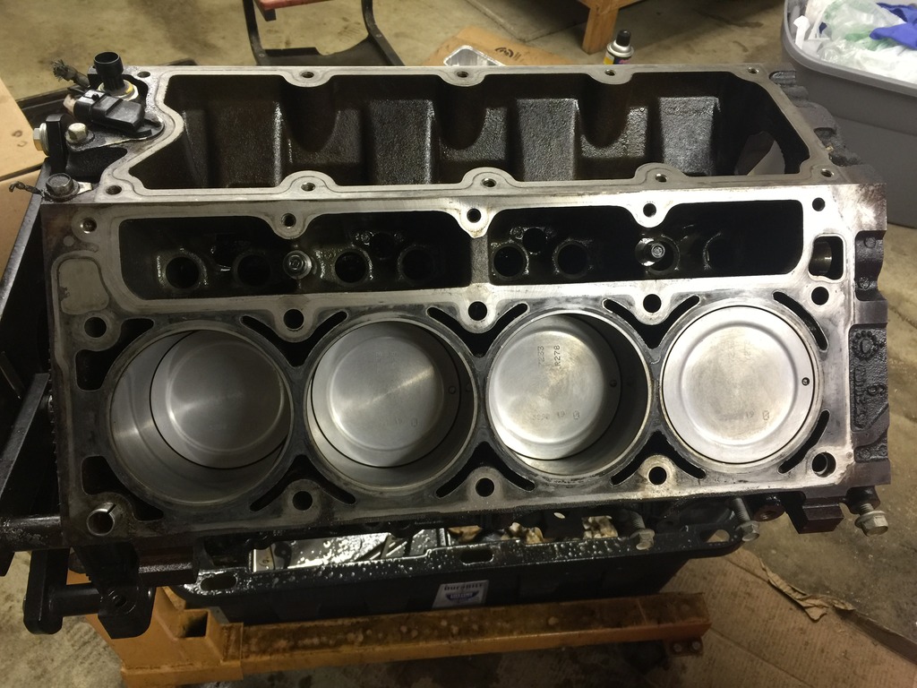

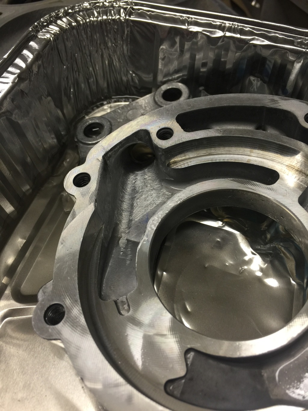

I used this on the engine and got it quite a bit cleaner.

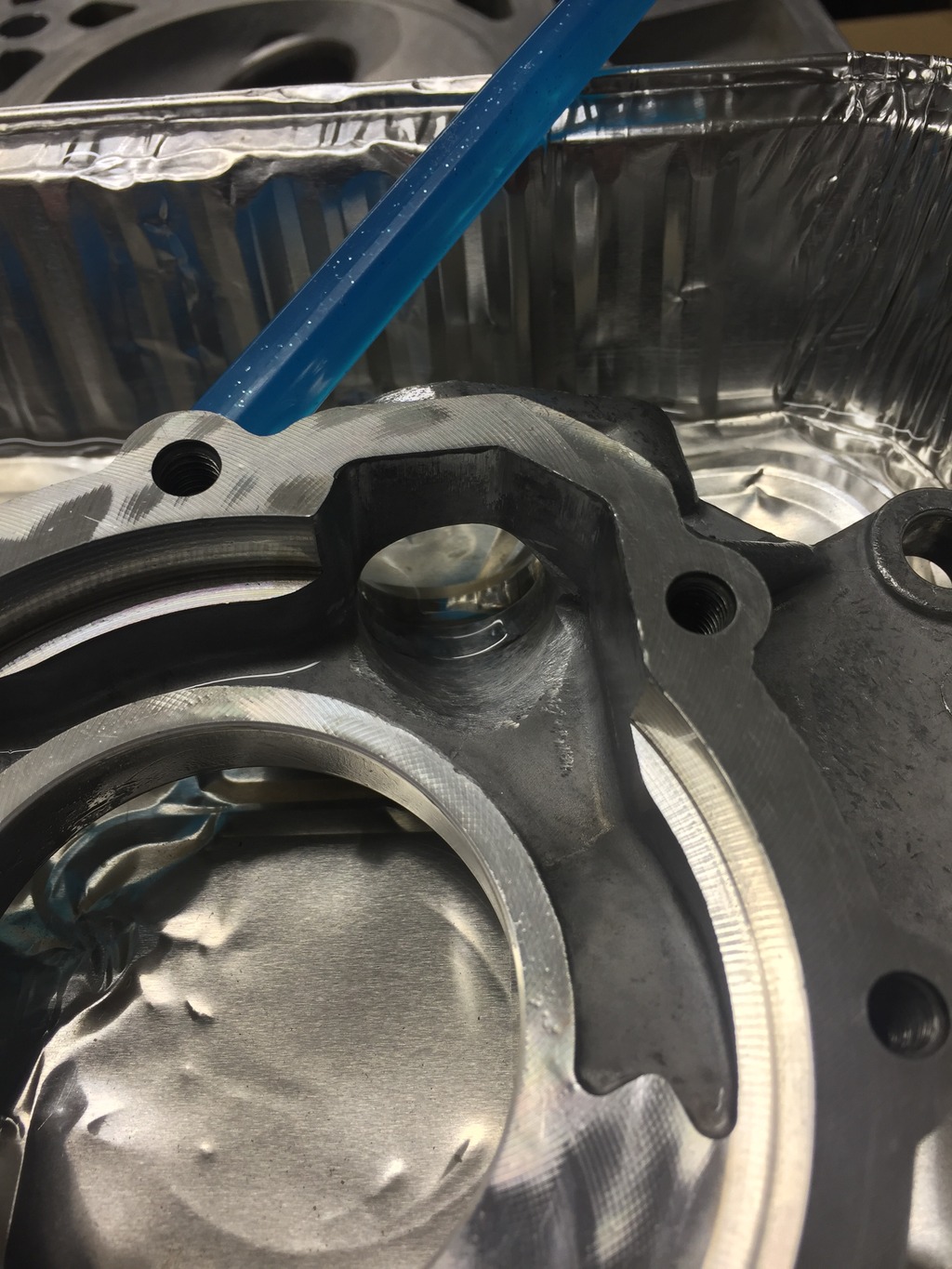

I still need to scrape off the rest of the head gasket material with a razor blade.
Put the oil pan and front cover in to soak overnight.
