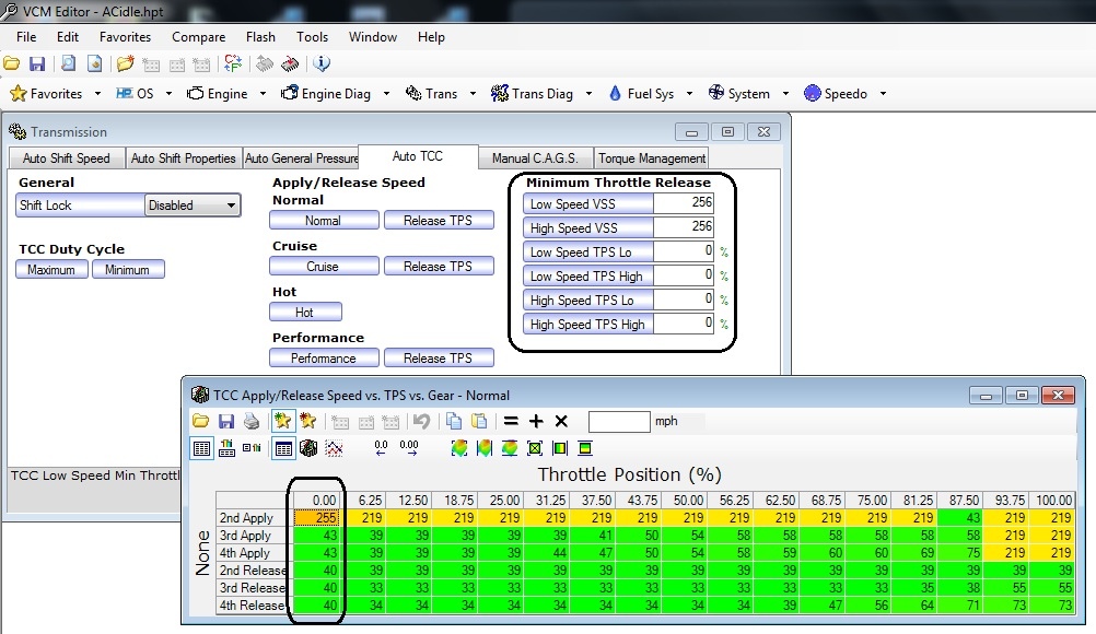

So, the segment swap is the way to go, and folks didn't want to do that because of torque converter lock up issues. So, they ran the 60E's factory tune with the relay mod. Now HPtuners let's you correct the torque converter lock up so the best route to go is segment swap. (Just thinking out loud here.)
So to make it so that the torque converter doesn't unlock you set the Low Speed TPS Lo & High Speed TPS Lo to 0% and change the 0% column in the Apply/Release Speed tables.
