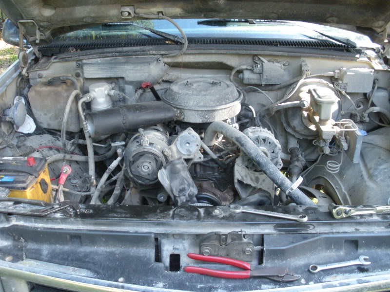

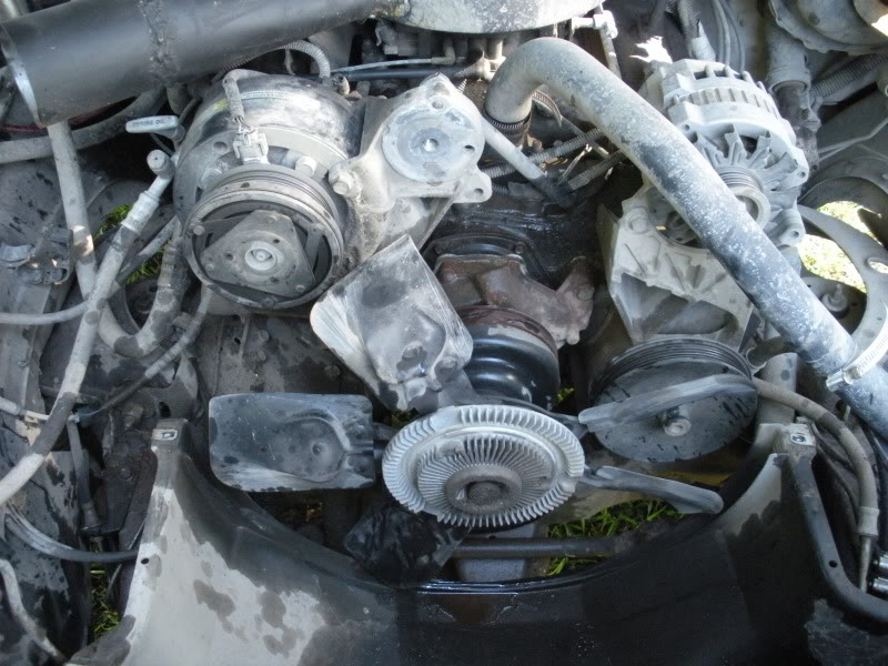

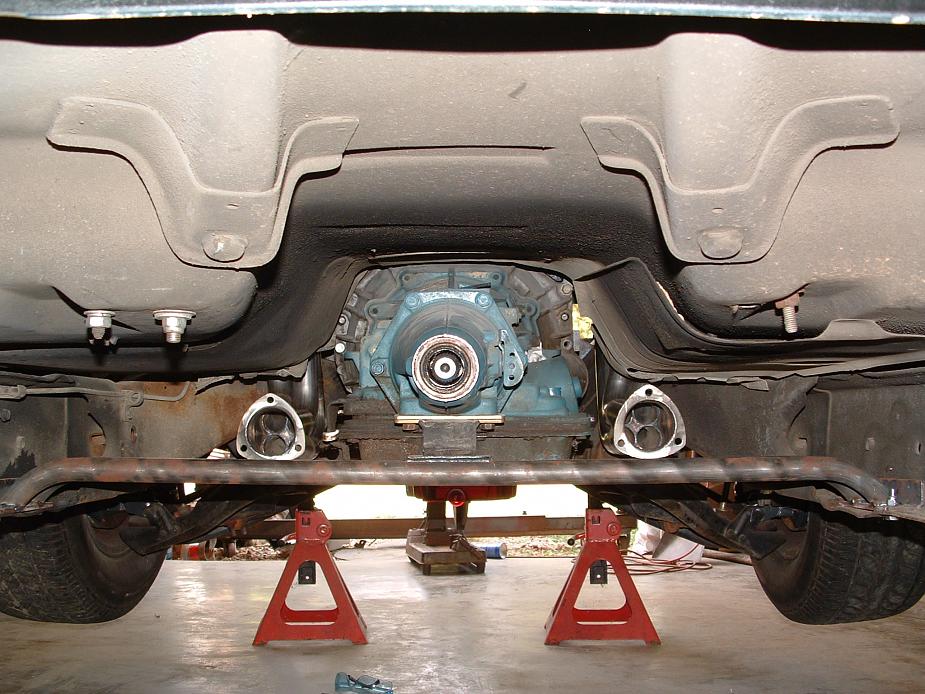

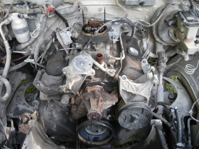

Old Aug 27, 2009 | 01:18 AM
iamkeniff's Avatar
Posts: 5,365
From: Gonzales, la
i figure another 2k ill be done and happy with the outcome of the truck.

thanks, the truck has been down like 3 weeks but havent touched it but a few days since its been broken. a lot of people find that taking the contorl arms down and such forth is the easiest way to swap out the v6 mounts for the v8 mounts. i decided to use extensions and a swivel socket vs fighting to get the coil spring back in.

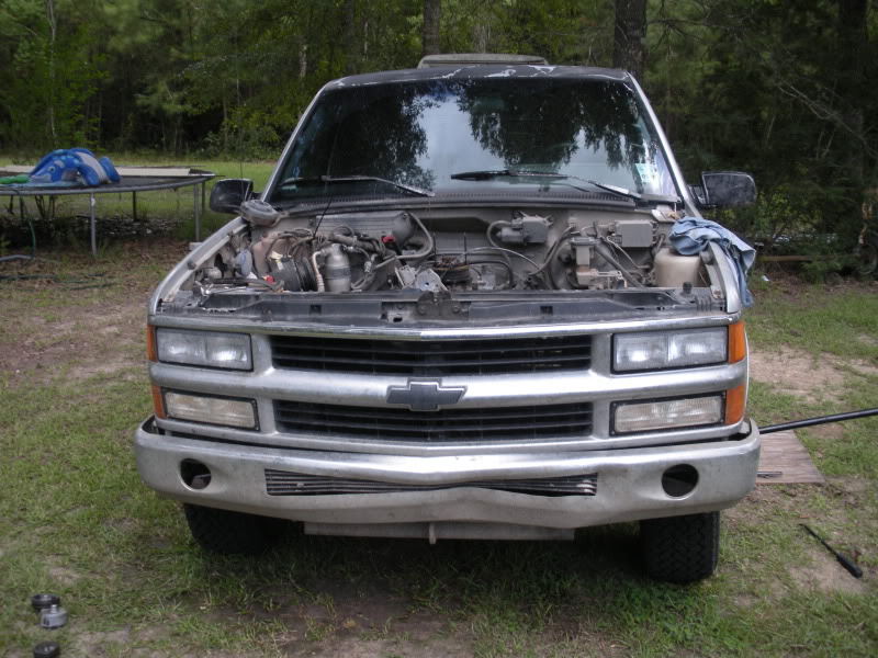

Heres one in a 88 chevy guys. Suppose to be a budget build to.
Same body style.

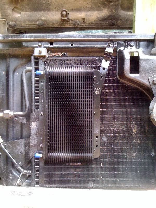

been on nights this week, so i havent gotten much done other than mounting my external tranny cooler.
there's one more bracket that goes at the bottom but i think this is gonna be ok so i'll see how it goes.
i want to put compression fittings on the cooler into a SS braided line and go to a -6AN fitting into the radiator cooler that way it looks cleaner than the crap that comes with the cooler itself. the cooler isnt very big but then again im not running a huge cam or a large stall (TB Stall) so i think it'll do. only had to drill 1 hole on the left of it to mount to the AC Condensor and a hole in the bracket to mount to the cooler itself. so it was really simple.
i should be picking up my motor and tranny tomorrow but it'll be on a pallet for a week bc ill be on days this week coming. but while i wait on my stall and adapter plates to arrive ill go ahead an do the servos and shift kit. i want it to shift firm at part throttle and firm on the WOT. i just dont want it to snap my neck everytime it shifts at part throttle.
