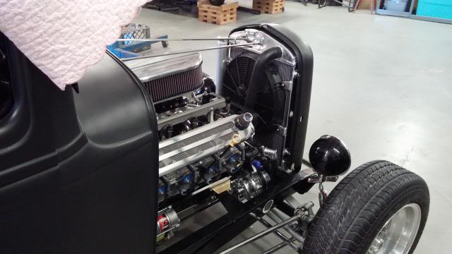

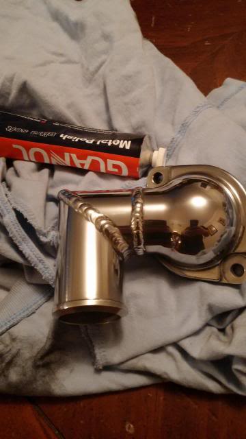

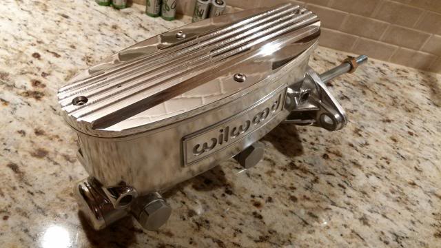

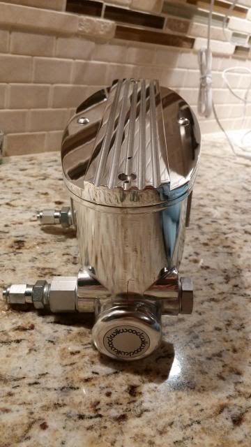

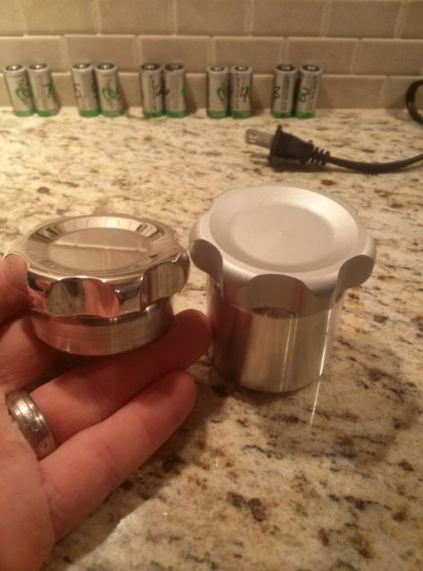

A few polished items and the master cylinder cap we made to match the air cleaner top.

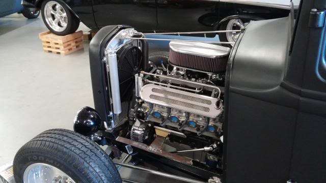

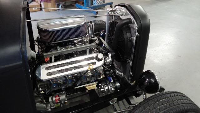

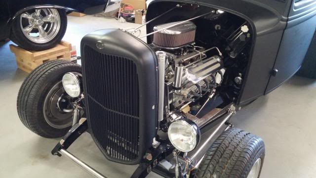

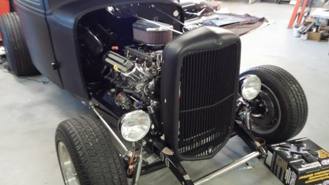

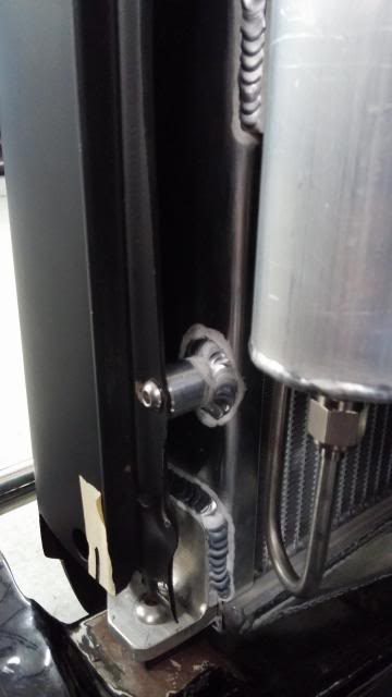

Radiator is finished along with the overflow tube and the grille mounting.
Also this bad boy arrived.

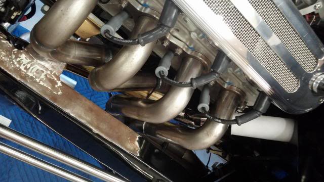

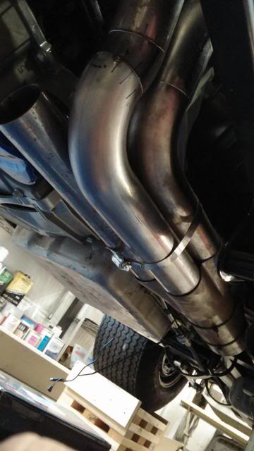

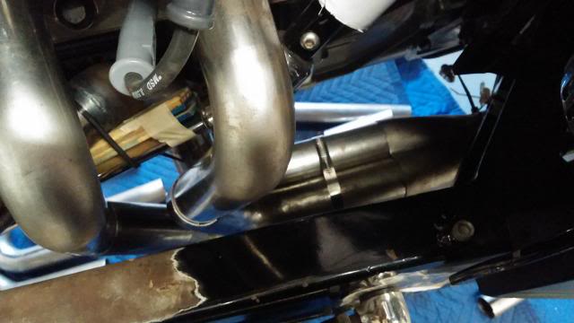

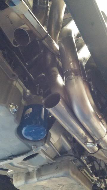

Also started on the headers. The start of the primaries are 1.750" on the shortest run it is 8.75" and the longest it is 9.125" then they step to a 1.875" then go into the collector. All the steps are hidden by the frame rail to try to keep the number of visible welds down. I have about a 12% length difference from the longest to the shortest primary. I wanted it closer to 10% but the space I have dictates where the tubes can go.
PICS

Thanks man. I have 6 hours into what you see on the headers. It helps that we build a lot of headers and these have been the easiest set that we have tackled in about 2 years. The tubes haven't been too fussy ......YET. Now that I said that I know something is going to pop up
