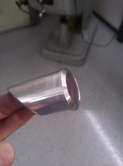

After much thought I cut up the thermostat housing and we made some parts on the lathe. This will be a huge help in getting the outlet of the radiator hooked up.

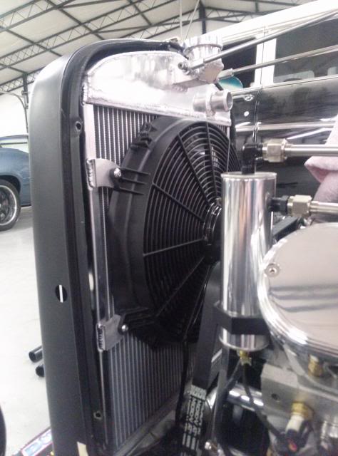

Small update. We have been working a little bit on the radiator and about got it finished up.
Tanks, Filler neck, and hose inlet and outlets welded up.

Made mounting tabs and got the condensor mounted and got the fan mounts made and welded.
got the frame mounts done and the thermostat welded up. The upper and lower hoses are fitted. Next will be mounting the grille and making an overflow tank then the cooling system will be done.
