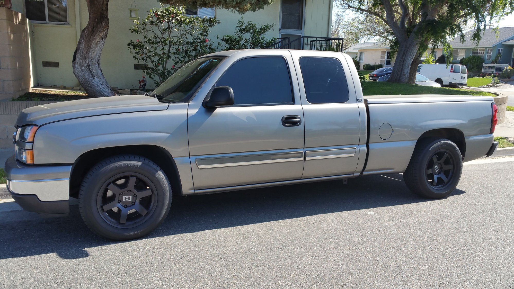

Well unfortunately the shop that was supposed to install my gears this morning had to postpone because they are racing in Fontana this weekend. So, I'm going to get the front windows tinted to match the factory tint on the rear windows later today.

askingxforxit's Avatar
Joined: Aug 2016
Posts: 63
From: Lake Forest, CA
