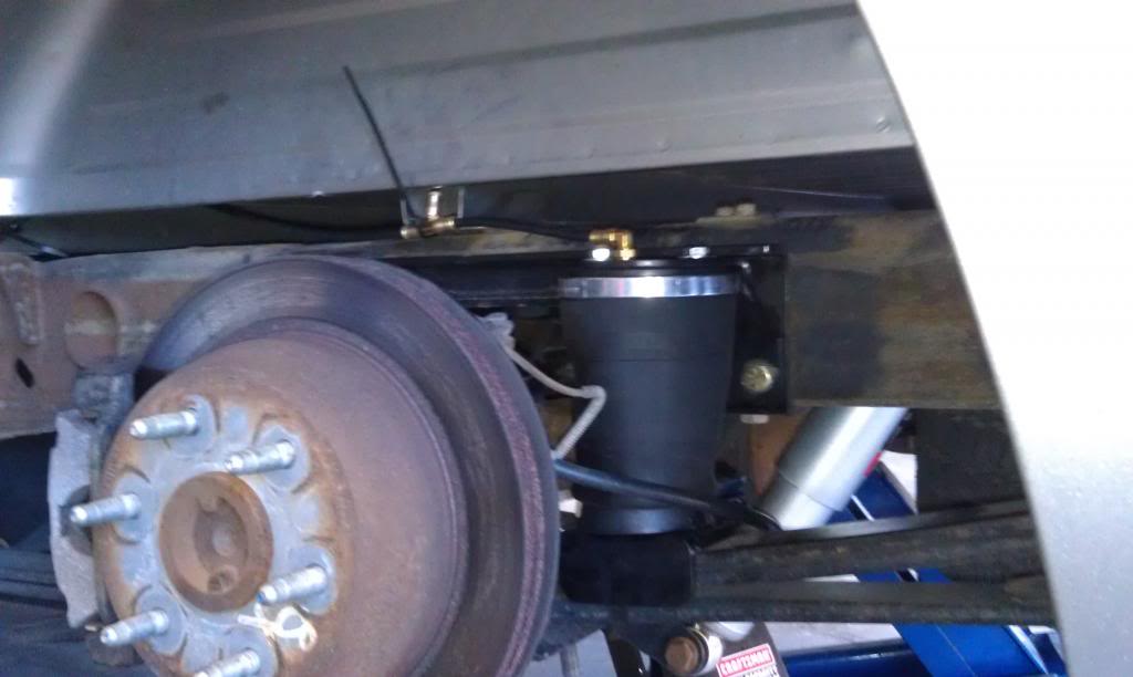

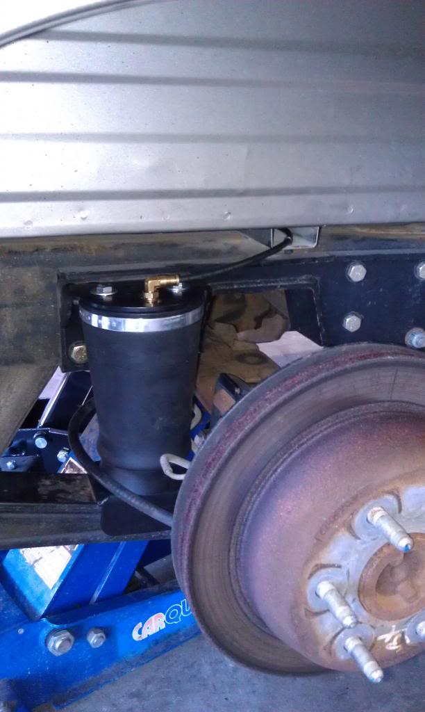

well im slowly having parts trickle in. waiting on valve springs so I can do the cam swap. got hp tuners pro, and went to install my helper bags but I need longer u-bolts, which came in on Wednesday thanks to the generosity of member titled splinter. THANKS AGAIN.

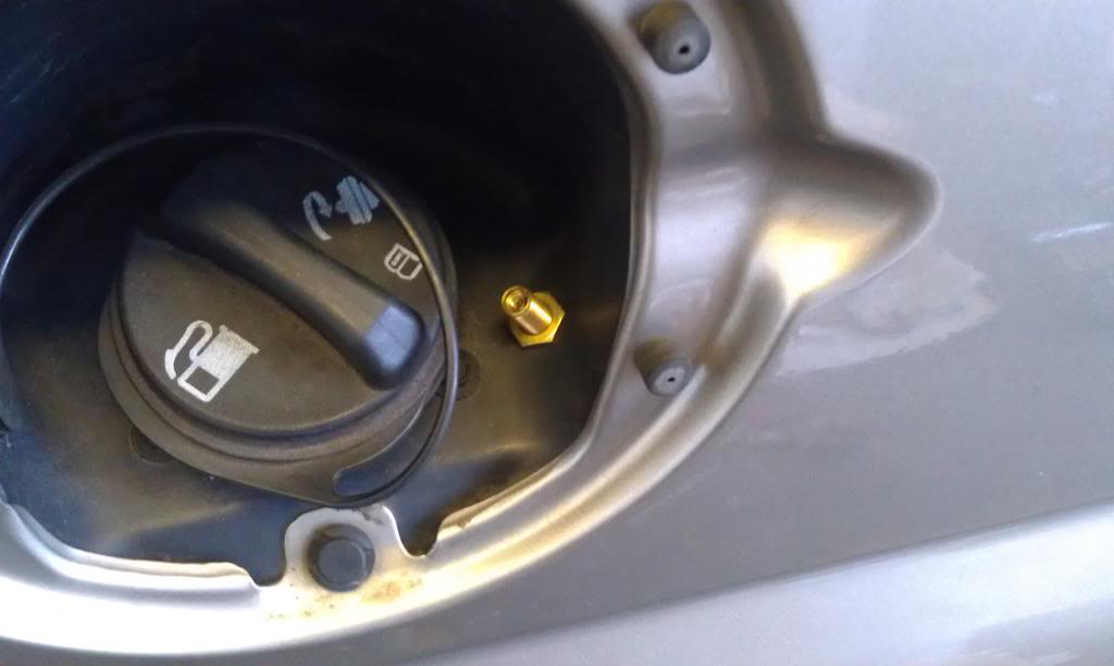

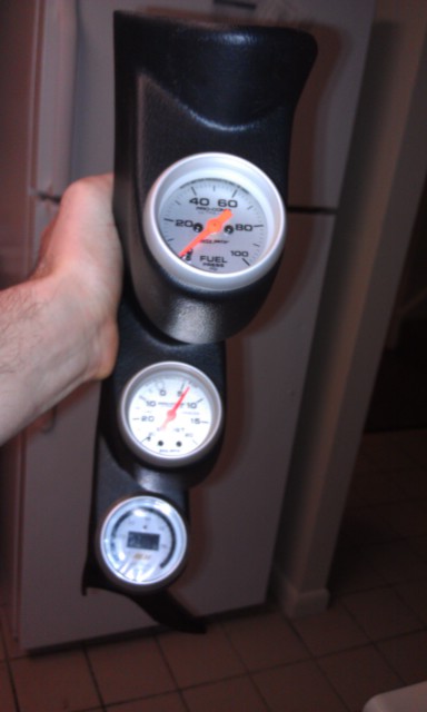

Well its been a while since I've had time to post my progress, but some stuff has still gotten done. I got my valve springs in the other week thanks to stock48, and splinter sent me a set of longer U-bolts he had lying around (THANKS MAN) so I was able to the get the McGaughy helper bags installed and plumbed. I can't wait to try them out Friday. I also wired up the lights for my boost and fuel pressure gauge to the dimmer switch on the dash. When I get home I'll get the wideband hooked up and the gauge pillar painted and installed.

I just got them off of summit. the AFR is the AEM eugo with the white face gauge and the boost and fuel pressure gauges are Autometer PN ATM-4301 and ATM 4363 respectively. They're 2 1/16" gauges and the pillar is autometer as well, PN ATM-17105. Unfortunately the boost gauge is only going to be showing vacuum for a little while, and that's NO FUN HA.

dude where did you get that valve for the helper bags? oh and about the muffle i have a cooks 3in race muffler and i love it.
