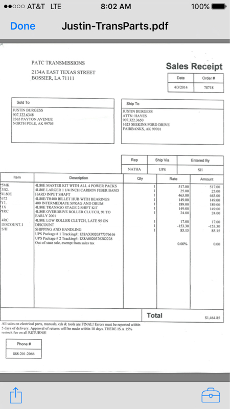

Got a call from Thompson Motorsports, my 370 block and 799 heads were shipped out today. I still need to find and build a 4x4 4l80 with out going broke. Any advice on 4l80 mods to handle 800AWHP on the street? Will a basic refresh with valve body, and HD clutches with a 3000 or 3200stall hold that or do I need to be prepared to spend $4k+ on getting it built?
This is what I put into mine. I have ripped the rear planetary apart once but I think it was just an old planetary.
I also have a 3200 precision multi-disk converter. So far that has been the most reliable piece in my drivetrain. Haha. And I used the same tranfercase adapter from timetokill.
