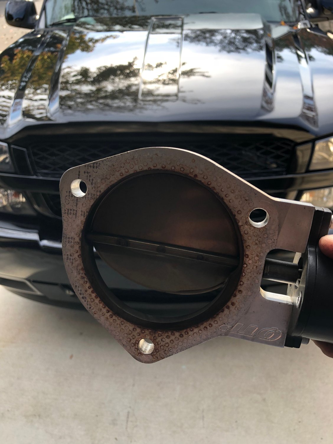

So this QTP 4” electric cutout lasted a couple hundred miles.

Yep, seen that before, lot of pressure from the turbo trying to run it hard with the cutout closed or sitting on the 2 step with it closed.
Well ****, lol I had no idea.
