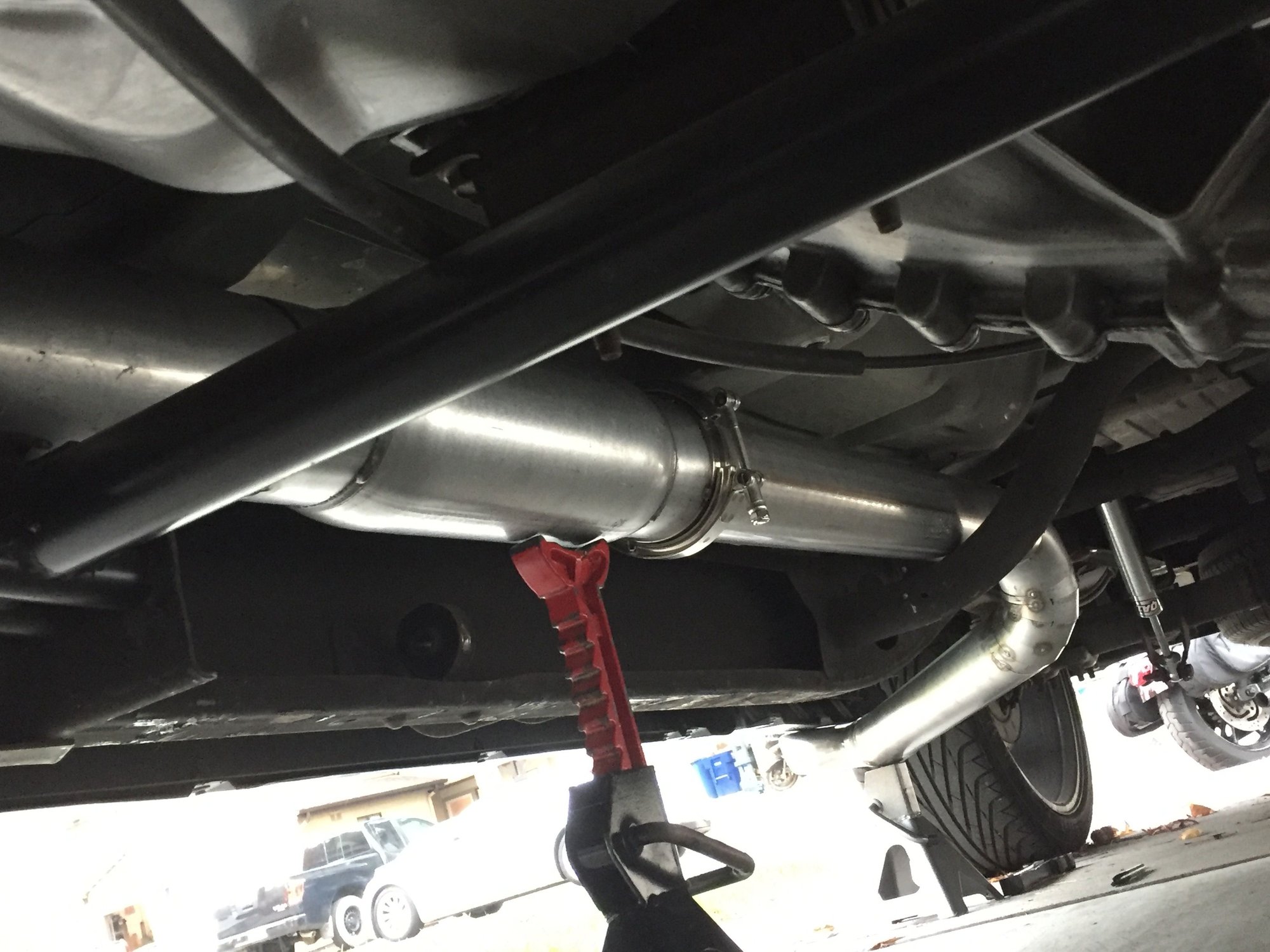

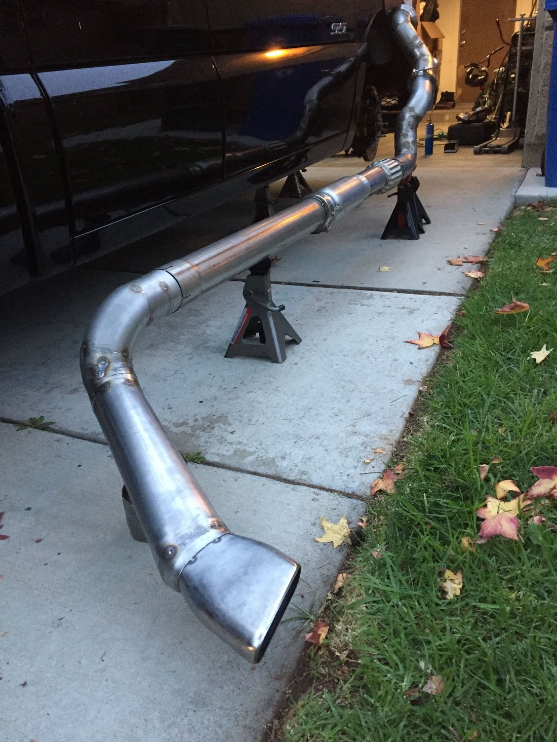

Thanks man. The brake upgrade works awesome. It’s been a while since I’ve posted. Retired from the Navy, moved to Ventura County, started a new job and back working on the build. <br /><br />Finally fabbed up the exhaust, turbo to tip. All fitted, tact up, ready for cleaning prep and welding. 4” all the way with a 12” dynomax and incorporated the stock SS oval tip with a side exit infront of the rear passenger wheel. Once I tig it all up, I’m going to Cerakote the whole thing with cross over pipe the same as the exhaust manifolds. A 4” downpipe blanket is in the works for the S bend off the turbo.

Nice, looks good. I hate exhaust, I did mine all custom stainless and it turned out great but it’s a pita. That will look good.
