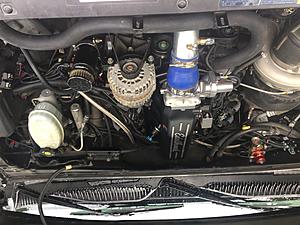

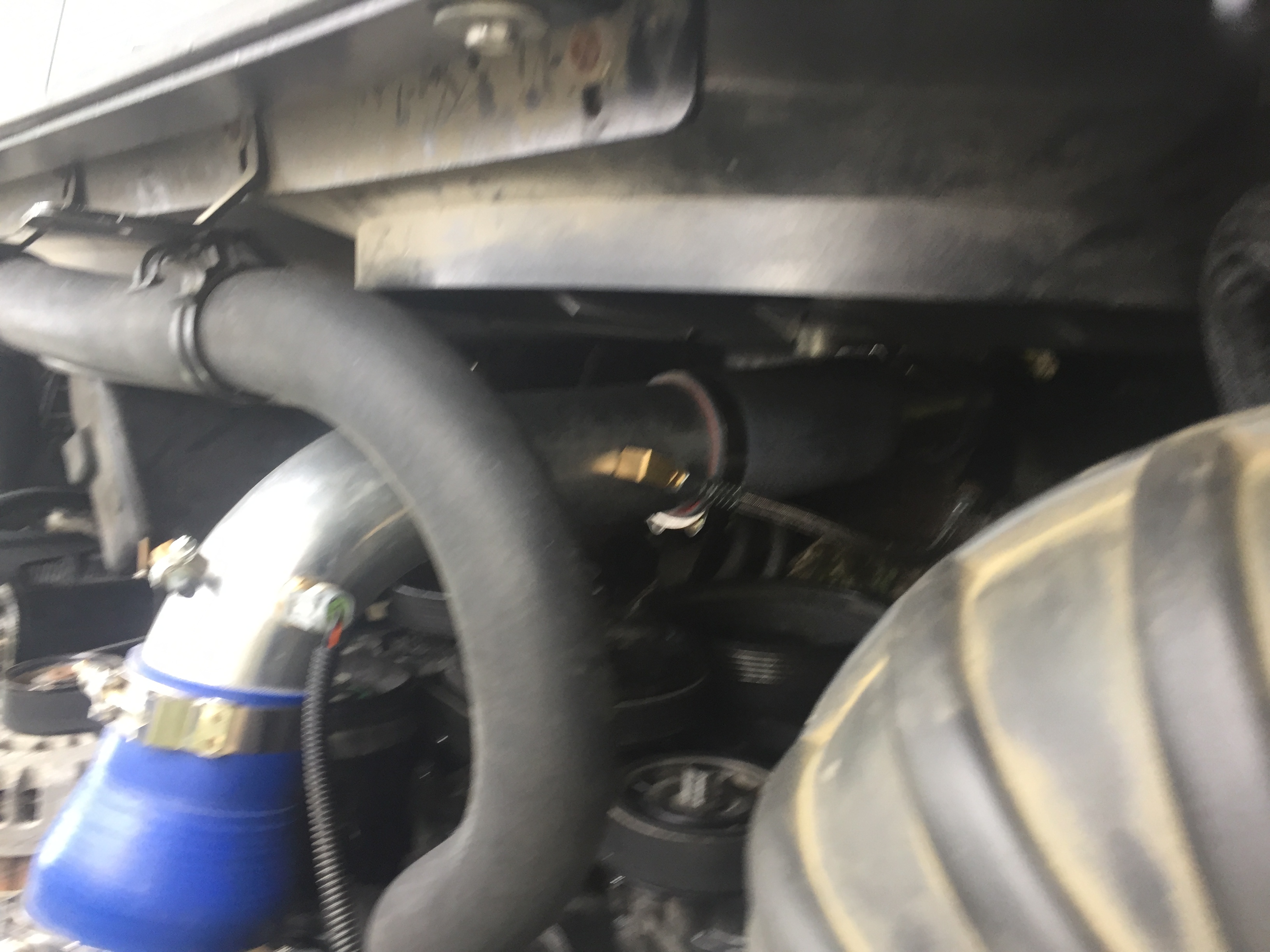

I just tried to look at my wires for the iat sensor. But I have cut my plug off and tucked the wiring into the harness years ago. Lol.
I put my iat sensor in the charge pipe just before the throttle body but after my meth nozzles so that the sensor would read the temp drop from the meth better. You can put the iat in the intake and yes it will get heat soaked. But it won't matter. It will only read high for a short while when you first fire it up. As soon as you start driving it will cool off.
That's why it is kinda nice to have a meth system setup with a primer or purge button. It cools down the air charge quite a bit.
