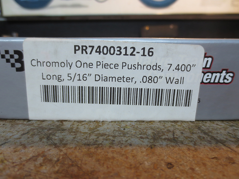

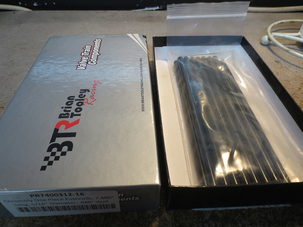

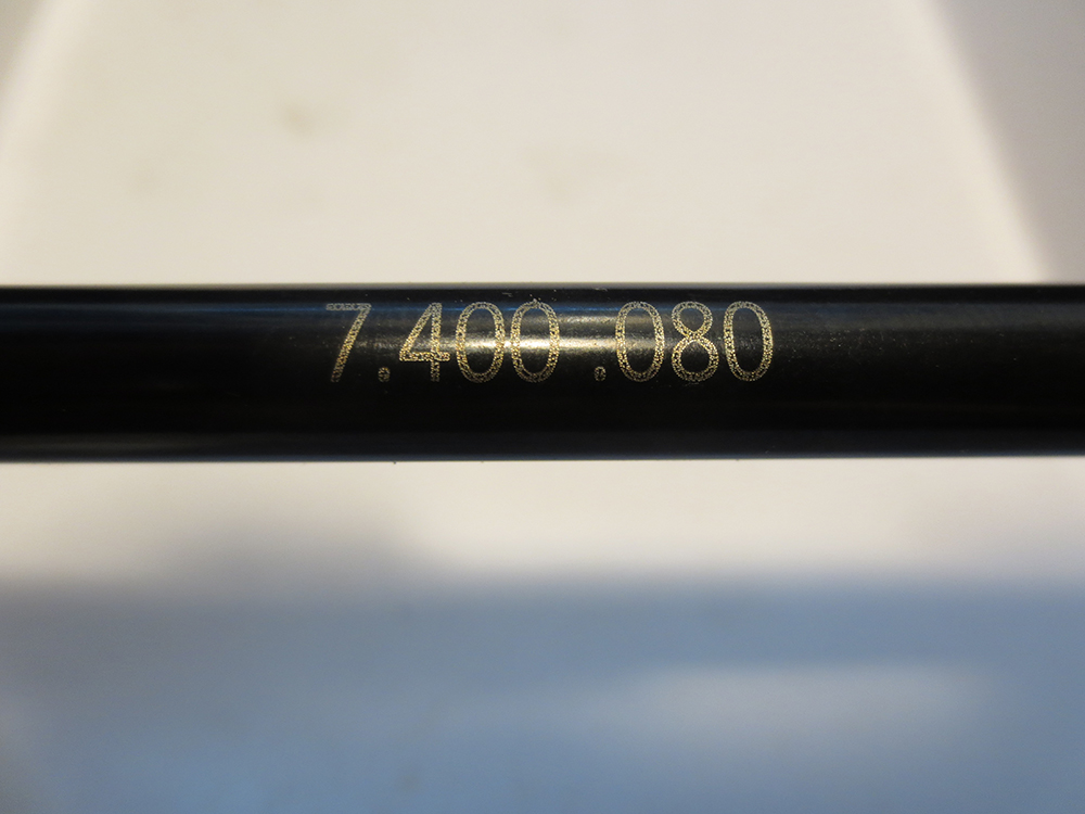

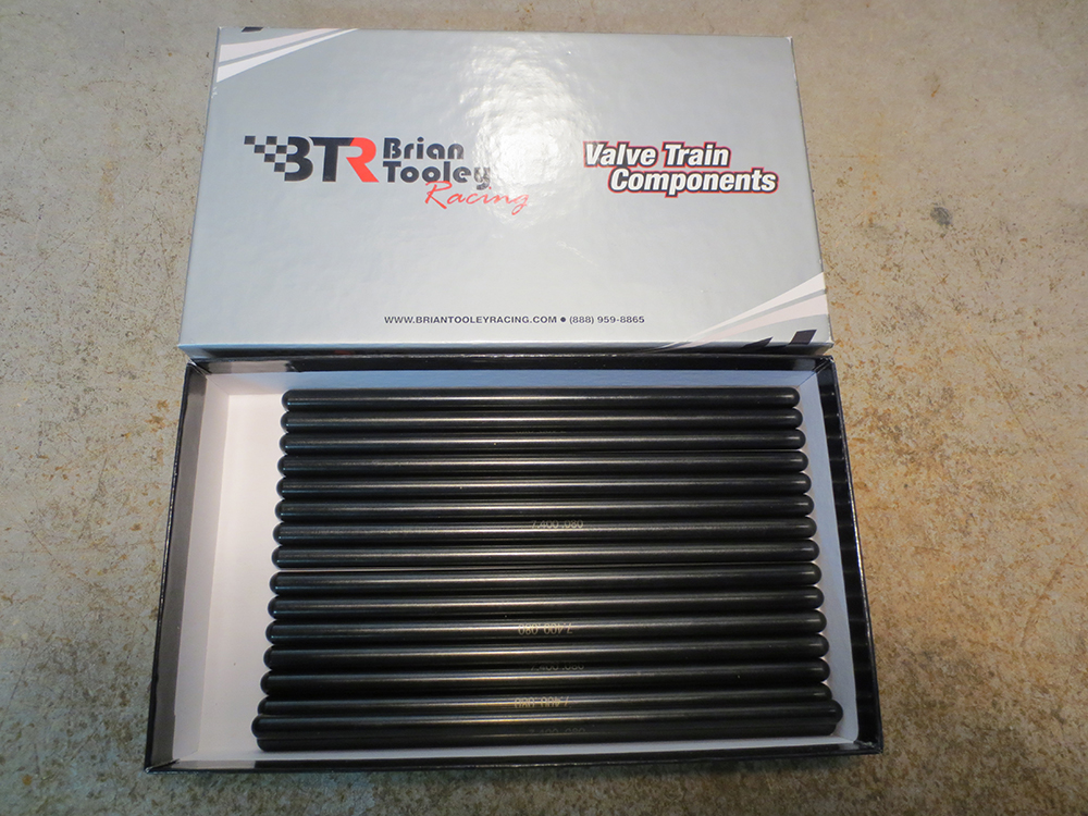

As a rule of thumb you don't get into base circle change until .600 lift and greater.
I have a like new set of BTR 7.400 that I no longer can use with around 2,000 miles. I went to a set of PRC (Texas Speed) aftermarket heads that required a longer 7.525 pushrod. I have them listed on Craigslist right now for $50 no shipping. If you want them I can do $55 priority mail... let me know.
