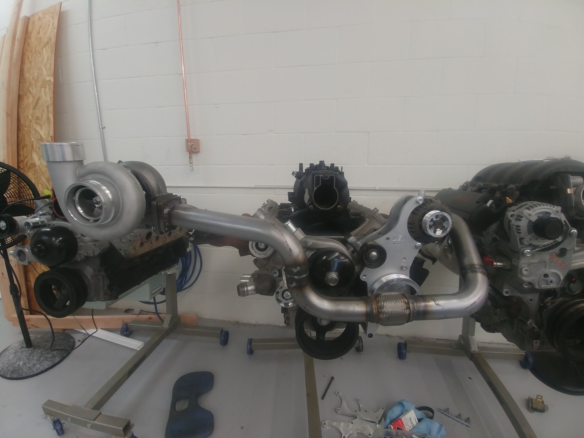

is that gonna fit in the truck?! ram air from behind the passenger headlight?
