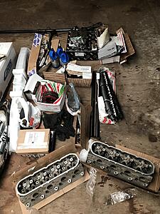

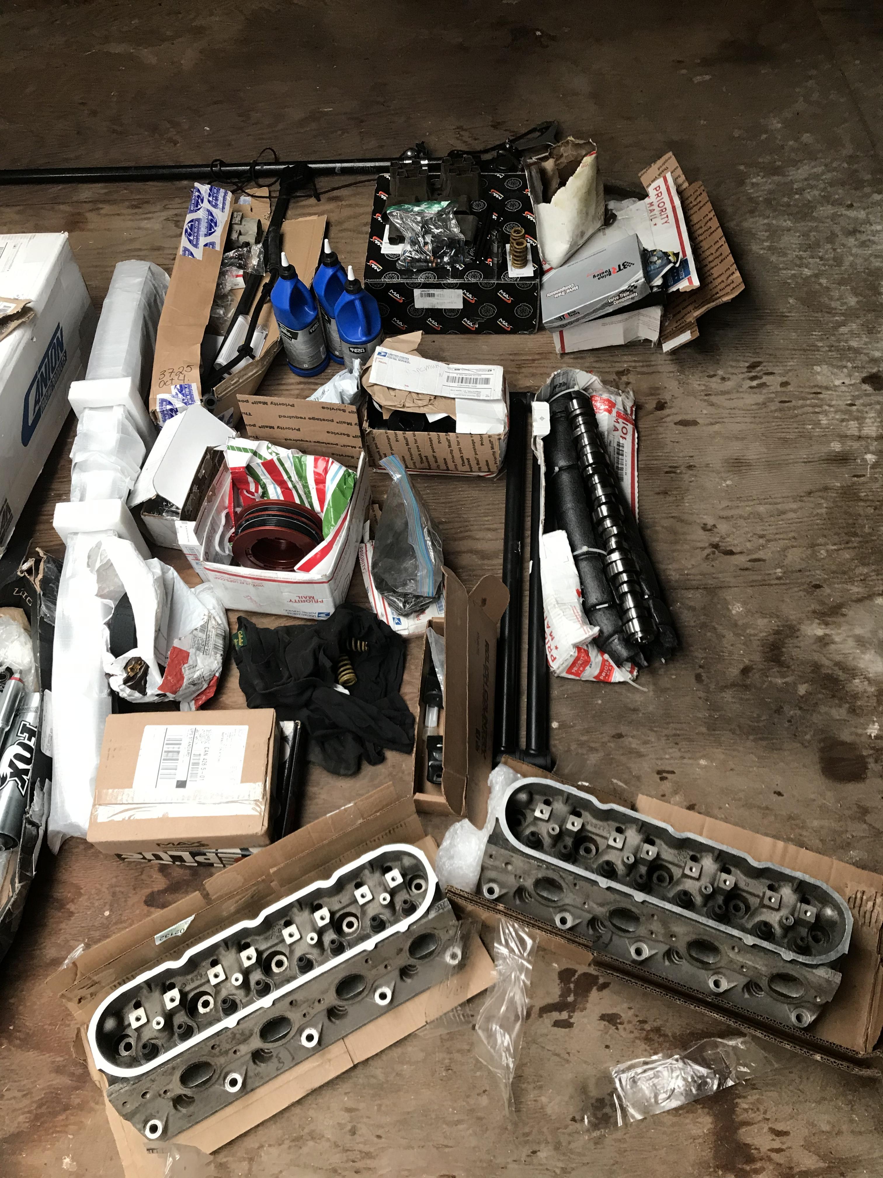

so the 06 will be getting a number of upgrades I have 6.0 (complete rebuild kit), 4L80e (hope to rebuild but is perfectly fine as is) including transfer case. All parts below for the 6.0 build. Looking for a few items stil 2800-3000 torq converter, need CNC 317 heads milled down, headers are on order, seeking cam options as 218/221 116LSA I don’t think will cut it. Just like everyone else, I’m on search for a Supercharger or Turbo package as I’ve put 5 different turbo setups in my summer ride and I think having 2 blown autos just seems like a must have. Other issues I’ve found is the ruby BBK kit was a complete waste of funds. No offence but 20” wheels on a truck? What is this dodge?
parts for the 06 not including a few item

Im sure I’ll questions along the way. I know the search function has answered lots already. The head milling, compression adjustments and cam selection still evade my knowledge. This and calculating pushrod length once milling is done. And now I’ve found a charger up for grabs at reasonable price everything will likely change!

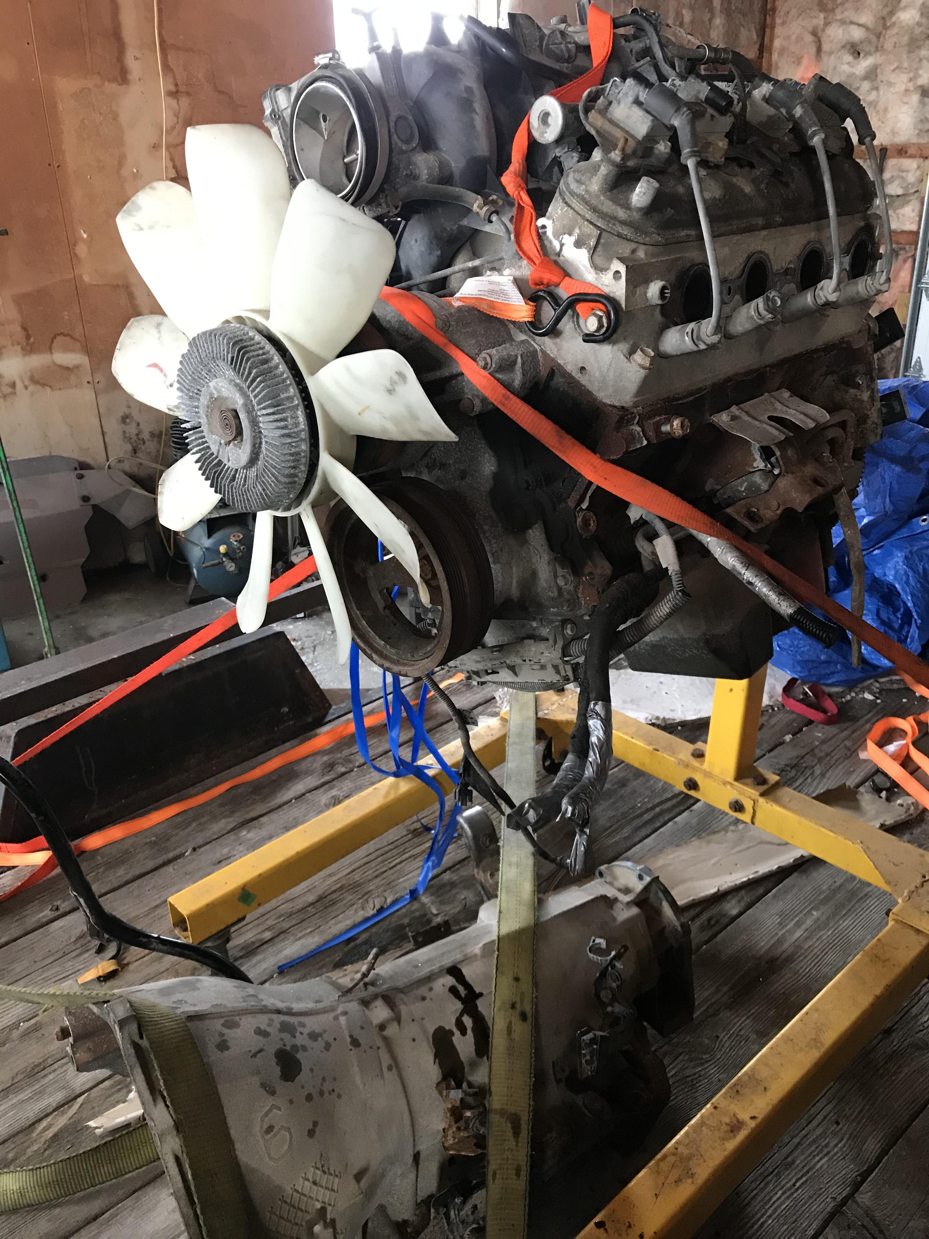

brought the replacement motor/trans home a few days ago. Noticed a few things after finally getting a good look, 6.0 came with oem oil cooler? I see the lines coming from atop the filter housing but what cooler was used? When ready can I swap over my true cool trans cooler then use the oem trans cooler for oil?
My 4l80e is not stamped “4L80e” like many I’ve seen in the past I’m guessing it’s based on production years?? And anyone looking to build one on the cheap I found govplanet.com has a 4L80e from a Humvee up for grabs for $5.00, looks like it’s got all the pieces and was or is stripped down but I’d think an easy way to build a cheap trans if it’s only $5.00.
And yesterday I finally got in touch with local engine builder (recently moved/bought house in new area) who was an excelllent contact to make. Will hopefully getting to their shop soon with heads looks like 317 milled (correct my number if I’m wrong) 0.003 or is it 0.030 down to change the compression ration and still be safe with oem pistons. I’ll stop in to speak directly with them about cam choices based on on some parts I already have. It seems all the big guys suggest this to have a 216/220 cam I have in hand 218/221 but it seems to have a very short curve. The shop owner said he will need a bit more info an we can decide.

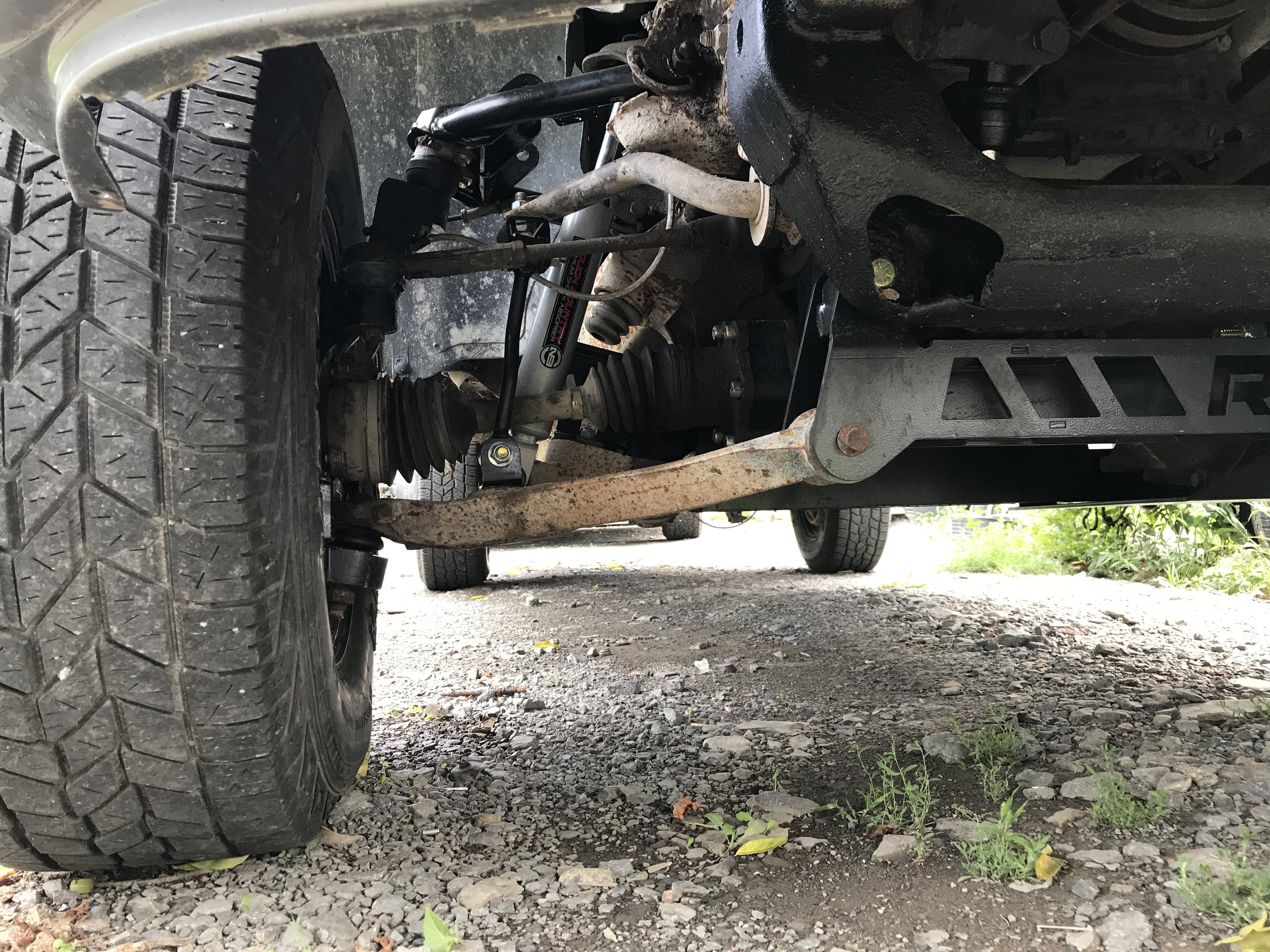

front suspension for now congito UCA with RC 4” lift. Feels actually pretty decent the shocks need to go RC isn’t a nice shock at all. (2006)

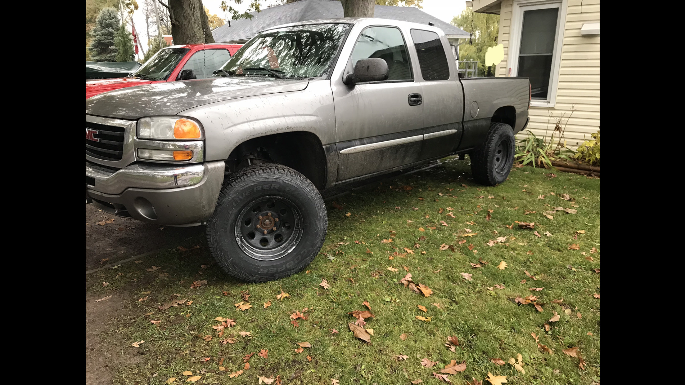

she ain’t pretty, she just looks that way. Has served its time very well and hope one day it can be used in another project. Or sold (2003)
