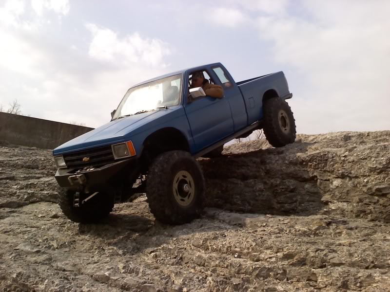

I am a noob here, and thought I would post up some pics of my s10s...Both of them are newly finished projects. The gray/red one is my street queen with a 5.3l/4l60e. The blue one is a little more purpose built with a 350 on pane, sm465, and 205 feeding one ton axles and 38" tires. Both of these trucks provide some good entertainment, and continue putting a smile on my face every time I mash the skinny...

Yeah you do...they are nice to fit on the trail beeing narrower than a fullsize. If you build one you may want a short wheelbase though...I am currently building a steering 9" for the rear of that blue truck to let us navigate through the trees a little better.

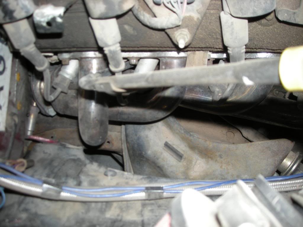

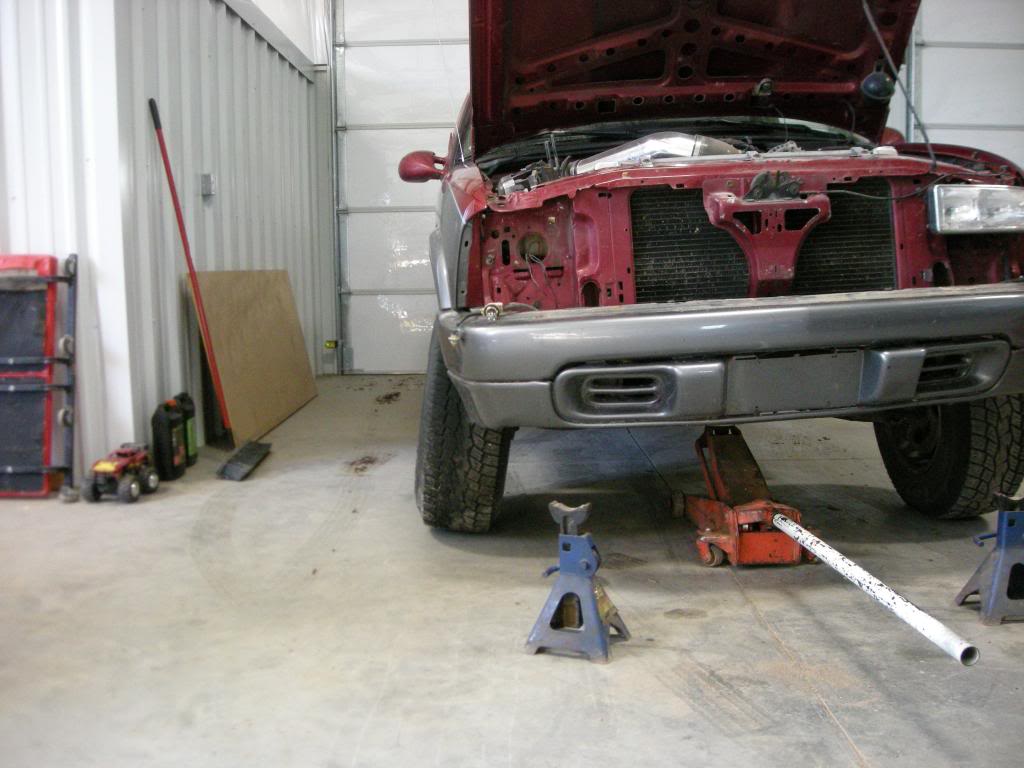

I had an interesting experience while driving the s10 the other day. I was on a smooth rock road slowing down to turn into the shop when I hear a loud bang. The truck immediately viers left hard and the engine dies. With no power steering I struggled to keep it on the road, but did manage to steer it into the yard by the shop as it coasted to a stop. Upon inspection, it looked like the upper control arm bolt on the back side of the passenger upper a arm either sheered off or came completely loose and fell out. This allowed the arm to rotate around and get into the wiring that goes to the starter. Actually it broke all the posts off of the starter and shorted out the wiring. The positive battery cable melted out of the battery...never saw that before. I have it all torn down now, and I haven't had a chance to try to get it restarted yet. I plan on picking up a new battery today. I had a spare starter that I put on already. Hopefully it only fried the battery and starter, but who knows...I have some pics on my camera. I will try to remember to pick it up at lunch.

I got the electrical system repaired last night, and it started and ran good. That was a relief! Now I need to round up the suspension parts and throw the front end back together. I did find while taking the front end apart that one of the bolts holding the upper control arm on sheared off. That is what started the chain reaction of bad stuff to follow...
Here are some pics of what it looked like after.
