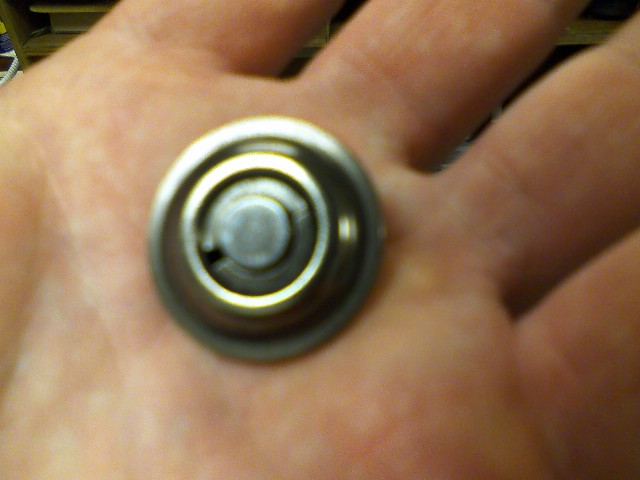

here is a pic of the top of the retainer/lock with the stem still attached.
Can I see the bottom side.

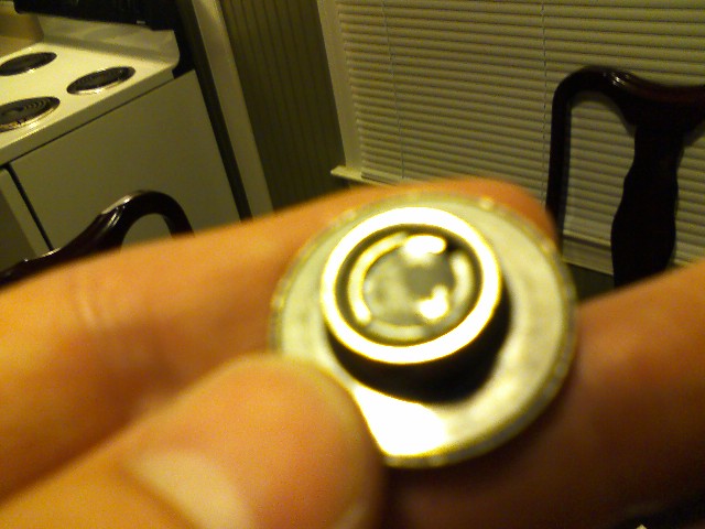

will get that pic up in the morning. i didnt take one of that, but you could see shiny spots and dull spots where the break occured, as if it wasnt a good pour on the casting or something...
i will post a pic up in the am though for sure.
Looks like someone was right.... (see post 12)
Sucks to hear about... That cam wasn't too big and with stock springs I could see why it could be warranty..
so bigger and better?
Valve float can cause a valve stem to break up by the locks. The valve doesn't have to hit the piston. Ls6 springs are light PSI and designed to control the light LS6 valves, on the ls6 ramp not the heavy truck valves with the comp ramp. Chances are the valve was bouncing on the seat.

here is the underside of it.
