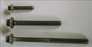

Originally Posted by peterls1
Well I have the long arp bolts and when I lay a head on the block and put in the bolt it literally goes an inch and gets tight with about 4 or 5 inches to go before it ever sinks the while way so I assume I'm needing the shorties..........?
Yes you have the 99-03 style bolts you need the 04 up bolts.
Off the top of my head I believe the early bolts were around 6-7 inches long and the later 04 up bolts were around 3 inches long.
I could only find a picture of the 99-03 all side by side. The middle bolt in the picture is the about the same length as all the 04 up bolts. On the 99-03 it only used the shorter M10 middle bolt on the out side of the midle row of bolts.
in 04 they used the shorter style bolts on all the M10
