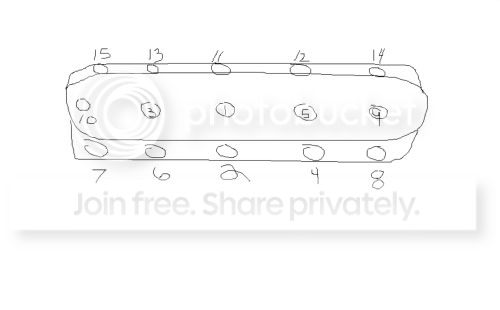

step one
all 11mm bolts 22ftlbs
step two
all 11mm bolts turn an additional 90 degrees
step three
turn bolts 1-8 an additional 90 degrees
turn bolts 9 and 10 an additional 50 degrees
step four
all 8mm bolts 22 ftlbs
you know the bolt sequence right?
i had to draw it so don't laugh

Originally Posted by goshawk23
step one
step two
step three
step four
Acuatlly is it the same as on old schol motors, what about the lil ones along the top..
hey thanks you tha man
Old Aug 4, 2006 | 06:53 PM
goshawk23's Avatar
Truck addict
Joined: Apr 2003
Posts: 6,559
From: Ocean Springs, MS
check the update
