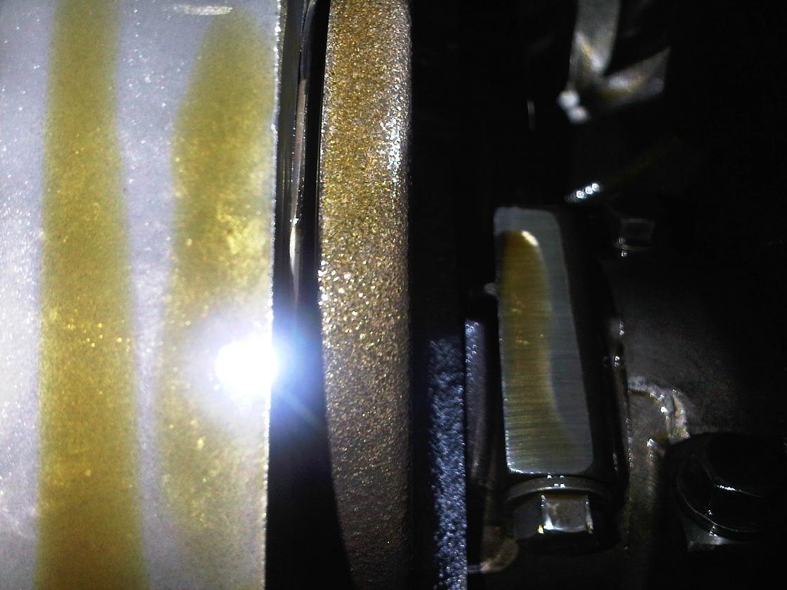

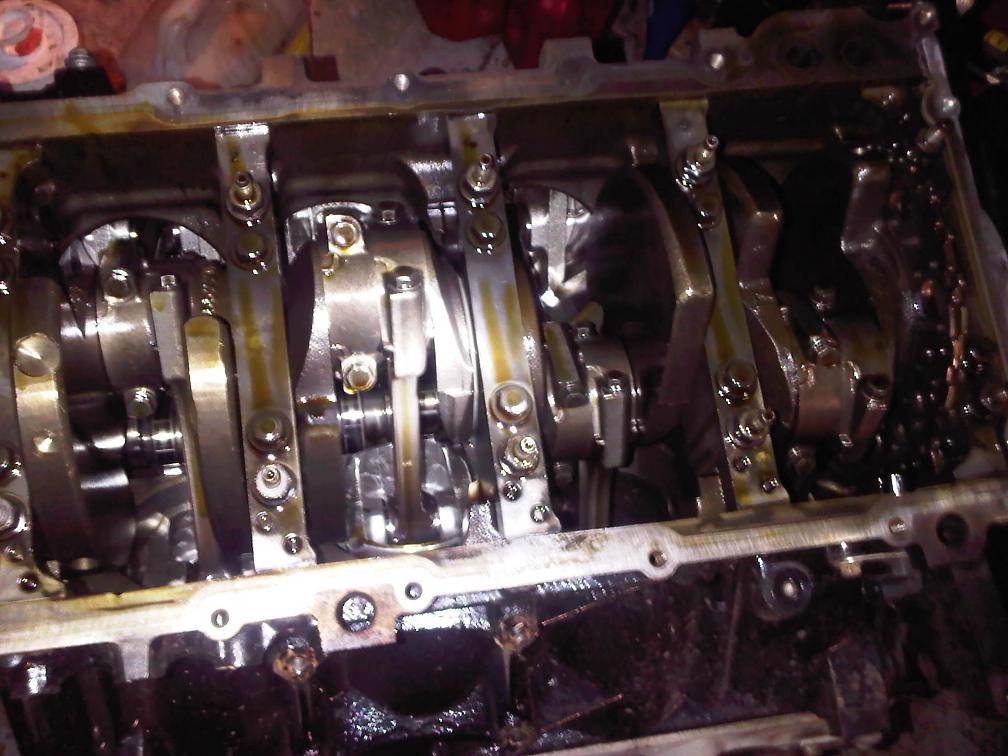

Dont have a good way to measure the play at the house. Got the pan off tonight and got a look it it. The rear of the bearing seems to be where it was rubbing, the front counterweight rubbed the front maincap some.

I just had a lq4 do the same thing, were you getting crazy amounts of timing pulled out? my truck never made any noise, just was sluggish from the timing being pulled but it rubbed the block a good amount.

I still have the motor and it is still usable just needs a new crank, but i would not trust it to hold boost. Im going to just get a junk yard 5.3 now.
Are you going to pull your crank soon? I bet it rubbed a little more inside the motor then you can see right now.
good luck man, its really disappointing when this stuff happens, but its a big relief to find the problem.

I didnt see very much damage but the crank is still in. Im gonna take it to the machine shop early next week and let them look at it(they built it) and if its still ok throw all new bearing on the rods, mains, and of coarse thrust. Fingers crossed!
