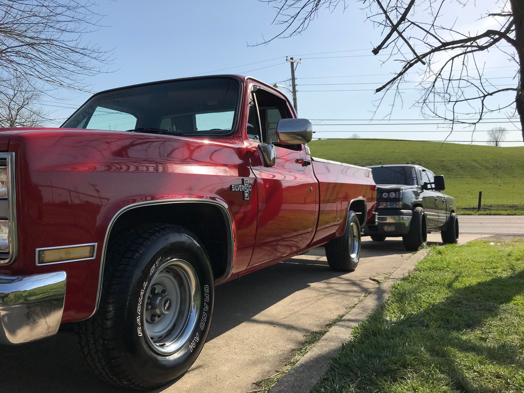

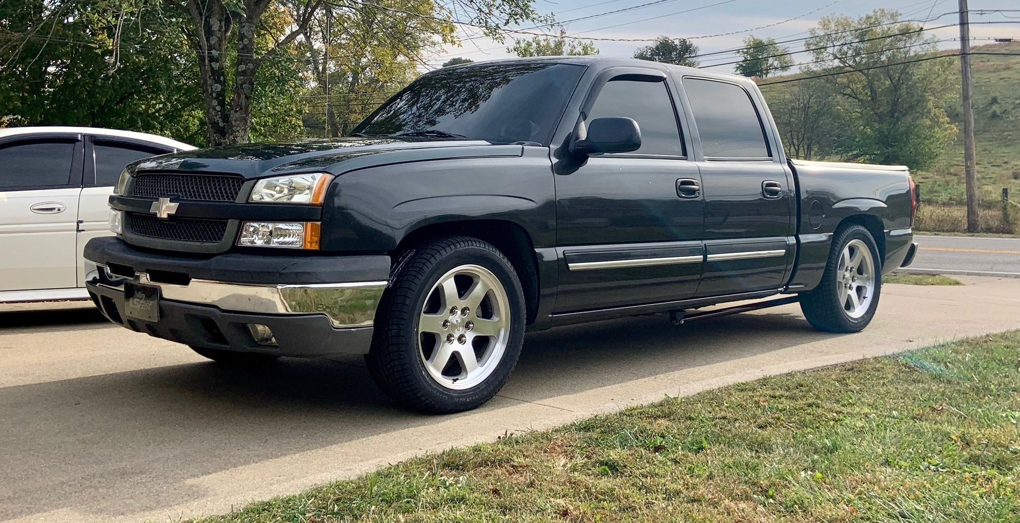

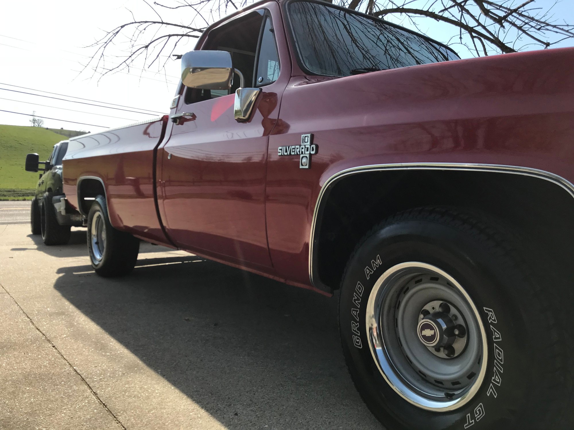

Here’s pictures of the square body. 34k on it when I got it from my dad and has 38ish now I believe. Grey truck is the one I’m going to cam now. Has a few small things already in anticipation for a cam
