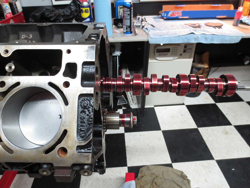

It's a great all around camshaft. I ran one for eight thousand miles and had no complaints except for the sewing machine noise. 99% sure it was the cheap $100 Delphi bulk LS7 lifters. Running Morel 6504 lifters now with zero noise on a TSP grind.
Sloppy all assembly lubed up. Knew the engine would sit for a few months so I wanted a good film...
Aint it purdy though
