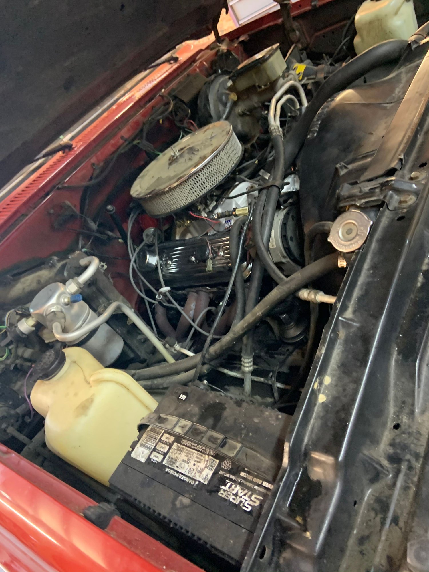

It isn’t letting me upload a video for some reason, but here’s some pictures. Started right up but the vacuum advance wasn’t working on my distributor so I ordered a new one. Unfortunately the fed ex guy played foot ball with it, but summit wasn’t quick to send another and just stabbed it in and about to set timing correctly finally. As for the cam for the other truck, Iv been looking at a 228/230 112 lsa from trick flow
