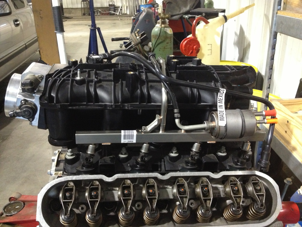

So I just got my vette filter in for my tbss intake swap and I notice the stock tbss fuel line does not match up. What can I use without kinking the line to bend it so it fits right?

I did this:

Nice idea! But would I be all set to pull it up without kinking the line

isn't the fuel rail supposed to go the other direction?
Yes but it flipped it to make room from the vette fuel filter.

I haven't event took measurements does the filter hit the fire wall?

I used vette fuel filter on mine. My fuel lines are hitting the firewall. I need to do something like above

Do they hit bad? Can you just make a small dent and be all set?

What year vette filter is that also what do u do about the old regulator on the old fuel rail?

yes they hit bad. im not sure if you could use a hammer to clearance the firewall enough....
here is the pn for the vette filter/ regulator
http://www.summitracing.com/parts/wi...FQdk7Aod9AMA0g
