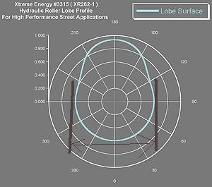

Beau... I Believe Your Measurement Is Off.... If You Look At The Circle Taht The Cams Closed Surface Runs On.... Thats Your Base Circle.
If You Look Where It Passes The Apex Of Your Lobe Opening....
It Is Below .600 Looks Like Its About .550-.575 On The Graph Which When You Take That X2 It Comes To 1.1 Or 1.15 " I Would Call Comp To Make Sure But 1.4 Is Definitely Not Correct... Unless Of Course Taht Pic You Have Is Not Of Your Cam
Gimme Your Cam Number If It Is Off Teh Shelf... I Can Probably Figure It Out...... If It Is A Custom Grind You Will Have To Call Them
