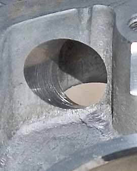

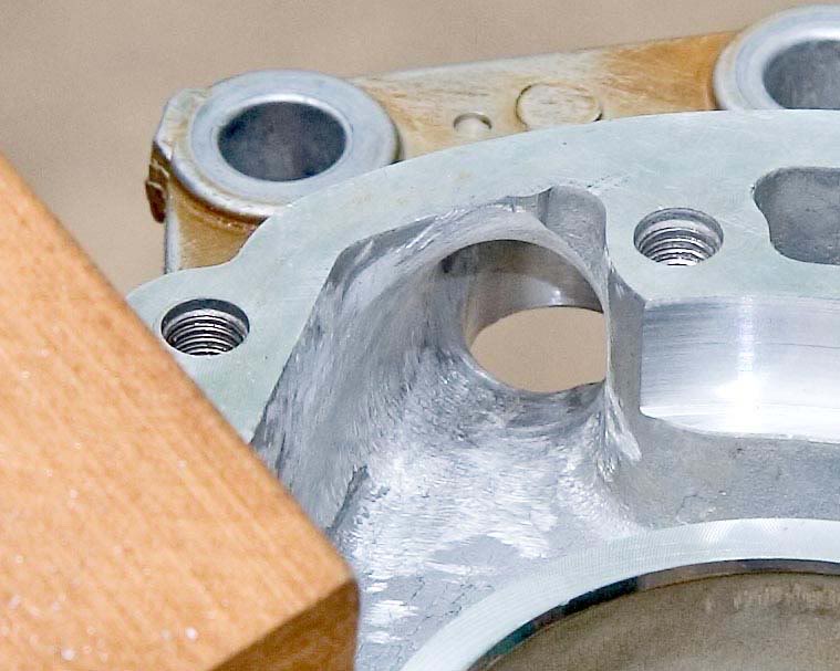

I posted some information on this topic a couple of times on LS1tech.com. I have tried to post a link to those posts, but search doesn't work so I can't find them. Here's a quick before and after picture of some of what you are trying to do.
Before
After
You are trying to reduce the resistance to flow on the inlet and outlet sides of the pump which will increase the flow rate. I didn't change the spring tension on the pressure regulator at all. I just disassembled, inspected, ported, cleaned and reassembled everything. I hope that this helps.
