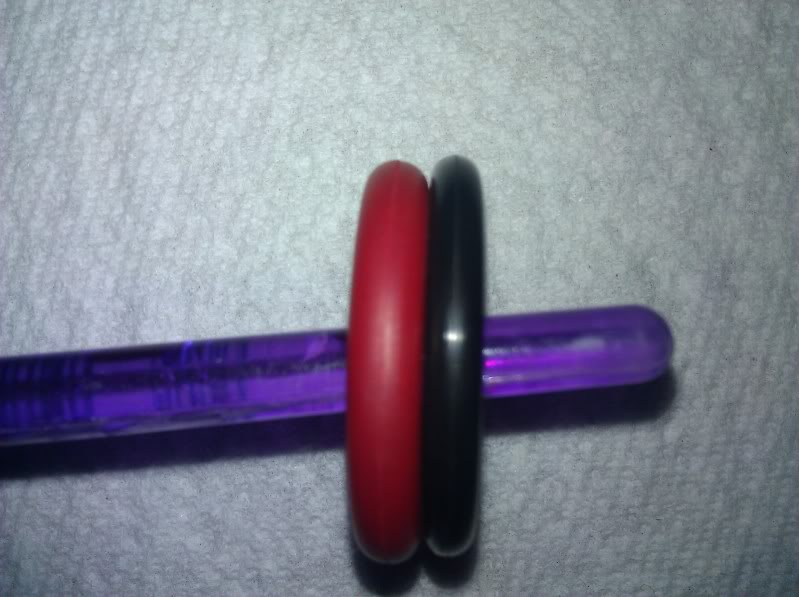

i think we found the problem guys. after cranking the truck and it only making 20 psi on the oil guage i said **** it and pulled the front cover back off to find this.Name:  frontgalleyplug.jpg
now this is my first swap so i had no idea to check this when i had it off the first time. but after not getting full pressure i was thinking it was the pump until i found this. is this called a welch plug? any body have a part number for the 06 lq9? and do they just push in or how do i install it?
and i also took a pic of the two different orings so you guys can see the difference.
i do not advise anybody to go to Pavlock performance if they want an engine overhauled. wrong oring, maybe let that pass, wrong oring and no galley plug= wtf
