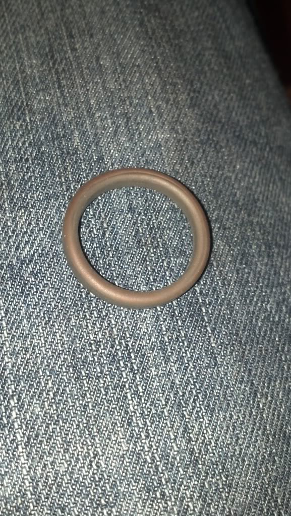

Putting the timing chain on the 6.0, and noticed my pickup tube fit a little loose. It has room to wiggle the tube without the retainer tight. I've re installed the tube multiple times. Here's a pic of the o ring.

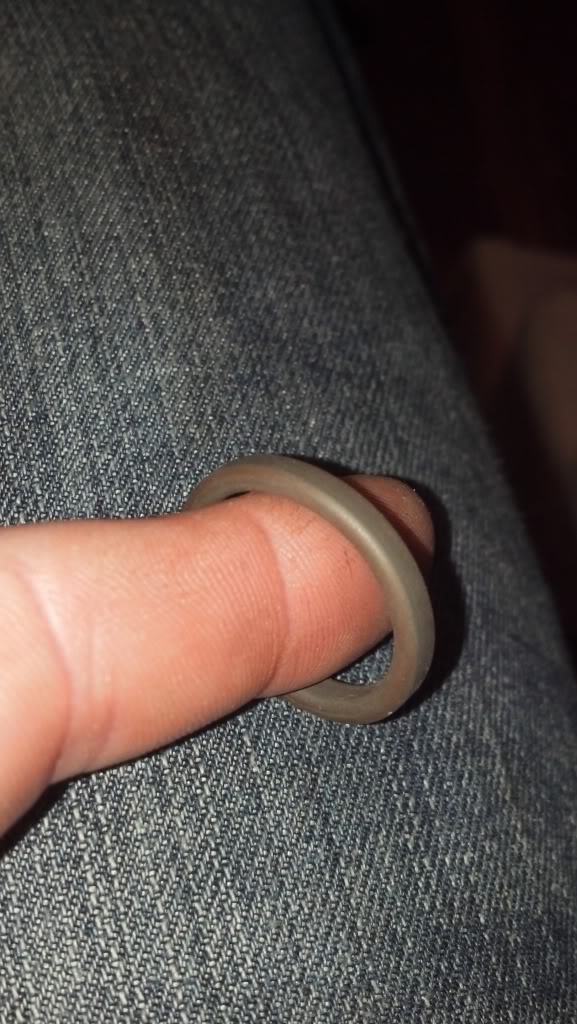

Notice the flat edges on the outside and inside. Is this normal? Other than that the o ring looks great.
Could just a similar size o ring work? I'm worried after reading people having problems with these.

Get a new one. Get it from the dealer only.

Are these made with a flat sides on them?
Old Jan 13, 2013 | 04:21 PM
AKlowriderZ71's Avatar
11 Second Hall Moniter
Joined: May 2008
Posts: 11,651
Likes: 10
From: Wyoming
Nope.

Mine was flattened too and would not seal up again. There's a fatter revised one for the trucks. I forgot what color, but the dealer should know exactly what you need.

ALWAYS replace the o-ring. If the sides are flat that's a good indication that it will not seal well anymore.
