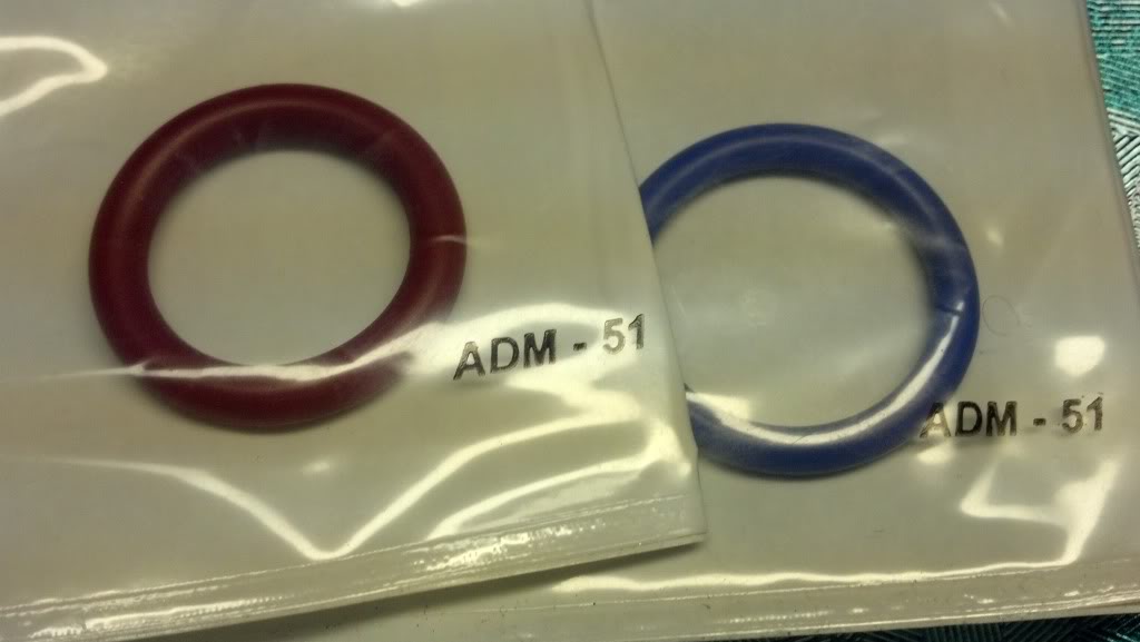

I grabbed both o rings because I wasn't sure what revision I needed. Should i use the blue or red. Its a iron headed 2000 6.0. What's the best way to install these without pinching them? Put it on the pickup tube first?
Old Jan 16, 2013 | 11:49 PM
oakley6575's Avatar
Joined: Dec 2010
Posts: 5,235
From: Las Vegas, NV
Most likely it is the red one. Does the pick up tube have the recessed indentation where the o ring goes?
Old Jan 17, 2013 | 12:41 AM
kelsey_canard's Avatar
Joined: Nov 2010
Posts: 959
From: Arkansas
Originally Posted by slowswb
well it depends on what year the 6.0 is because it could use the blue or red. Earlier 6.0 used the blue.
Just installed the o ring. The blue seemed to fit the best. To oakley: The pickup tube did not have a spot recessed for the o ring. I guess we will find out when the motor is installed. The dealership did not keep these on hand. Kind of surpirsed me that they did not keep these in stock. Dealerships ftl
