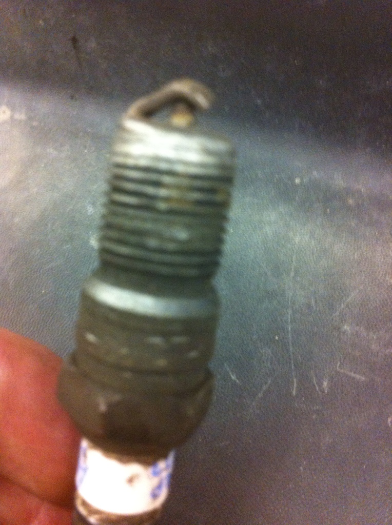

Ruh-Roh!!
Crappy bore-scope vid.

Originally Posted by TIM Z
Lucky you got the plug out .
Actually, the plug was forced out of the head by the broken piston pieces, the coil also broke and pushed out of the hole. The cylinder head threads for the spark plug are gone.
These Fords are common to see with blown out spark plugs. We use the TIME-SERT system to repair the head. This truck was towed in to have a TIME-SERT installed, but his problems are a little worse than that.
