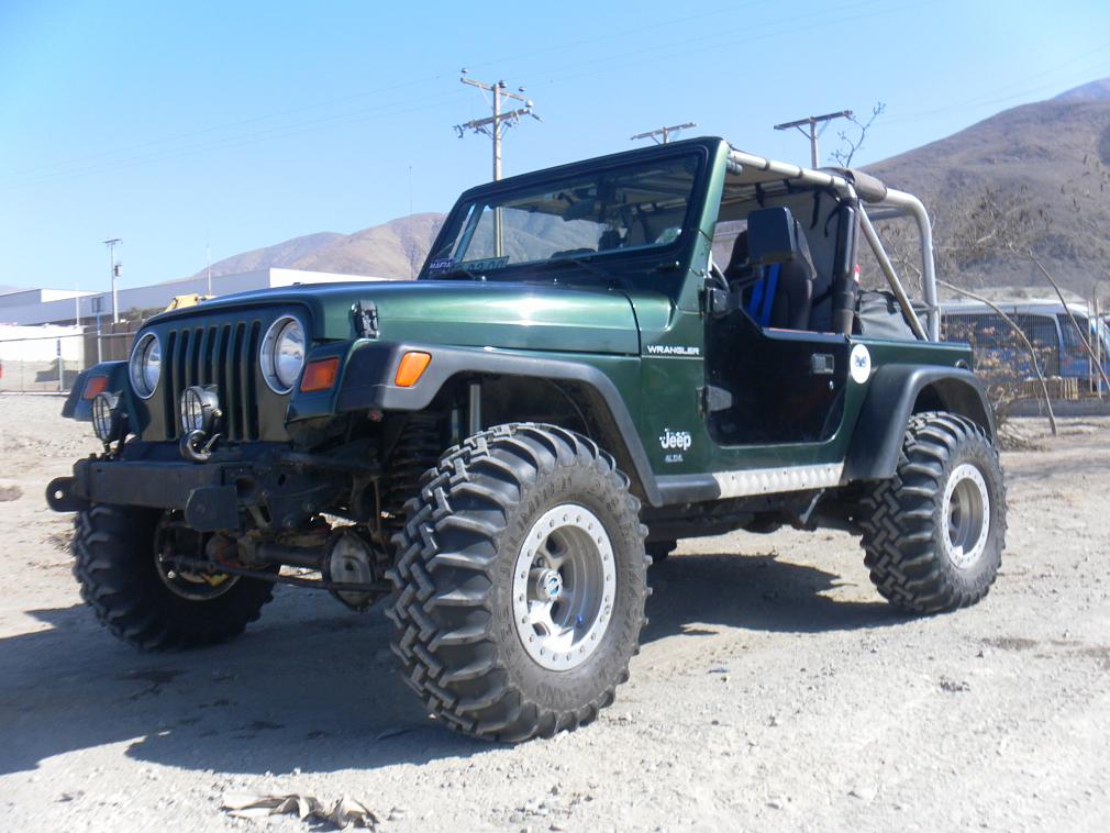

Hi, please your opinion about my new LY6 Stroker
My current set up consist of:
6.0 LY6 - LS3 CNC heads, Arp Studs (Bottom stock)
Comp Cams 156-403 222/236 114LSA
T56 tranny + D20 Transfer Case
D44 Front - F9 Rear
340 Aeromotive in tank & 30# injectors
4.11 Gears - Detroit rear locker
Wrangler TJ 1999
If I go 402 I will
TSP 402 C.I.D. LY6 Rotating Assembly with optional Lunati forged crankshaft and connecting rod
LS3 CNC heads (pushrod, valve and springs stock)
Wiseco pistons -20cc dish
Manley Pro-Flo Oil Pumps
340 Aeromotive in tank & 72# injectors
RC 9,25:1
HpTuner tune in home
Regards
