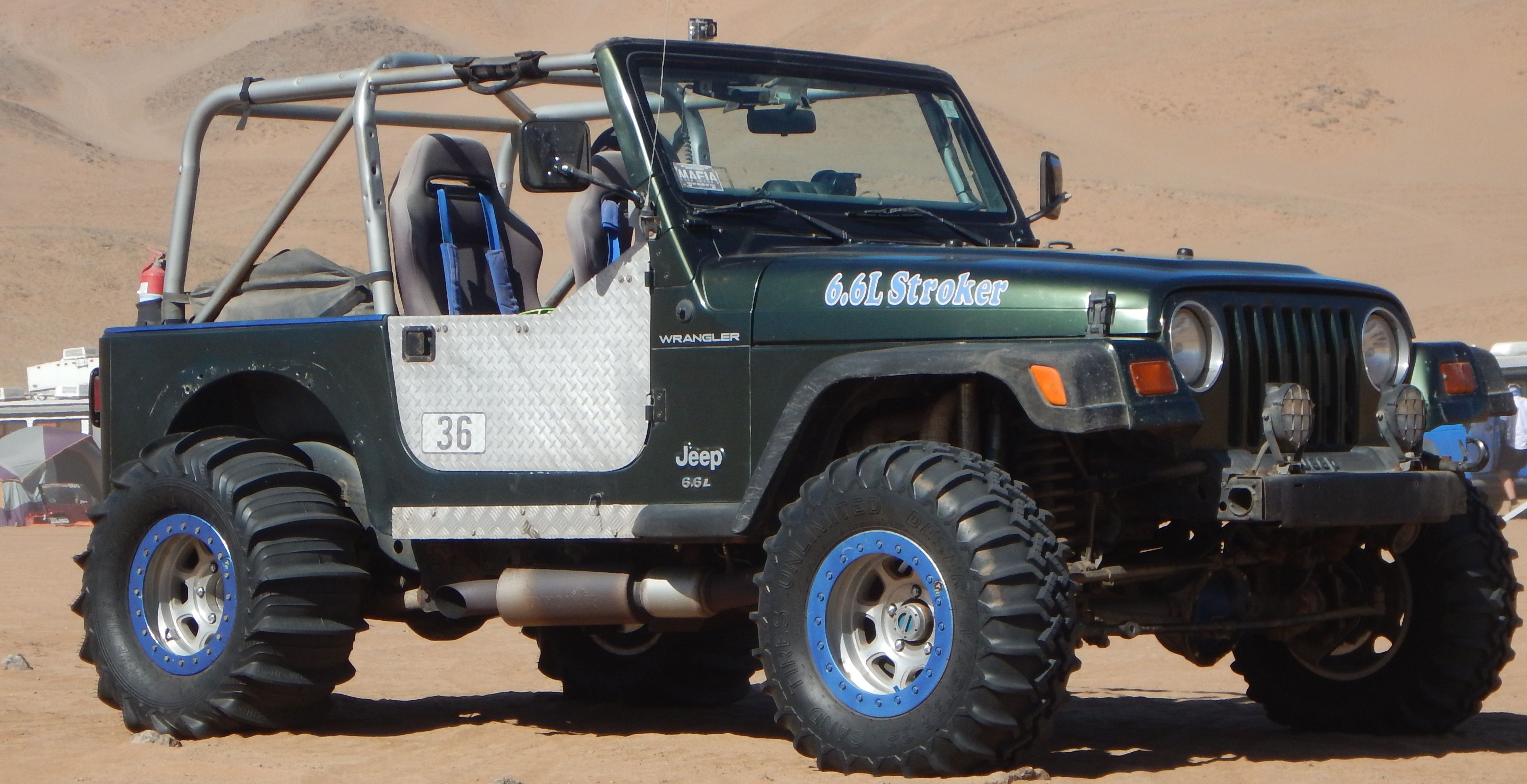

Pretty good the last 2 years. I just change transfer case NP241C instead D20, 42# inj and also a lot tuning with HPT.
BUT, I need more powerˇˇ, so I´ve been thinking in 102 Intake/TB.
I like FAST LSXRT 102mm but I have serius doubt with that Throttle Boby. Mine is LY6 with TB by wire.
I believe NW fab only by cable, that is correct?.
I accept any recomendations
Regards
Raul

What cam are you using? It sounds like you live at 6000+rpm most of the time so you can get away with a pretty big cam up there.

Comp Cams 156-403 222/236 114LSA
Average climb up 6000rpm with Cut off at 6600rpm
3 or 4 gear depend inclination of dunes

Yea you could easily add 10-15 degrees of duration to that and let it sit at 6500 and pick up some power. The aftermarket intake will also help there, and 2" headers wouldnt hurt either.

I run Desert Trophy Championship in Copiapo City(3 times in the year), Chile. Where in some climb up are different, You have to run beetwen 3000-6000rpm, that´s why I chose this cam.
