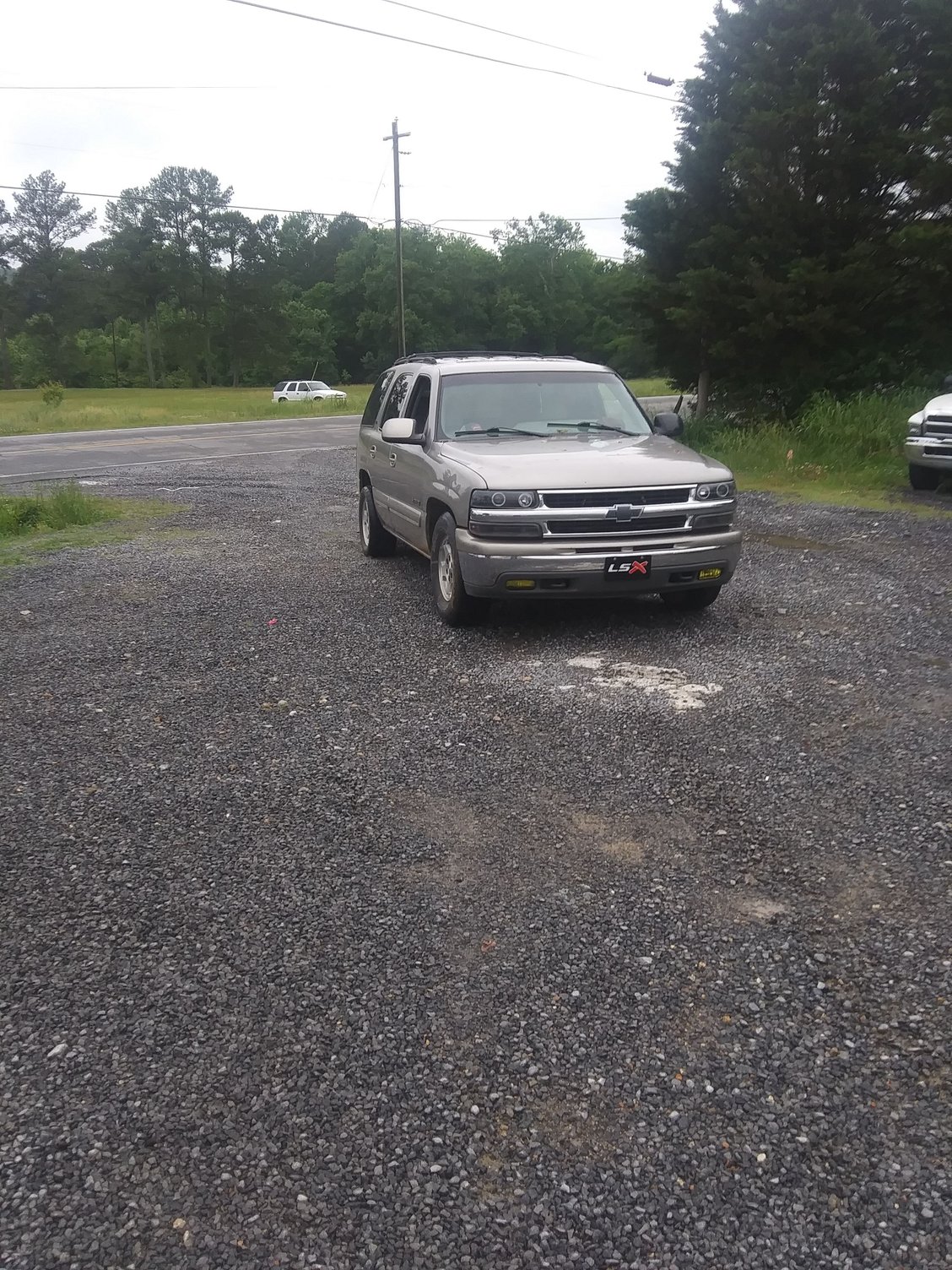

Im runnin 4.8s with shaved 243's and ls6 springs , tsp cam and full bolt ons ,efans, hp tuned. When im on it my duty cycle is high hits 90+ real quick. I heard the stock can support over 400
Haven't been to a dyno but my *** dyno guesses 330 wheel. 4.11 detroit locker and 26.4 inch tires i hit 100 real quick
Front tires coming this week...im not squating on purpose.
